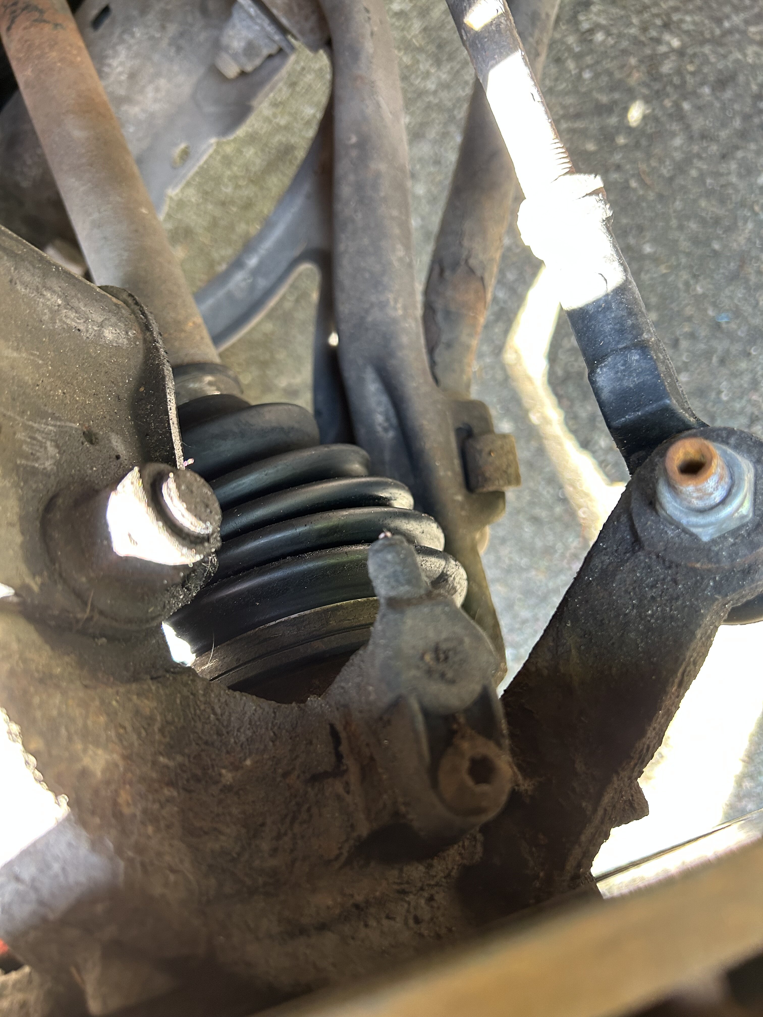

Jamess182
So yeah that might be the problem :ROFLMAO: 🤦‍♂️
Odd how it didn't throw any codes up, nor really affect the brakes.
Easy fix though thankfully.
