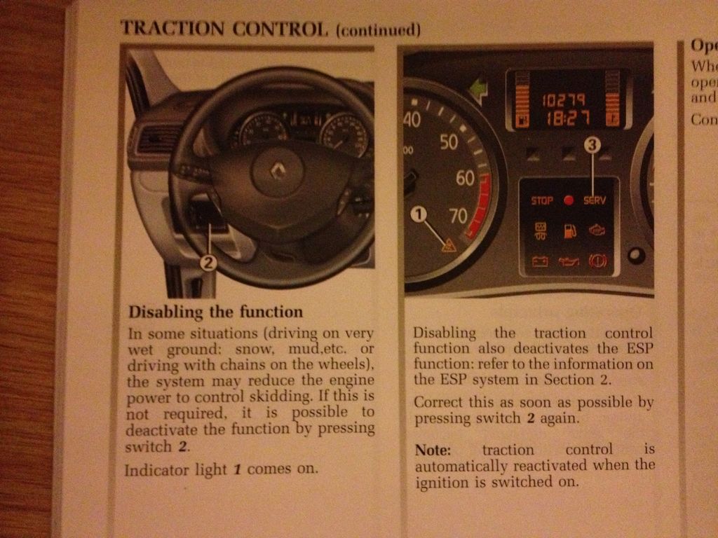

Page 2.16 of the owners manual

lol at this thread, what a plonker, how could anyone possibly think ESP was off as standard and had to be switched on.
