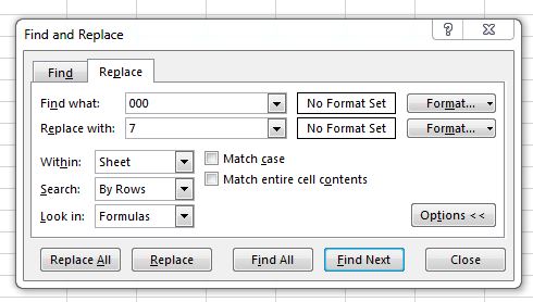

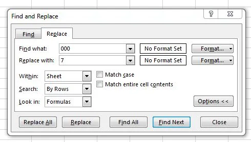

Right then bunch. New issue.
I have 2 Spreadsheets and the 2nd is used to read certain info from the first.
Now - I have a row being read from say B to Z.
What I am doing, is on the 2nd spreadsheet highlighting all the cells and mass formula changing the row selected in "Replace". This is very simple.
Is there a way to enter the row number I require into a cell, the press "Submit" or similar for a macro to run and do the change? This is preferred to each time selecting all the cells and mass changing in "Replace", It would feel / look more slick.
=[Test1.xlsx]Sheet1!B000 This is the current formula in each cell on the 2nd spreadsheet. I then run...
1430024
This will then replace the "000" with the 7 - thus showing the info in Row 7 from Spreadsheet 1.

Tim.
Could you do it a different way and replace 000 with ‘&A1’.
In cell A1 you’d populate the row you want to reference I.e. 7.
Not even sure if that would work, haven’t looked at excel for two weeks.

GiT
  Shit little Yaris...
If that would work, that's all i'd need to do - would be perfect!
Oggy997
  997.1, Caddy, e208
Code:
=INDIRECT("'[Book1.xlsx]" & "Sheet1" & "'!" & "B" & I$1)
Book1.xlsx = the workbook in question
"Sheet1" = The worksheet fromt he 2nd workbook
"B" = The column you want to look up
I$1 = The cell where the row number you want is entered
*N.B. - Indirect requires the referenced workbook to be open or the formula fails.

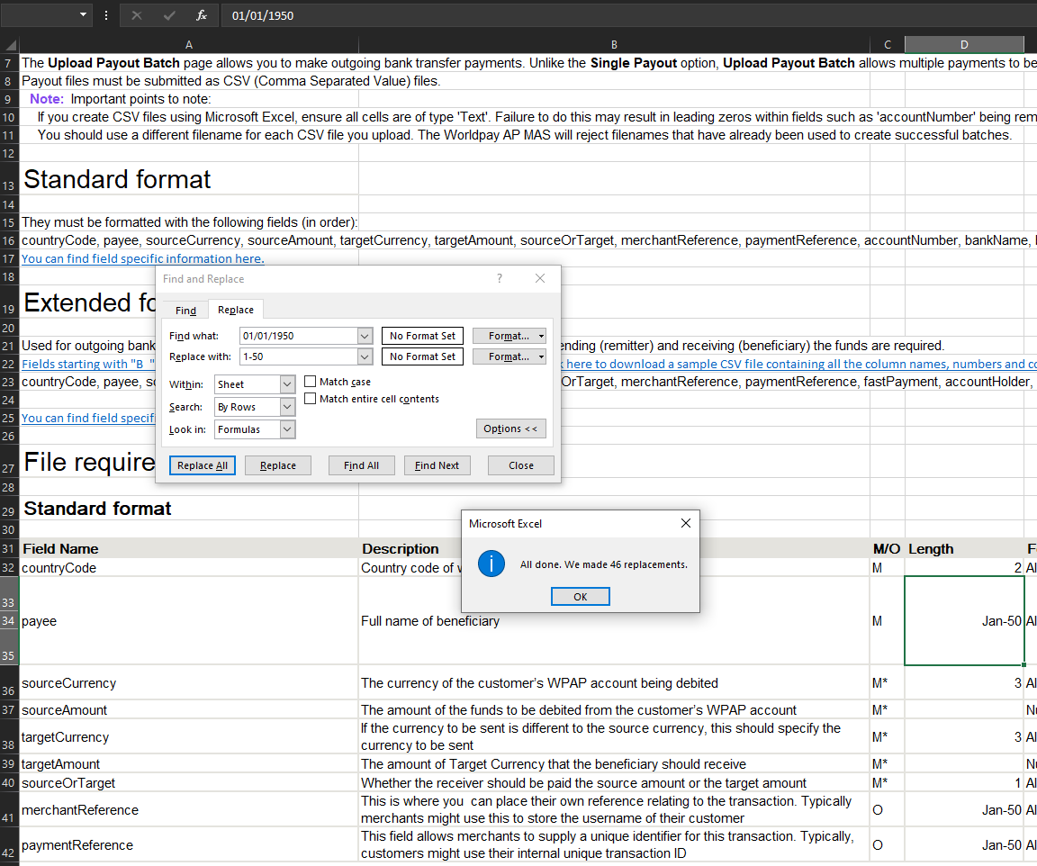

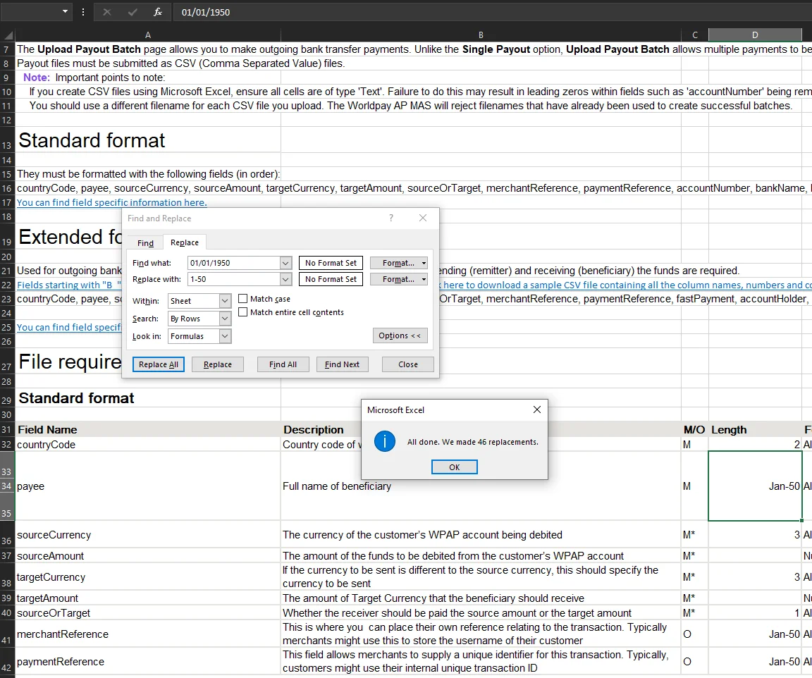

Darren S
Right - I'm clearly being stupid here!
I've found a Worldpay webpage that lists many field and format types that I'm trying to import into Excel. It imports fine, apart from a few expected formatting issues.
The obvious one comes under one where it says field length of 1-50. Excel in its infinite wisdom tries to apply this figure as a date field - so that all 46 examples of this within the newly created spreadsheet appear as Jan-50. Worse.... you click on those cells and it reads it as 01/01/1950. FFS Excel - just paste it as plain text - except plain text isn't an option. Using Paste Special, the only option that allowed an import was a Refreshable Web Query - and I suspect that this is where the spanners are getting thrown in.
That said, the output looks fine - but being Excel, it completely ignores the selection of text I've made on the webpage and decided to import the entire page itself. Great.
Anyways, I go straight to Find & Replace. Find any instance of Jan-50....... can't find any. What? Like that one immediately on Row 33 and the other 45 examples that I can see with my naked eye? Nope. OK - what about finding 01/01/1950.....46 examples reported. This is good. Replace all 01/01/1950 examples with 1-50. Excel says - Ta-da! Done it - I've made 46 replacements. Except you haven't, have you (you lying little s**t).... they are still showing Jan-50. I've tried it with both the Match Case and Match entire cell contents boxes ticked - makes no difference.
Why do I have to try and unpick Excel being clever - applying date formats when none existed before and it telling me that it's done stuff that is clear, blatant lies. So close to just manually typing them in - 46 cells by hand will be much quicker than getting my head around Excel logic.
Darren S
Thanks for that, but it won't find any instance of 18264. It does mention that I might be trying to do this on a Protected Sheet, but I'm pretty sure it isn't.
I was just after transferring the table contents from the link below into Excel.
