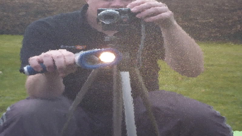

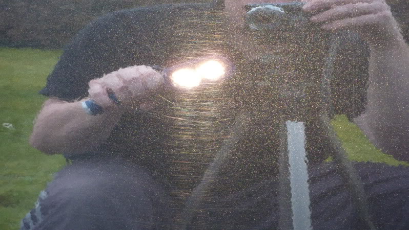

Dodo Juice's Lime Prime: One of the original cleansers out there. Contains micro abrasives that work very well by machine, on softer/medium paint work it can offer a decent level of protection with oils filling in any deeper RDS.
http://www.cleanyourcar.co.uk/wax/dodo-juice/dodo-juice-lime-prime/prod_441.html
Dodo Juice Lime Prime is a pre-wax cleanser formulated to clean, polish and prepare the paint surface ready for a layer of carnauba wax.
It contains a mixture of micro-abrasives, cleaning agents and oils to remove paint oxidisation, ingrained dirt and light swirlmarks.
Its oil contents makes the surface glossy and smooth, helping subsequent wax application.
It's a very good cleanser, i've used it for a few years now and at one point I was using it solely in enhancement details usually with a nice 3M Yellow pad. Works fantastically well. I know Russ (RussZS) used to use it on nearly every detail in his early days and I learned from his threads how to use it.
Some pictures of Lime Prime in action...
Now the downsides. After having some issues with LP under Zymol Glasur I was made aware of the oils in the product and it turns out it can lead to some bonding issues, not in all cases of course and it seems to work perfect with any Dodo waxes i've tried.
So if i'm ever using LP over Rejuvenate it would be using it as a polish so I would cleanse afterwards to give the best base.
Application by machine or hand, very easy to use but again can leave oils behind unlike squeeky clean finishes of other cleansers.
