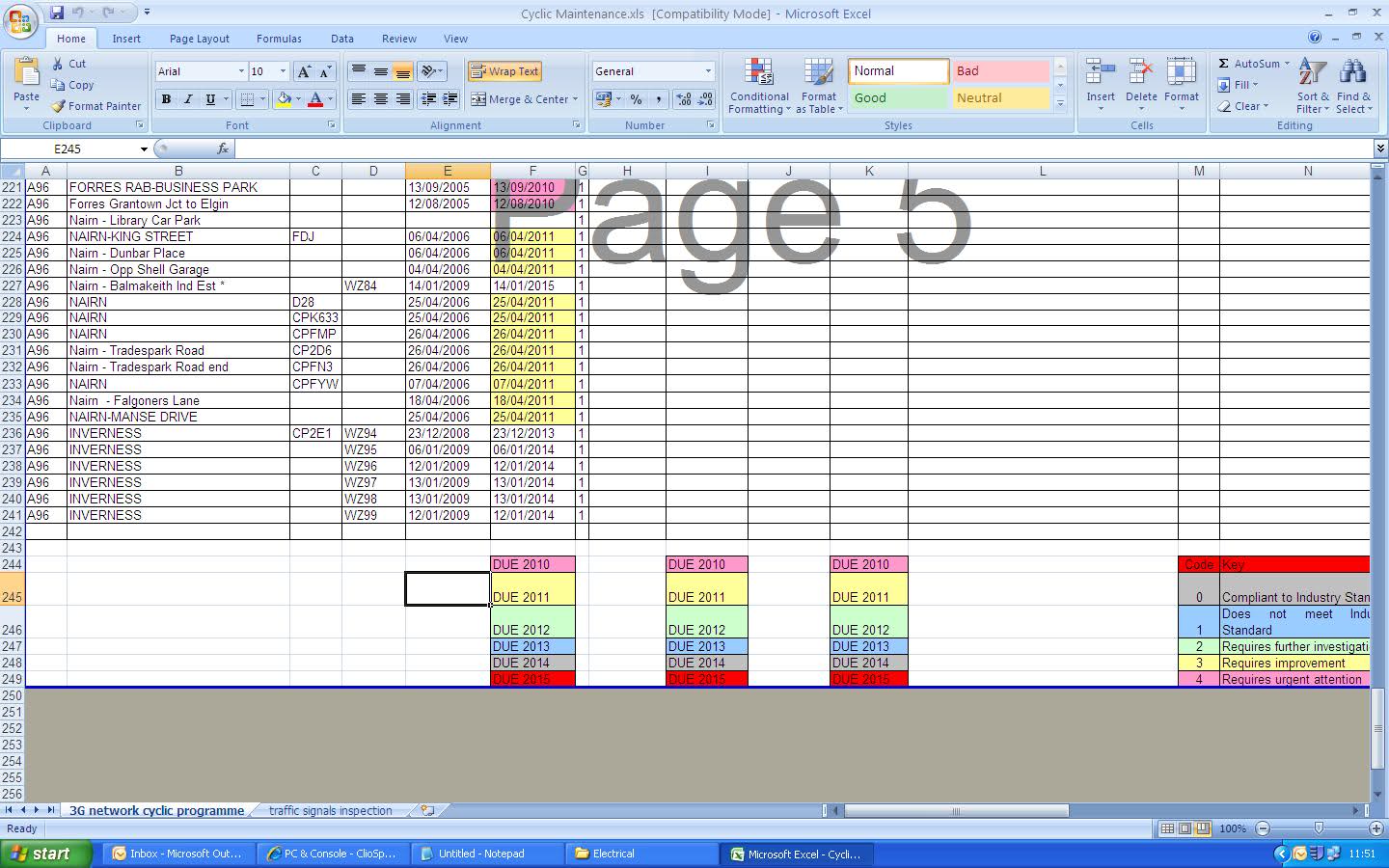

Ok, been asked by a user if he can get a formula to add up all the 1's next to a specific date and put the number beside the specific date at the bottom. I have no idea as Excel is my absolute weak spot when it comes to support. Any help would be greatly appreciated. Thanks.

That seems about right Sarah. How do I get it to add 1 when it comes across a 2011 though?
Rage = F1:F241
Criteria = 2011
Sum_Range = blank

What I did was use the YEAR command to change the 1's to an actual year, then use the COUNTIF command to add whatever year it was up into the box next to the date at the bottom.
