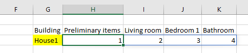

You mean you want to lookup the values from 'base rates' sheet, and return them to 'scope'
To do that you need a value to lookup against, call it "Building" (and the building contains the rooms) - Consider using XLOOKUP, depending on your Excel version.

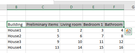

=XLOOKUP(G3,Rates!B3:B7,Rates!C3:F7)
Scope
Rates

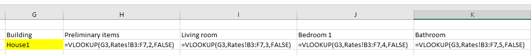

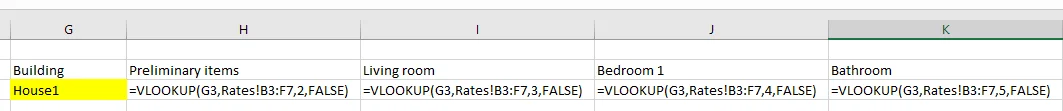

Alternatively, and more legacy, you can use VLOOKUP for the same
Code:
=VLOOKUP(lookup_value, table_array, column_index_num, [range_lookup])
Code:
=VLOOKUP(G3,Rates!B3:F7,2,FALSE)
If they're tabulated differently, change to a HLOOKUP (works the same, just the axis are reversed)

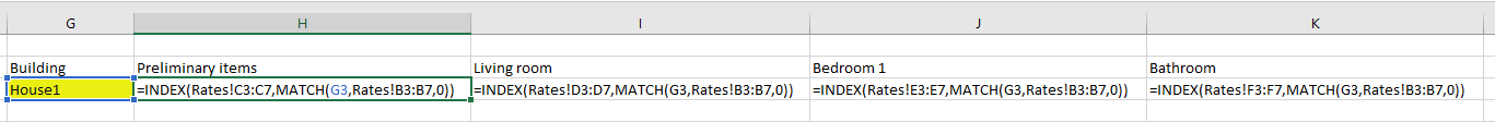

Or, to work with no indexed data, using INDEX/MATCH as a combo
Code:
=INDEX(Rates!C3:C7,MATCH(G3,Rates!B3:B7,0))
