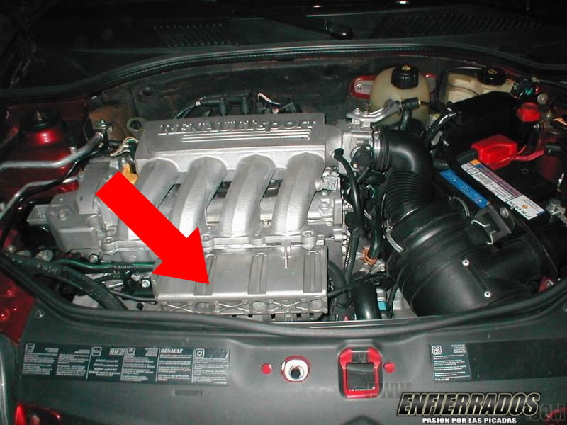

D dancook Car Clio 1.5dci Mar 7, 2010 #4 The exhaust one although after I took off the rusty bolt and replaced it - it didn't cure my rattling noise. What is the item I've highlighted in the photo? because apparently there's a nut missing and needs tightening up. Do you know what tools, nut i need? I can't see down the holes because of the angle. Attachments engine.webp 69.7 KB · Views: 141
adam172 Car CLIO PH1 172 Mar 7, 2010 #6 i also want to take my fuel raill guard off (to polish it) is it just a guard ? so a case of unbolting it and it will come straight off ?
Jonny1*2 Car Golf GTD Mk7 Mar 7, 2010 #8 two bolts, job done! Put the bolts back if you're leaving it off though. Bolts are deap in the holes in the front of it
D dancook Car Clio 1.5dci Mar 7, 2010 #9 Fred@BTM said: fuel rail guard, 10mm deep socket M6 from memory Click to expand... Thanks
adam172 Car CLIO PH1 172 Mar 7, 2010 #10 Jonny1*2 said: two bolts, job done! Put the bolts back if you're leaving it off though. Bolts are deap in the holes in the front of it Click to expand... Fred@BTM said: yup 2 x 10mm nuts Click to expand... thanks!
