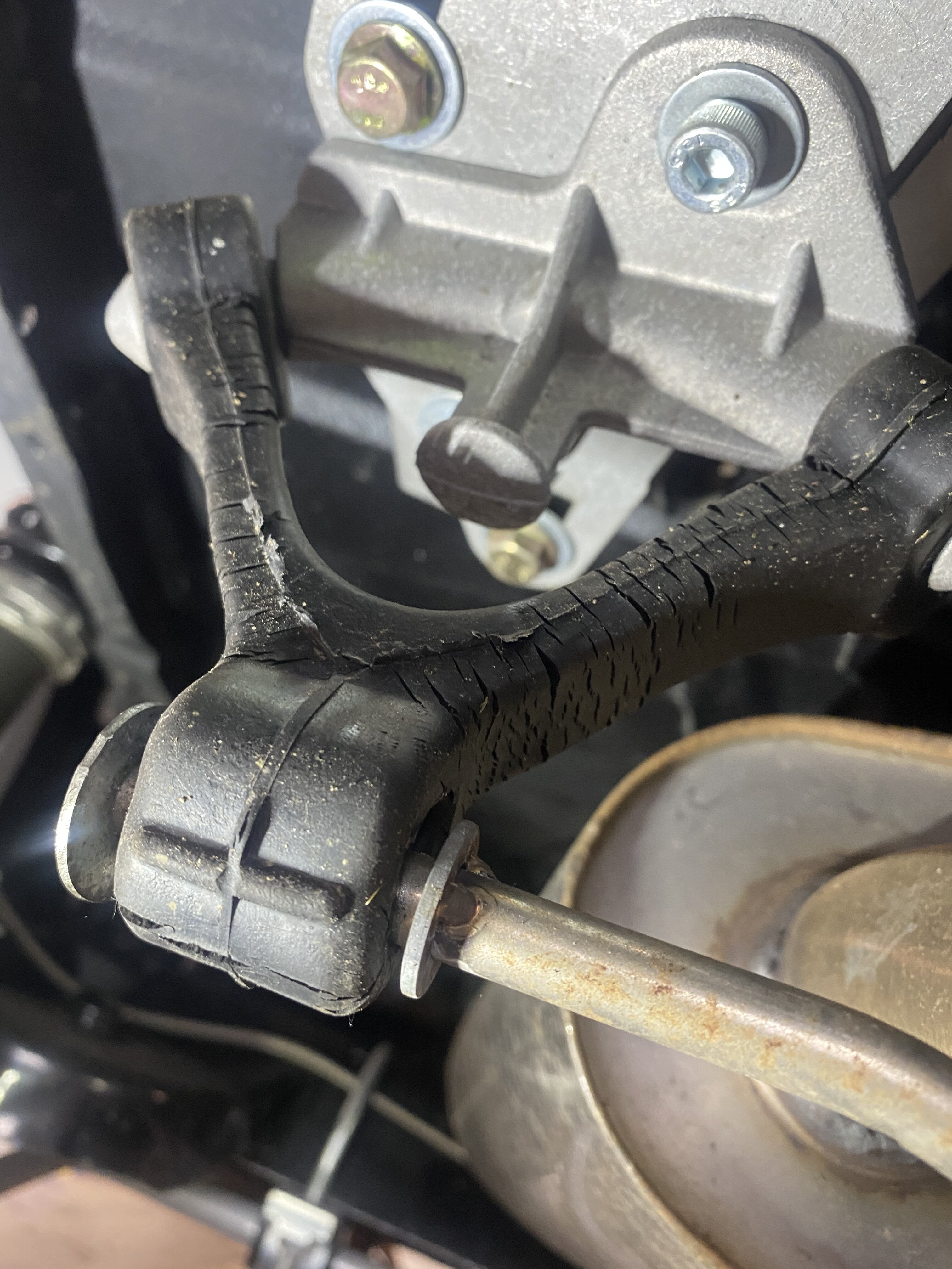

Hello,
Can someone confirm that i can still use the rear silencer mounts with the powerflex inserts with a pure motorsport exhaust?
I’ve done 2 track days and the rubbers that come with the exhaust new are on the verge of splitting 🙄 and when it gets hot the exhaust is banging around
That don't look good. I've just had 1 fitted I'll keep a eye on my rubber's
Its not ideal, Exhaust is great so have no doubts about that but i think it should probably come with some heavy duty rubbers personally, Even if it costed abit more
That’s rubbish, I hope it’s just a bad batch or you can run different mounts as that would put me right off the PMs exhaust

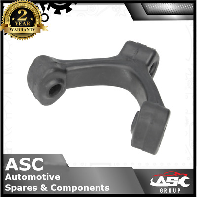

I had the same problem. Turns out Audi have changed the material they've used for the mounts. PMS only sold the entire mount and rubber so done some research and you can pick the rubbers up on eBay for £7.
Part number: 4B0253144H

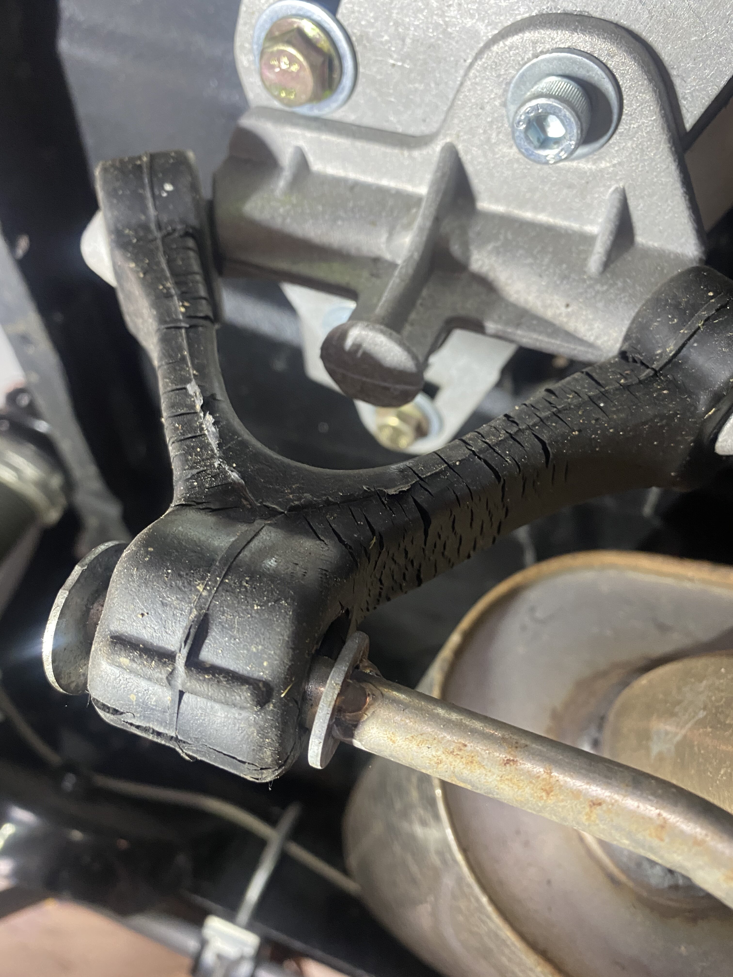

I emailed nick and he sent me out another set, He said they changed them.
The new ones he sent out and perfect they’ve done quite a few track days/races now and still solid

Glad it's all fixed. Bought mine second hand so wasn't entitled to a replacement which is fair enough.
