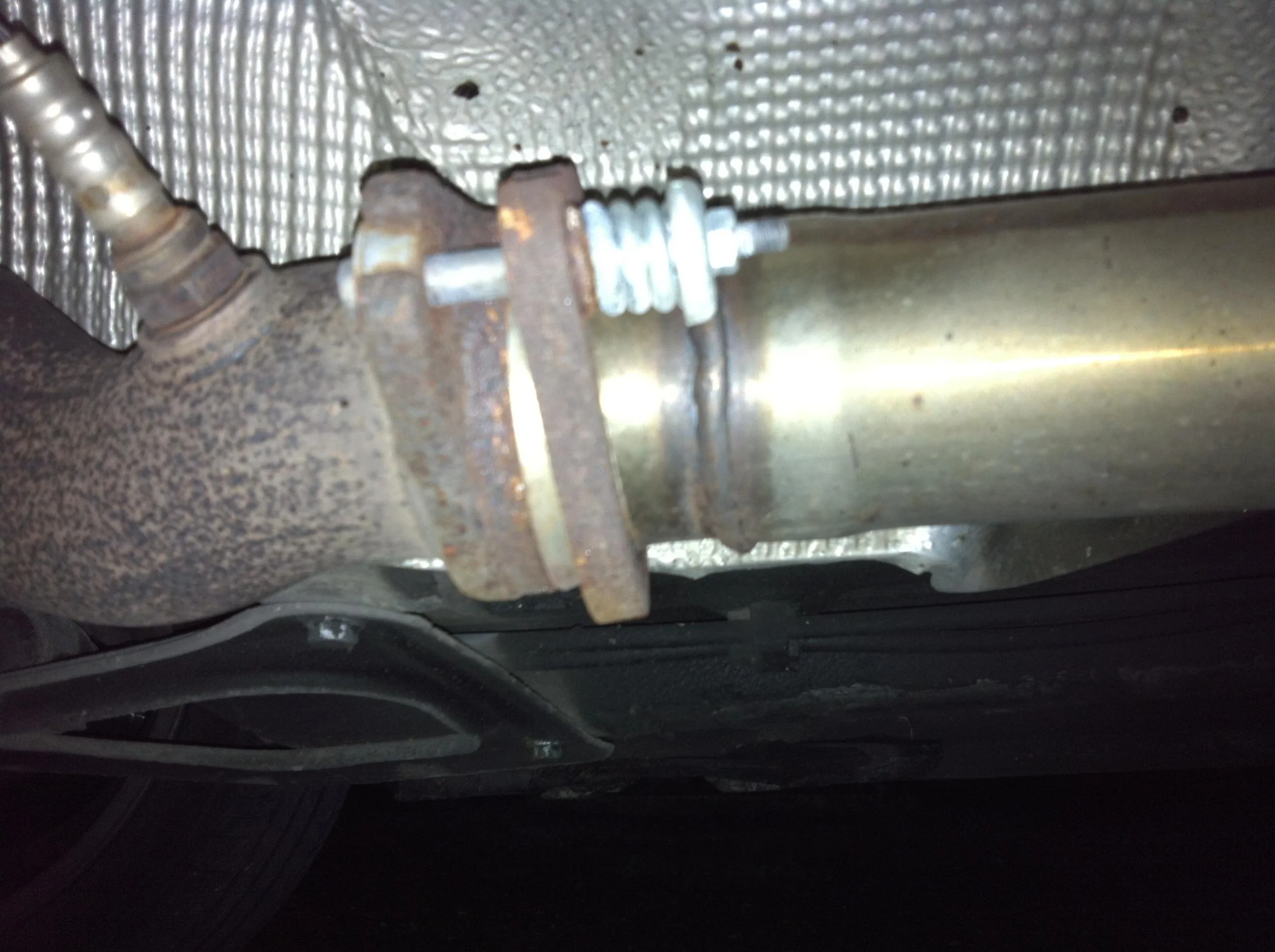

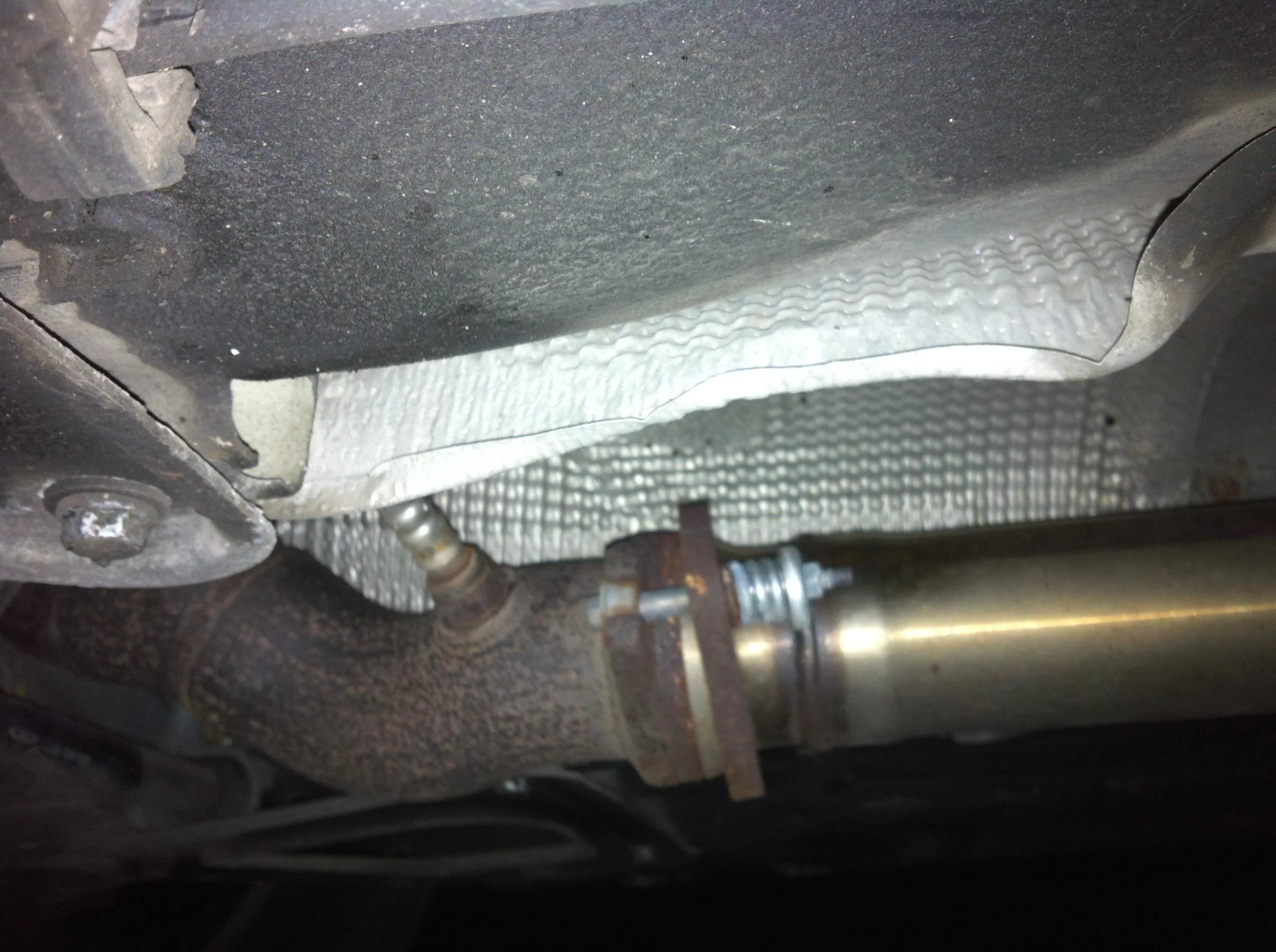

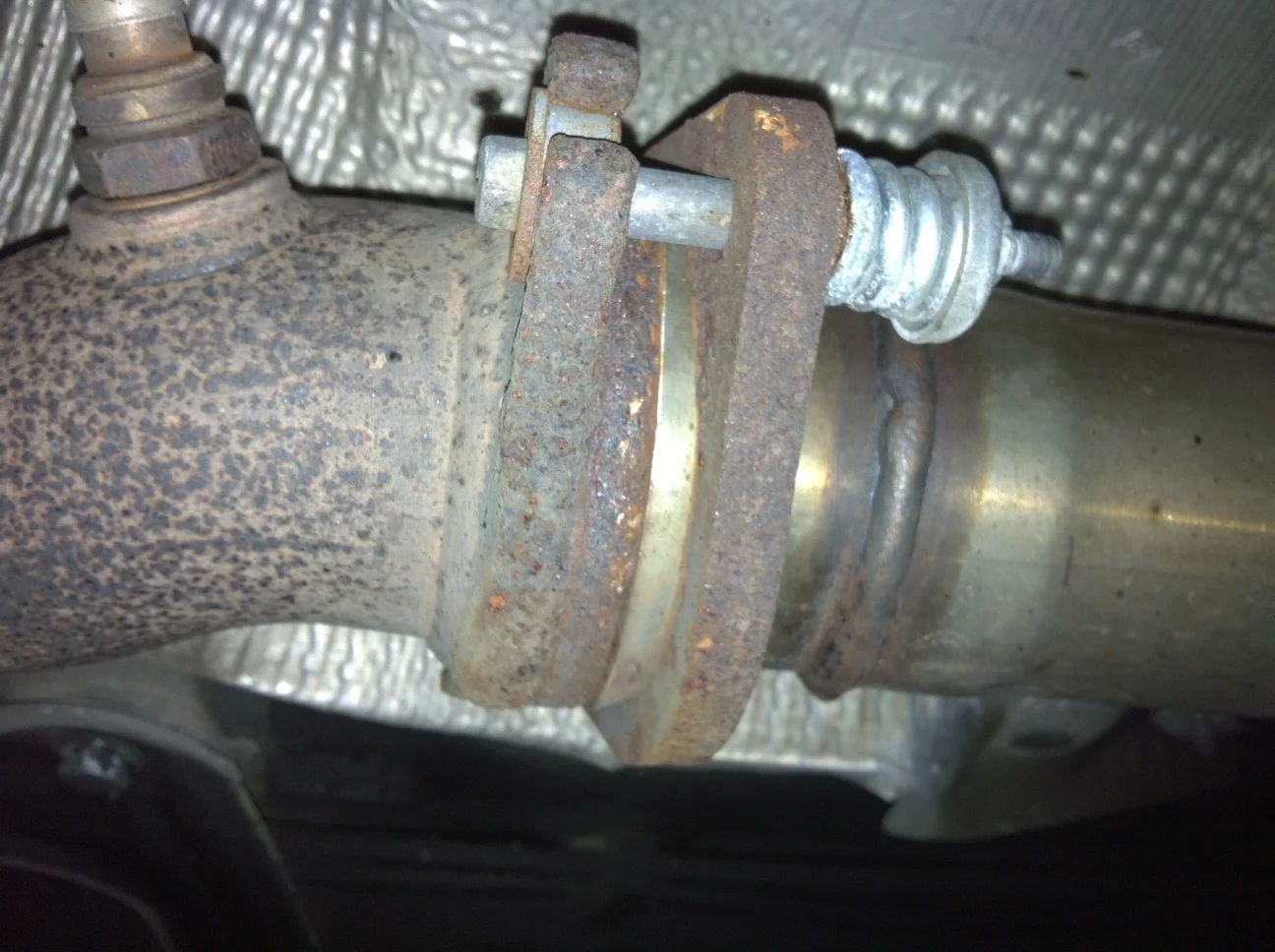

My decat to the res of the exhaust is a sleeve style, the blow I think is coming from the manifold to cat join, as it did it when the standard cat was present and after the decat.... ive just taken a quick pic it looks like the clamp is at a angle ? as i said it was from ktec and not a genuine renault? could this be the issue?

That kit looks a bit weird.
I'd deffo get the genuine renault kit, hopefully it will cure your problem.

I dont understand why its at a angle though? bizarre, I wonder if I should try loosening it off then pulling the whole system towards the manifold join and then re tighten and seal it with a flexible rvt sealant?
have you had the same issue?
Infact, is there even a gasket in there? :S
Somethings not right anyway, buy a genuine kit.

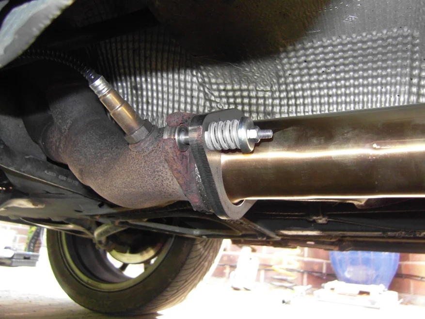

It should look like this - I know its not a miltek decat but the idea is the same.
i think its still there, i think its the rusted looking ring thats in between the two, it was definitely fitted in so it would have had to work its way out? the engine mounts where only done today as it seemed to have quite alot of movement, so maybe now they are stiffer the angle is how it should be and the clamp has stayed as it was before?
I can't see it in there mate, the whole spring and bolt setup is wrong too.
If you have a search youll see genuine is the only way to go, none of the others fit properly.
yeah it does look like its seriously compressed in there... :S
how should it be as it looks the same in the picture you posted as far as i can tell!! however i didn't fit it it was done at the local exhaust place!! ... wont go there again !

It seems like yours is fitted wrong or the gasket is too small.
You should be able to see the gasket ring like the picture I put up.
I cant see the gasket on mine, I bought one from Renault a few months ago and got a garage to fit it. Perhaps I need to get the pipes apart again and see how my gasket is fitted. I will try and get a picture soon.
