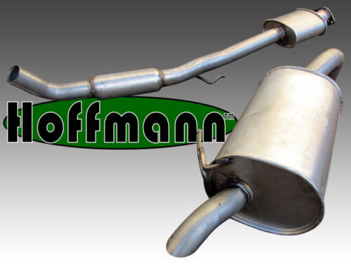

i use the cheapo mild steel off the shelf system, sounds similar to standard, been on 3 years with no issues
This is with a decat and 182 manifold

I had one of those hoffman's exhausts before, very cheap it lasted about 3 years then the mid pipe rusted through and snapped. I bought another and it lasted less than 6months, the rear hanger snapped off the backbox. After that I decided to get the stainless Piper one.
