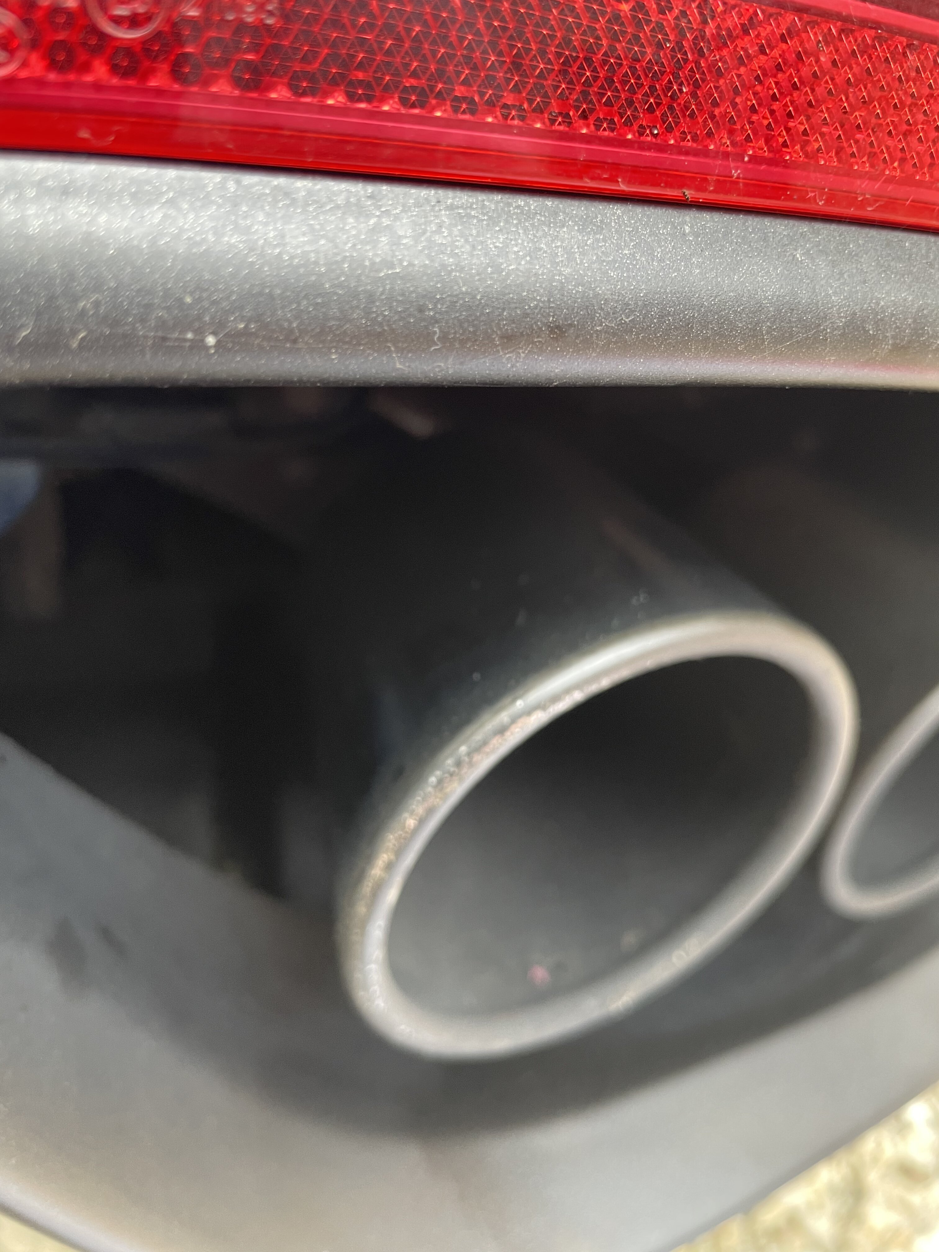

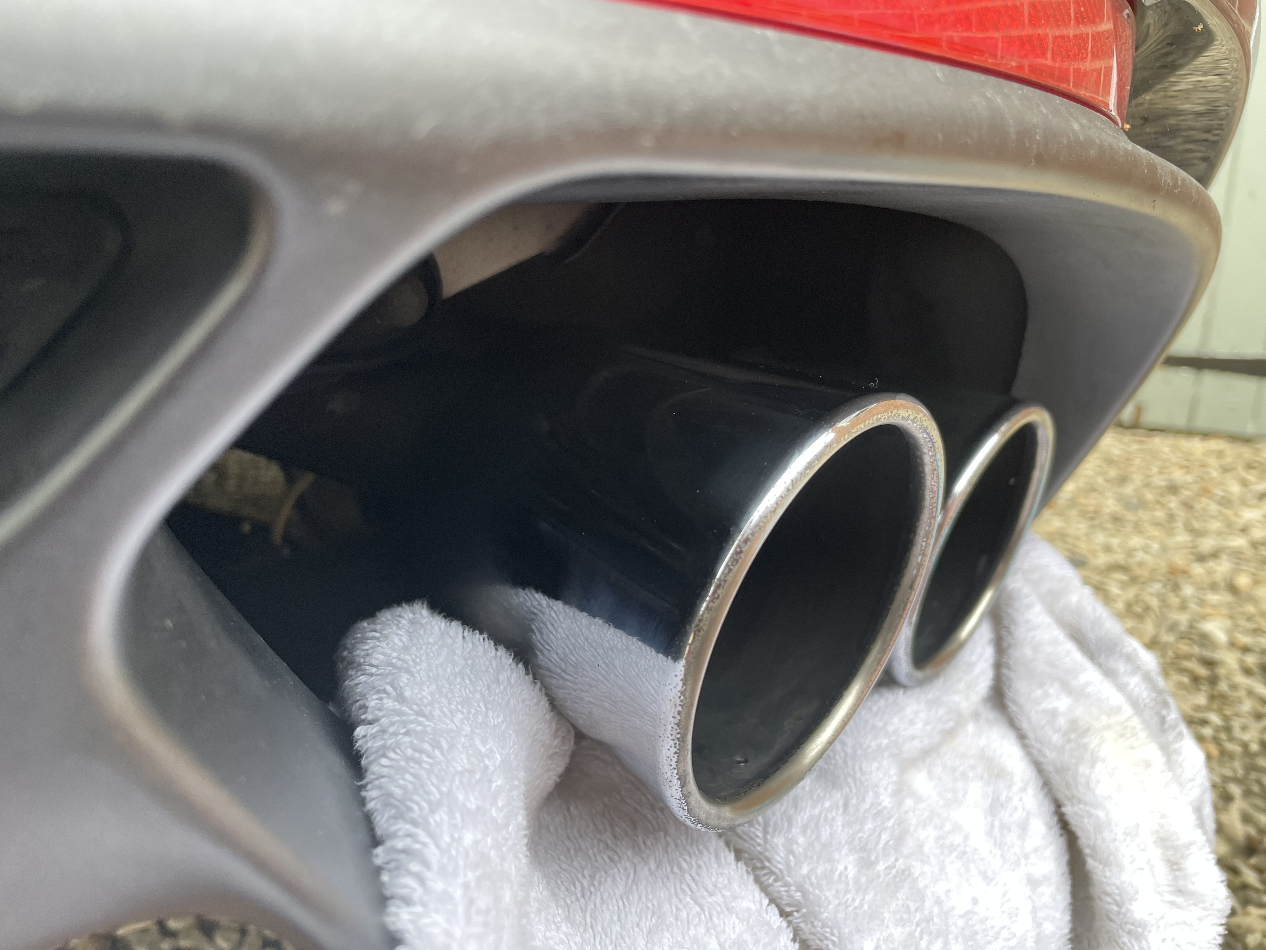

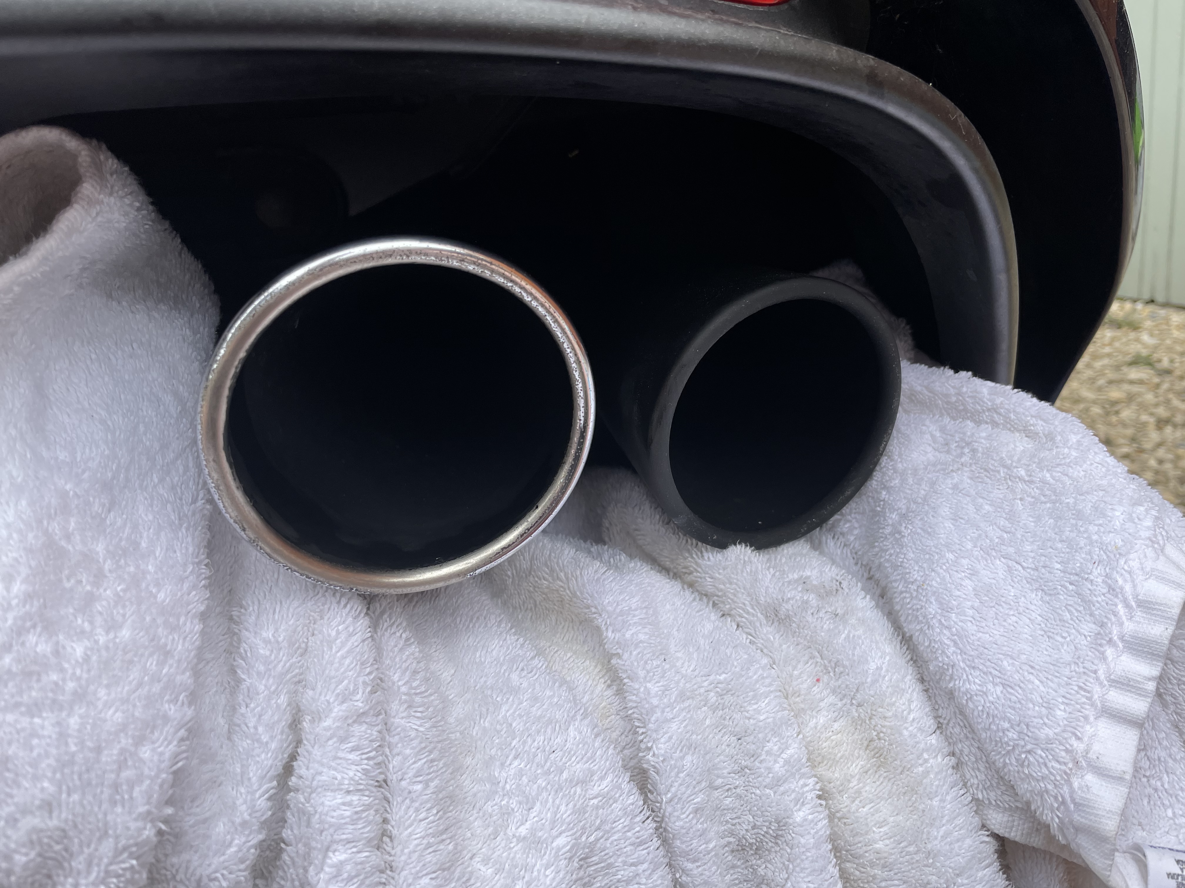

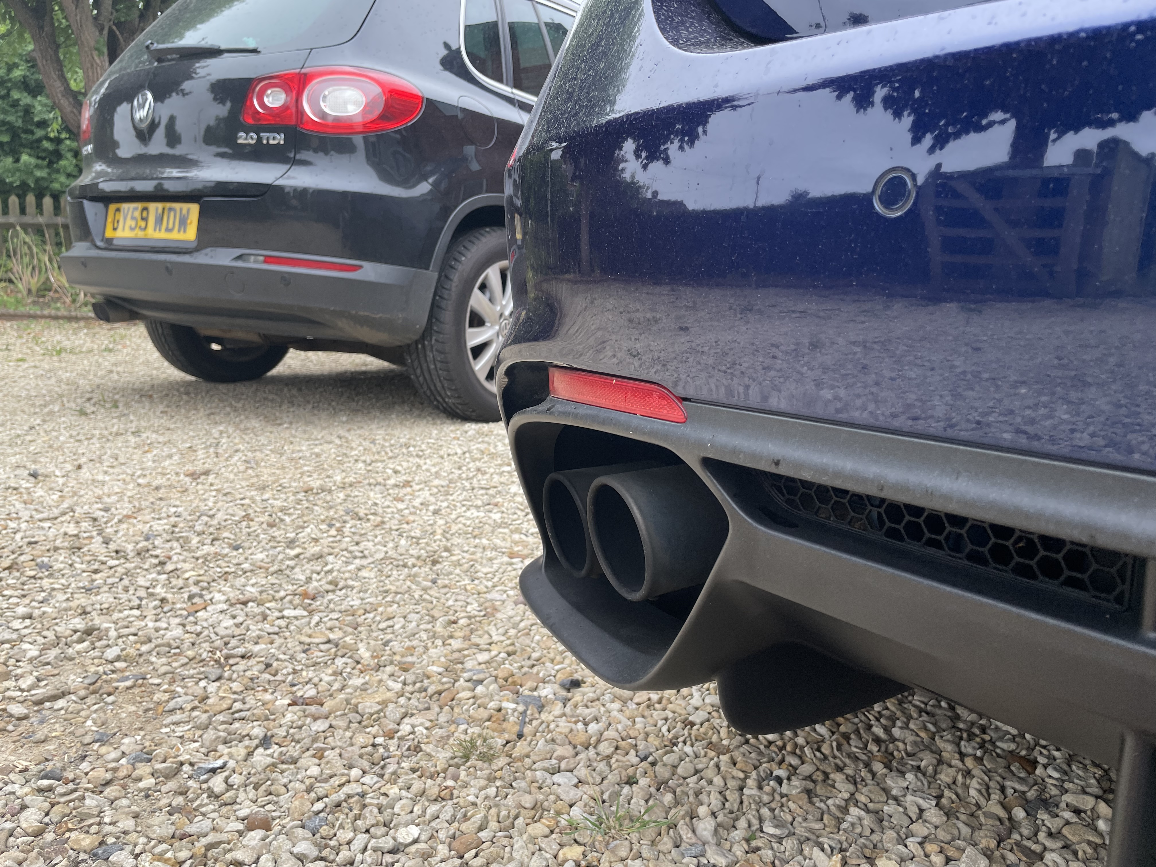

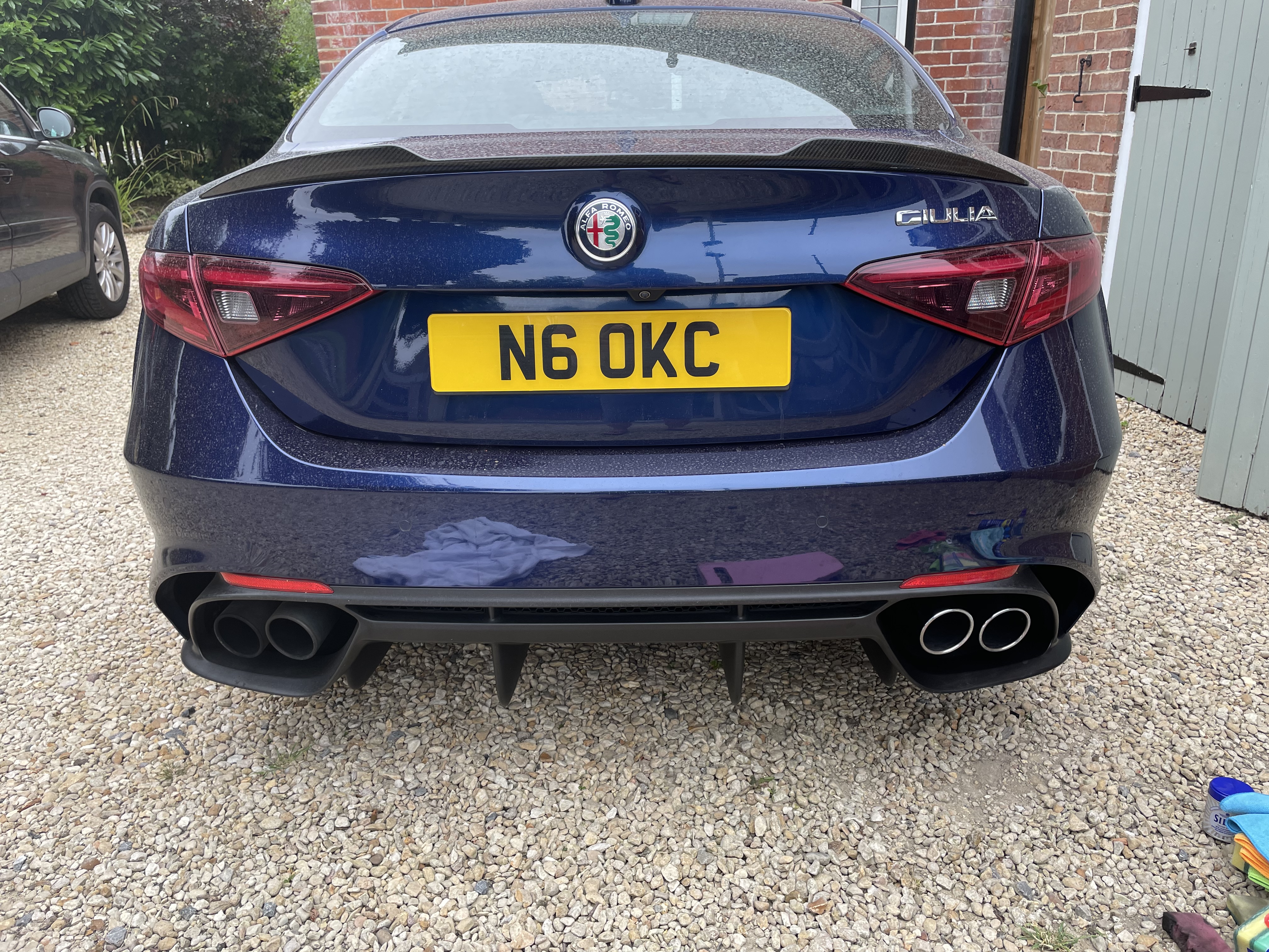

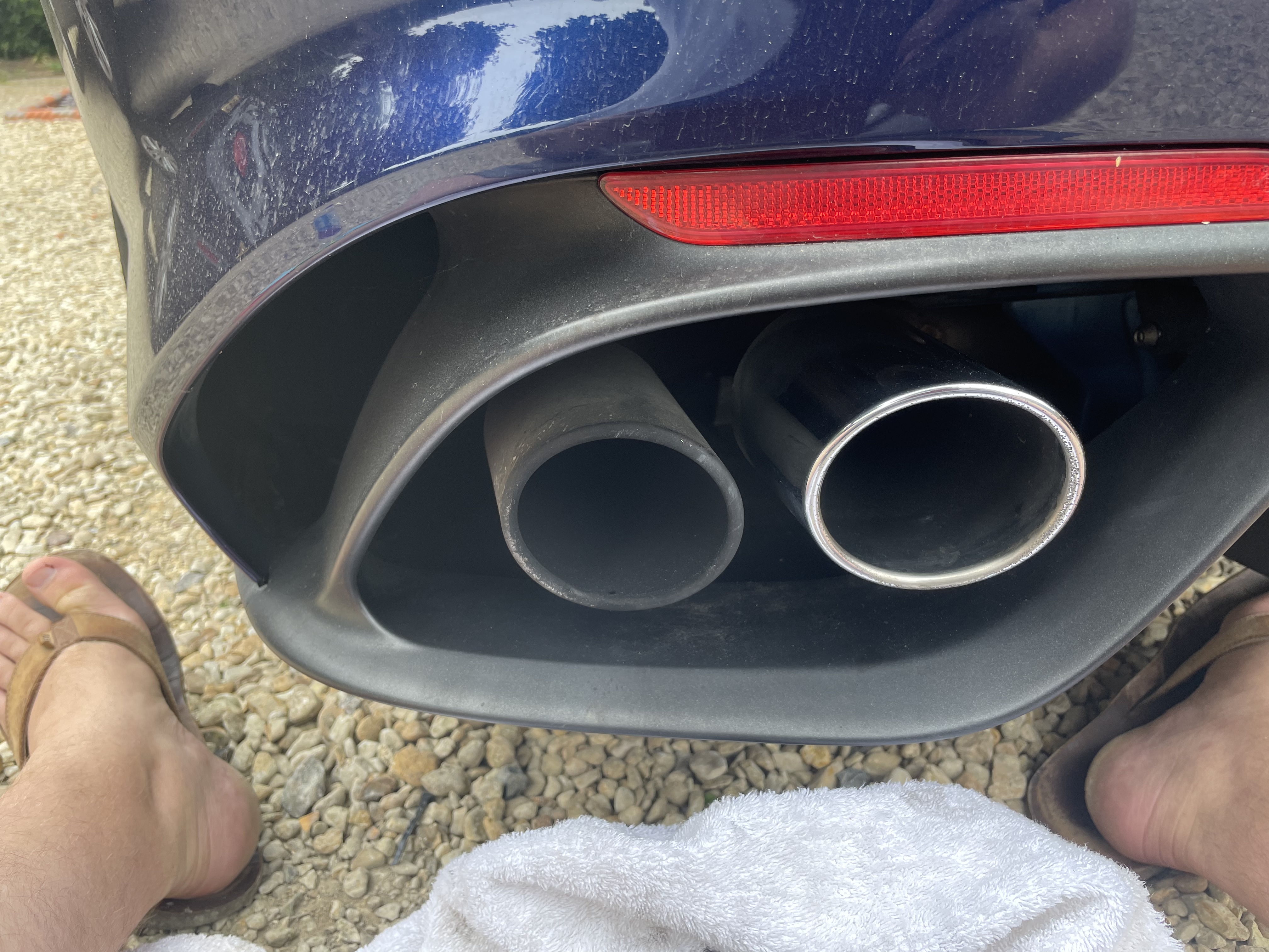

How best do I get these back to silver (I assume they were once silver?).

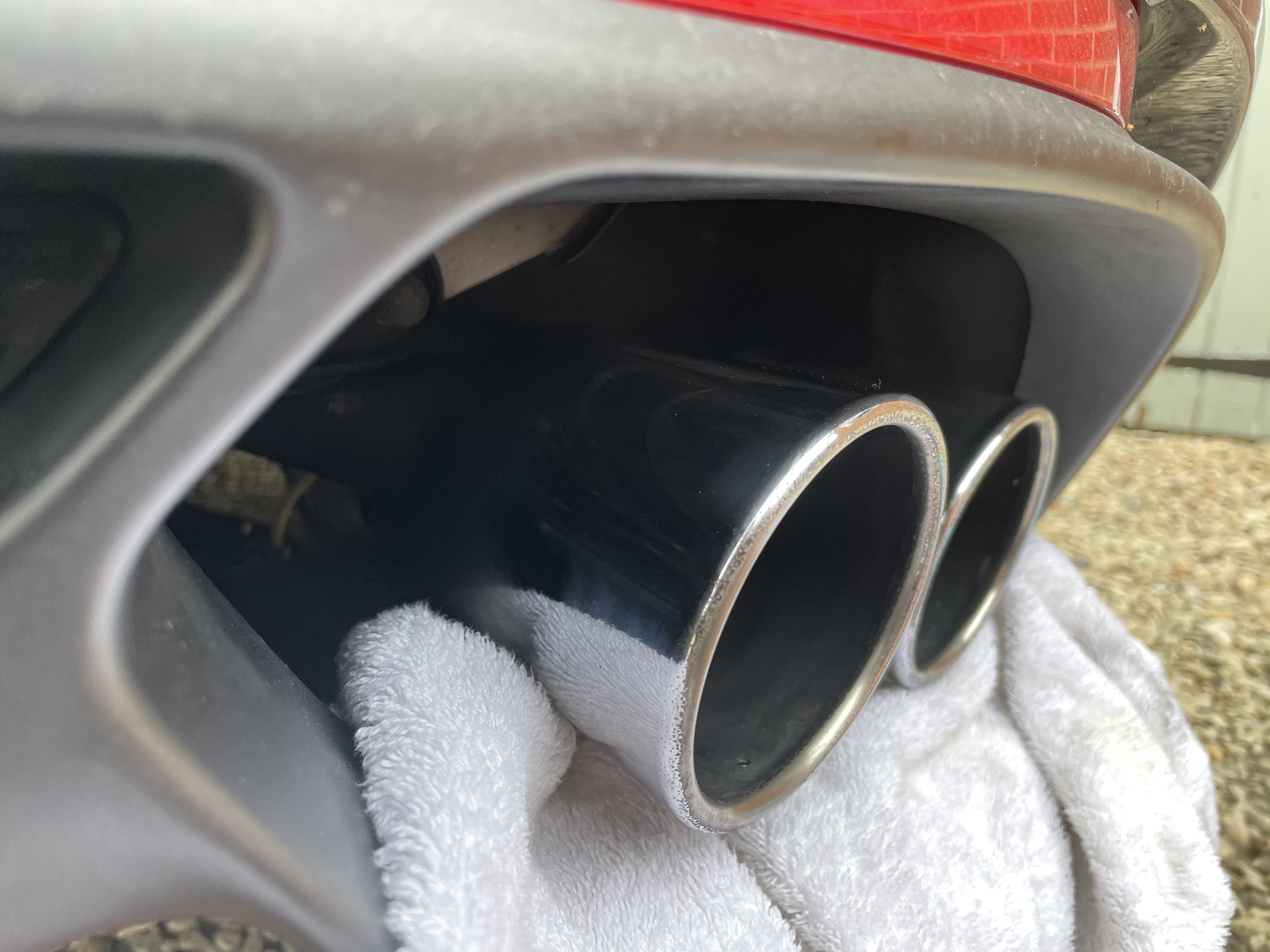

I normally get autosol with a very soft tooth brush
Then buff off with a cloth
Thrust-Rated
President of the KMAG fan club.
  F31 35d, Berlingo Na
When I say buff off.
I normally wrap cloth round exhaust and pull it side to side, like you are drying your back as such.
The cloth I use is a bloody old bar towel, god knows where it came from, it was my dad's.

Try not to get autosol or other metal polish on the plastic surrounds too.
  2014 Clio 200t edc

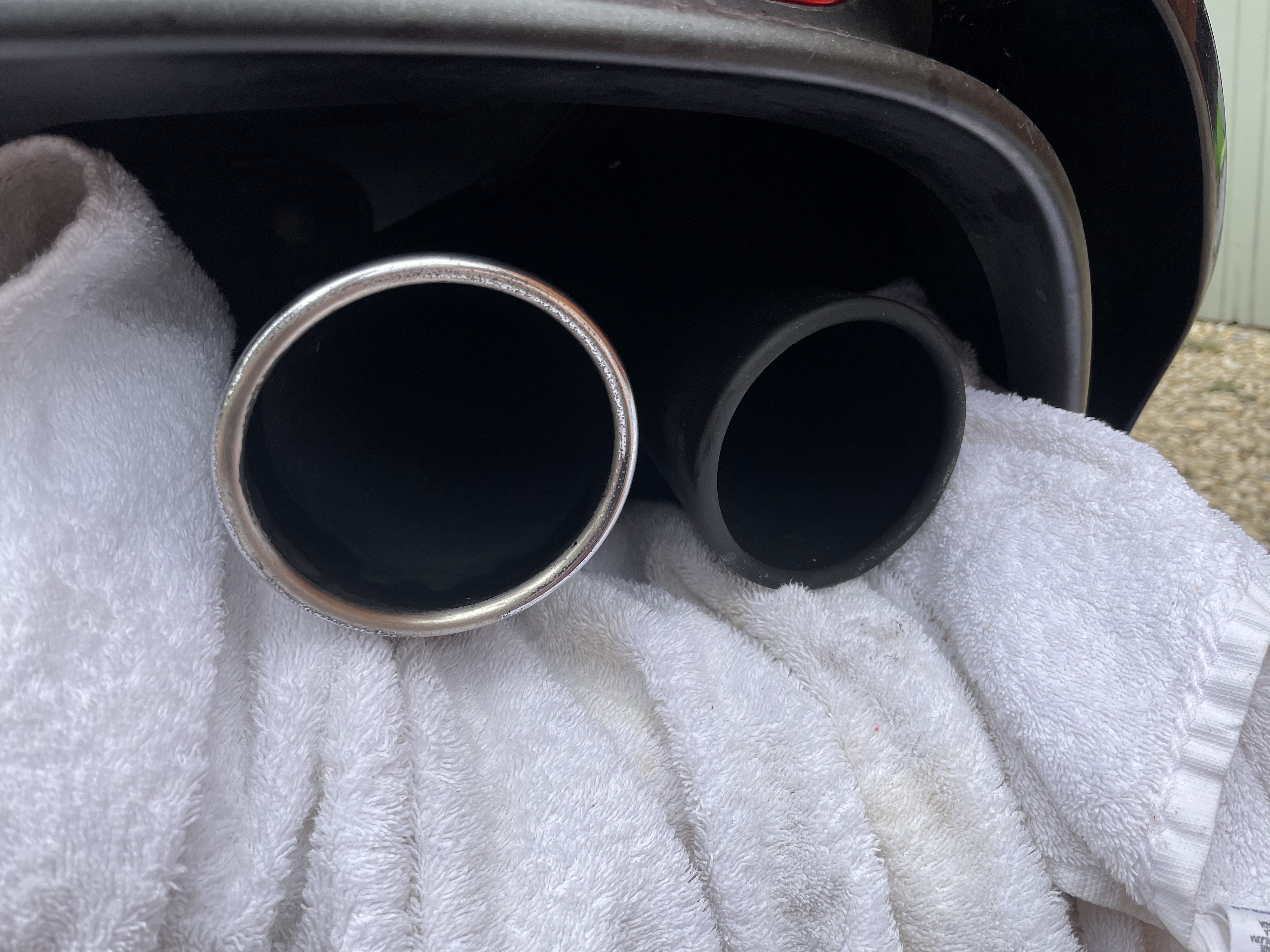

Wire wool will also help and won’t damage them. I use it all the time for tips. Wire wool first then autosoll to finish.

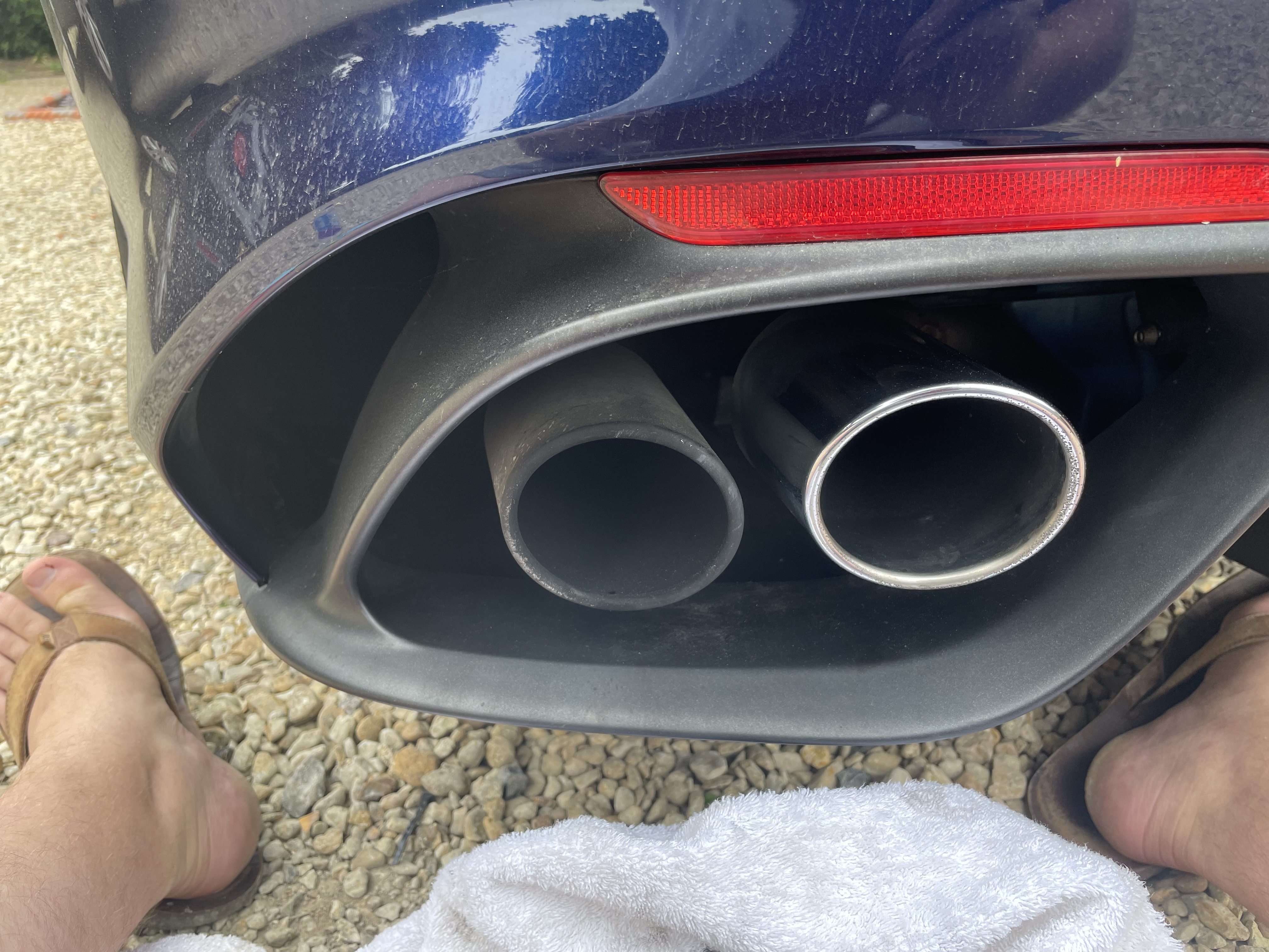

Good job bear feet. One of the best tips I got was these from Tesco...
They can be about messy but some water and the autosol they are tremendous. So cheap compared with wire wool imo and the soap seems to help the metal polish go a bit longer. You've done a fine job though, just incase anyone else sees this post.
