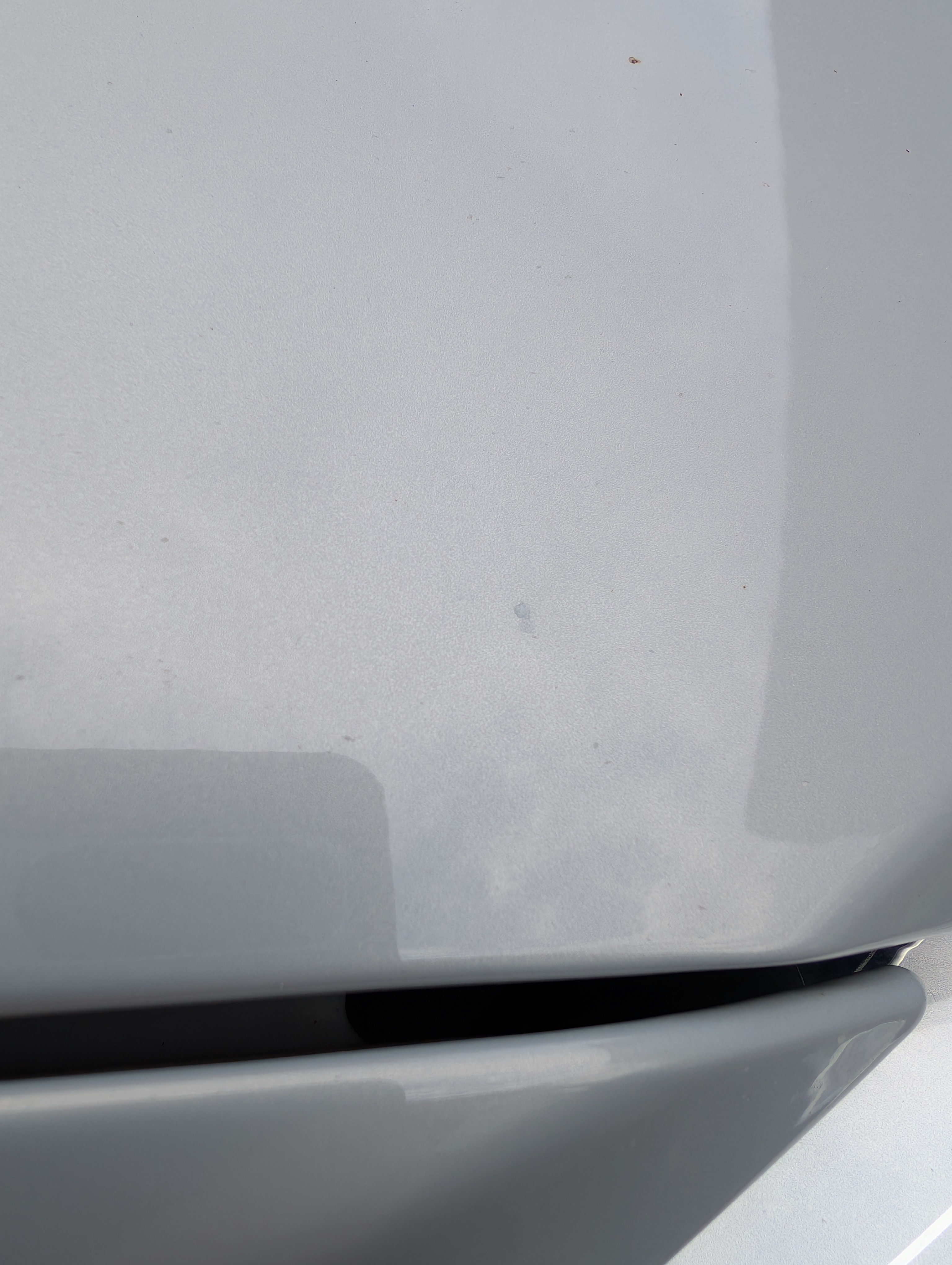

I'm looking at repairing a few chips on my bonnet and a small scuff that someone left for me in a car park the other day. Has anyone had experience with the CHIPEX touch up kits?

I bought a Chipex kit a few years ago, barely used it really but did some bonnet chips last autumn and a larger piece on the bonnet where a brick hit it. :(
Chips have all blended nicely but the larger part is still noticeable (to me at least), partly due to the yellow being slightly off, partly due to the dent that's in the same place. It's all pretty simple to use as long as you take your time and fill the chips progressively. I use cheap fine arts brushes when applying it.
The ones I've done with the Chipex stuff look better than the previous owners attempts which I assume were just blobbed on with a Fiat kit.

Imo , it looks a bit expensive for what you get . There used to be a link to a guide on detailingworld years ago which i used and it worked . Just get yourself an aerosol mixed up in your colour , a few cocktail sticks and some 2500 or 3000 grit wet n dry paper . Make sure the chip is clean , no wax or dirt , use some panel wipe or Isopropyl alcohol , acetone would work too . Spray a small amount of the paint in the lid then using the cocktail sticks fill the chips with the paint , building up the paint until it stands proud , leaving to dry in between , it dries pretty quickly . Leave it to dry for 24 hours or so and then gently sand back then polish .
