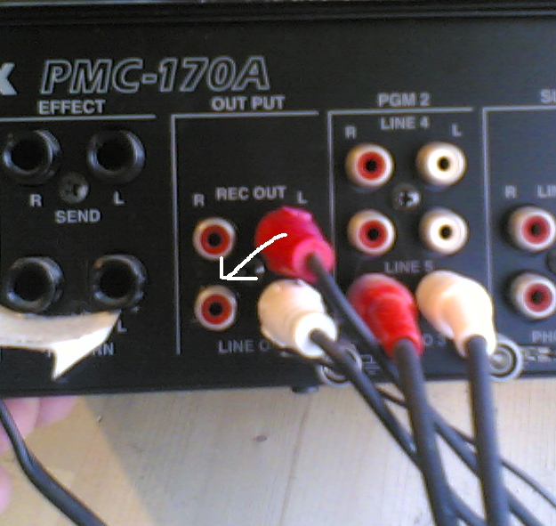

^^ clart just downloaded that programme, wheres the rca on the back of my mixer?
Clart
RCA = phono mate look for white and red outputs on the back of the mixer

back of my mixer
And what lead do i need>?
Clart
u need 2 RCA/phono (red and white) to 3.5mm headphone jack - about £3 from a hifi shop
Clart
ur output leads are in the wrong place btw - match the colours up to output record L & R
i was just about to say that!

just moved them clart!
this look better?

so where would the red and white parts of the lead go in my mixer? into the rec out?
i use the booth output on my djm, that way you can adjust the recording level of the mix, ideally you should be using the rca to 3.5 jack from the mixer into a line in on the soundcard but some people like myself dont have one so the mic port has to do, i use soundforge to record mine, its really easy to use

I don't have 'REC OUT' on my sh*tty mixer lol
I plug my lead into the red and white 'LINE OUT' (the one below) and the other end (jack) goes into the the 'LINE IN' input on to the back of the soundcard on your laptop/pc.
should have this logo next to it
