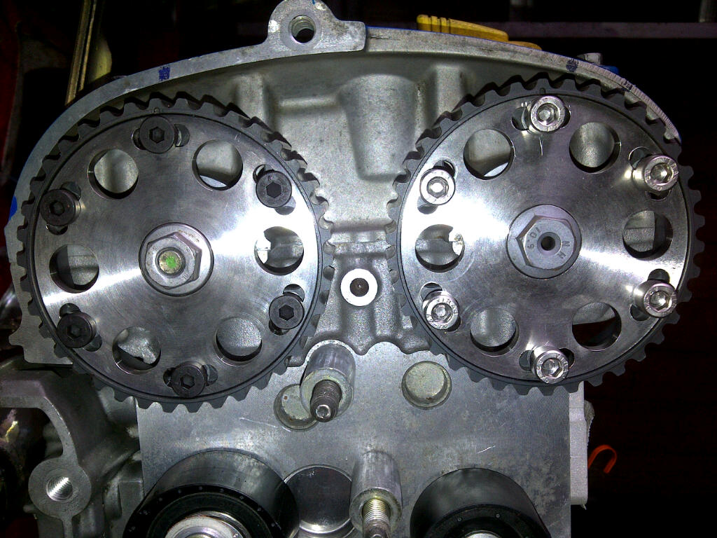

The issue is that the engine has now covered 115k in the cup and the dephaser has started the usual rattle do obvious route to take it to replace it and the belt as normal.
Due to it being destined for track, if we where to remove the dephaser pulley and dial the cams in to how they would be at full vvt all the time (it would constantly be in vvt on track anyway) would we have any issues with ecu and what would need to be removed from the vvt? I have seen people fit vernier pulleys on these engines before but they are normally fitted with high lift cams and stand alone management.

I had VVT delete on my old 197 with a CatCams vernier pulley. If anything the power delivery was smoother and on track it felt and revved much better.
  172 cup, Impreza P1
They look good, made from 2 old dephasers?
I made the pulley body's and the pulley outer is from old dephasers.
They look like proper vernier pulleys
They are essentially. I thought why re-invent the pulley as the machining work needed to make the teeth would be too costly.
These will be getting tried soon on my car and can make more if there is interest.

Steve what you've done re dephaser end does work as you'll know as we did the same on the ph1 with the modded exhaust pully :) we had the bolt tigged

Cheers Andy! Just started to think I had maybe missed something.:eek:
