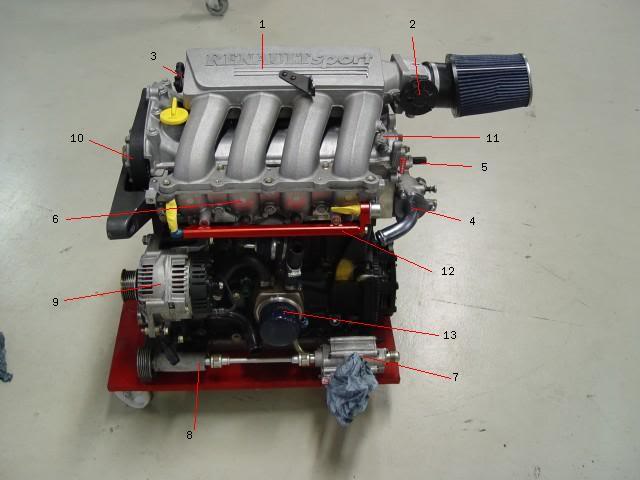

Hi Guys,
I was hoping some of the more technical of us could help annotate the F4R engine. I'm a complete novice when it comes to engines and want to learn a little bit more about the engine. If you asked me to point out 'item x' I probably wouldn't be able to do it.
This is a fairly clear pic of the engine and if you could point out where stuff is I'd be much appreciated. i.e Throttle body, that kind of thing. I know where the A.C is, lol!!

1. inlet manifold
2.oil filler cap
3.alternator
4.oil filter
5.fuel rail
6.fuel pressure regulator
7.throttle body
8.air filter
Thats a Formula renault lump, so not quite the same as whats in yours, in terms of accesories.
Basic engine is the same.
1-Plenum
2-Throttle body with TPS (throttle posision sensor) on the far side
3-Map sensor
4-Thermostat housing
5-Coolant temp sensor
6-Manifold
7-Dry sump oil pump
8-Dry sump oil pump drive shaft and aux belt drive pulley
9-Alternator
10-VVT phaser pulley
11-Air temp sensor
12-Fuel rail with FPR (fuel pressure regulator on nearisde) and injectors
13-Oil filter on water cooled oil cooler takeoff.
