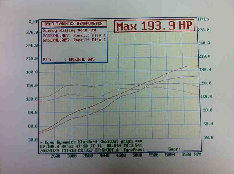

Thanks will get it lightly ported and probably look at uprated valves as already have cams and bodies , doing around 180 atw justnow.
Have read about the belt tension problem if too much is taken off but also a few people using a bigger idler pulley to sort it.
180 with cams & bodies are they fitted ? It's a bit on the low side or am I reading this wrong
