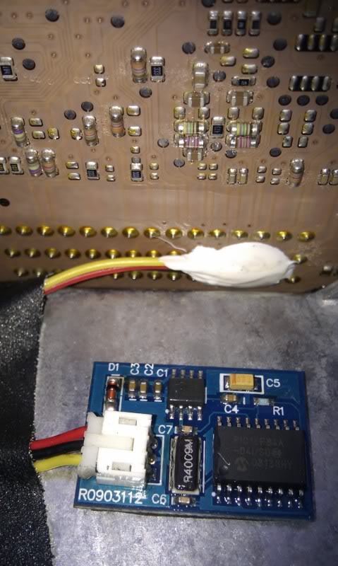

On my F4R engine in my Mk1 the ecu was de-coded and the emulator chip fitted like so
I am getting the immobiliser stuck on though, as the engine only cranks and does not give 12V to the coil or any injector pulse when doing the test with the little bulb.
I think it must be the emulator chip that has failed.
My question is, if the ecu has already been de-coded and fitted with the emulator chip, can i just buy a new emulator and swap it over, or is there anything else to be done like decoding again??
Tim
Yes you can just buy another emulator and plug it in, I did once as one of the pins on the small white connector had broken. This only applies if the ECU was virginised/decoded before fitting the emulator - who fitted it/did the work?
Easy way to test if its working is to check if the emulator is getting 12v with the ignition on, and if its earthed properly.

Yeah it probably has been. If you have a multi meter test the wires for the emulator, see if one of them is 12v when the ignition is on stage two. Test the earth also, it should give continuity to the - on the battery itself. If both of them are ok, the third wire should show 5v(ish) - if that's the case then the emulator should be OK. If they are the results you get i'd be looking at crank sensor as that's the other thing that causes the issues you describe if its not the immobiliser..

Could be the emulator then! Ive had no end of issues with my ECU/emulator when I first did the conversion in 2008/9, but it was OK last year - so I hope its fine for good now!

I ordered a new emulator on monday and it took royal mail 3 days to deliver it but now my car is fully operational again Wooohooooo :D
