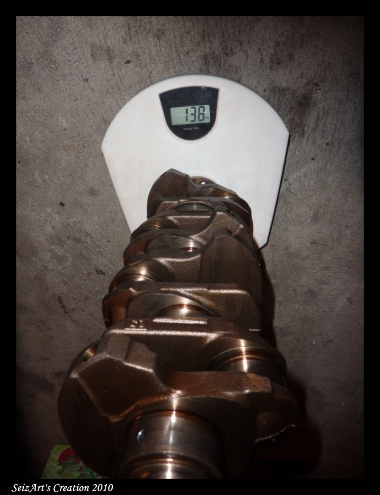

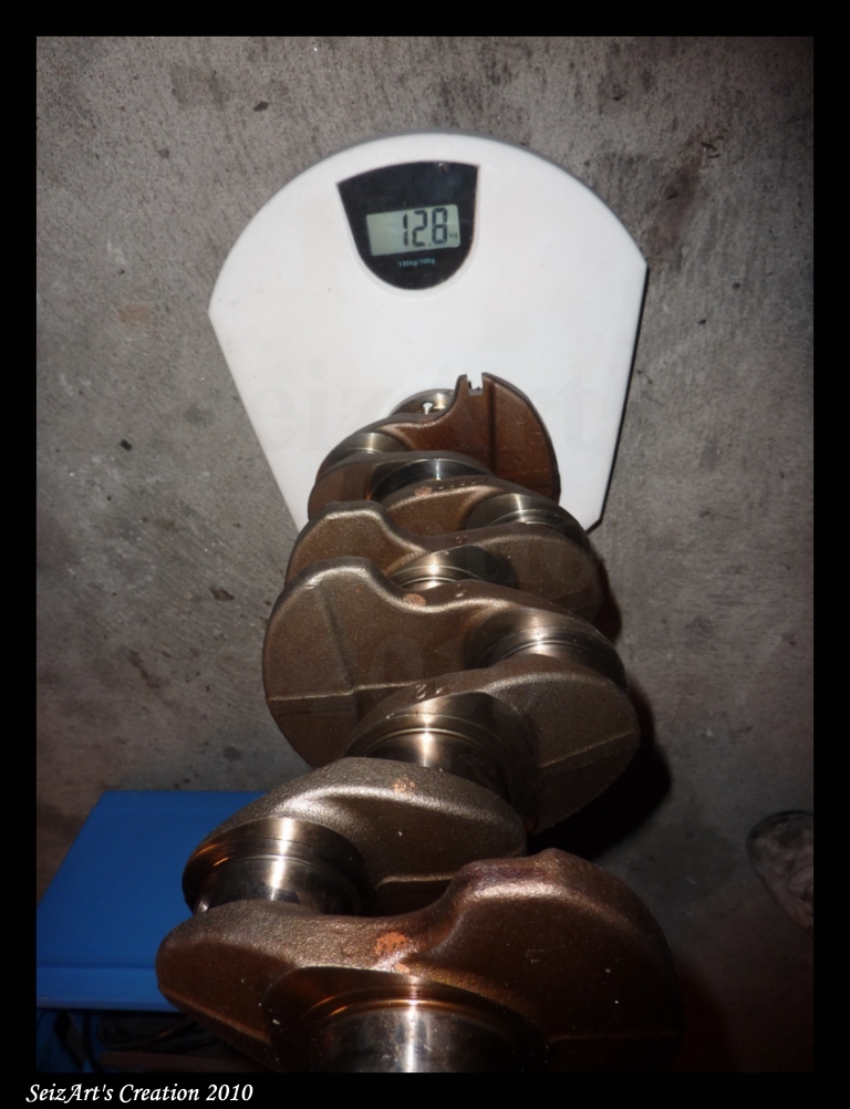

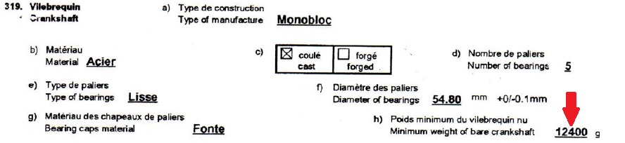

Are you sure? I have these weights for F4R cranks:
172 Ph1 xx.xkg (but I think it's similar to 182 Ph3)
172 Ph2 12.8kg
182 Ph3 13.8kg
197 Ph1 14.5kg
Interesting. I weighed a 197 crank and a ph1 crank. The ph1 was heavier than the 197. I have a ph2 172 crank I can weigh for comparison to your figures.
Where did you get them from out of interest?

I got them from Clio RS French forum.
F4R736 - Ph2
F4R738 - Ph3

Yep, but lighter than the ph1 172 crank. There's a relationship between rod weight, piston weight and crank weight but my mate who knows substantially more about these things can't explain/describe it to me. A lighter crank isn't necessarily the best way forward in some cases.
