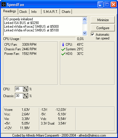

Not having much luck with that programme says its around the 3-4kRPM mark but can't see anywhere to turn it down more,http://www.lowestonweb.com/Products/DisplayInfoMain.asp?e=A48B5D9B-8B90-439C-99D0-28D5E8F8FC0B
That's what the program is designed for... Adjusting fan speeds hence the name SPeedfan. The main page allows you to adjust the speed of various fans in your PC from 100% down to 0% (off).
Sorry should have explained better, unless I'm missing something (very likely) the fan causing all the noise is Fan 1, which is set to 2%, putting it down to zero does nothing. Oddly I'm not hearing noise from the other fan, best open it up!
Looking at that screenshot the fan is still running at full speed even though you've set it to 2%. You probably need to read the manual and alter the fan from Bios controlled/Smart fan to "software controlled".
It would appear that Fan 1 is the CPU fan and the case fan isn't on that list, will have a look around bios see if i can work it out, I presume that 3245RPM is fine for a cpu fan?!
Yup.. The smaller the fan the faster it spins. My CPU fan is at about 4000rpm and my chipset fan at about 7000rpm.
