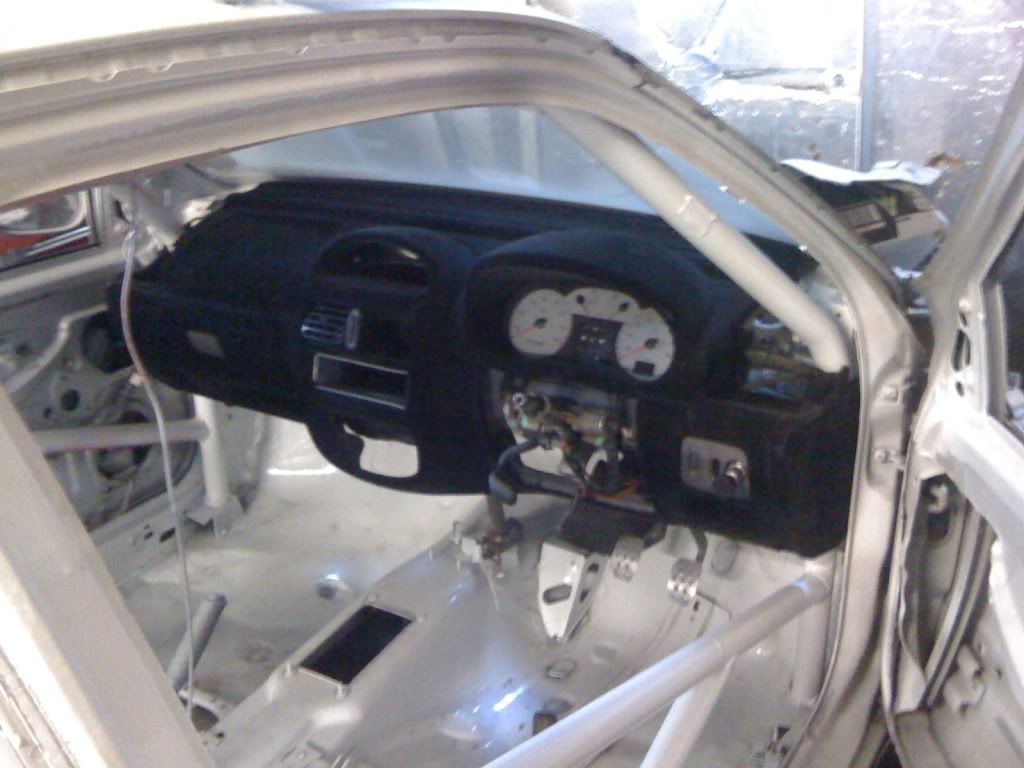

I removed my airbag. drilled the rivets out holding the skin on and sikaflexed it back onto the dash to be flocked:
