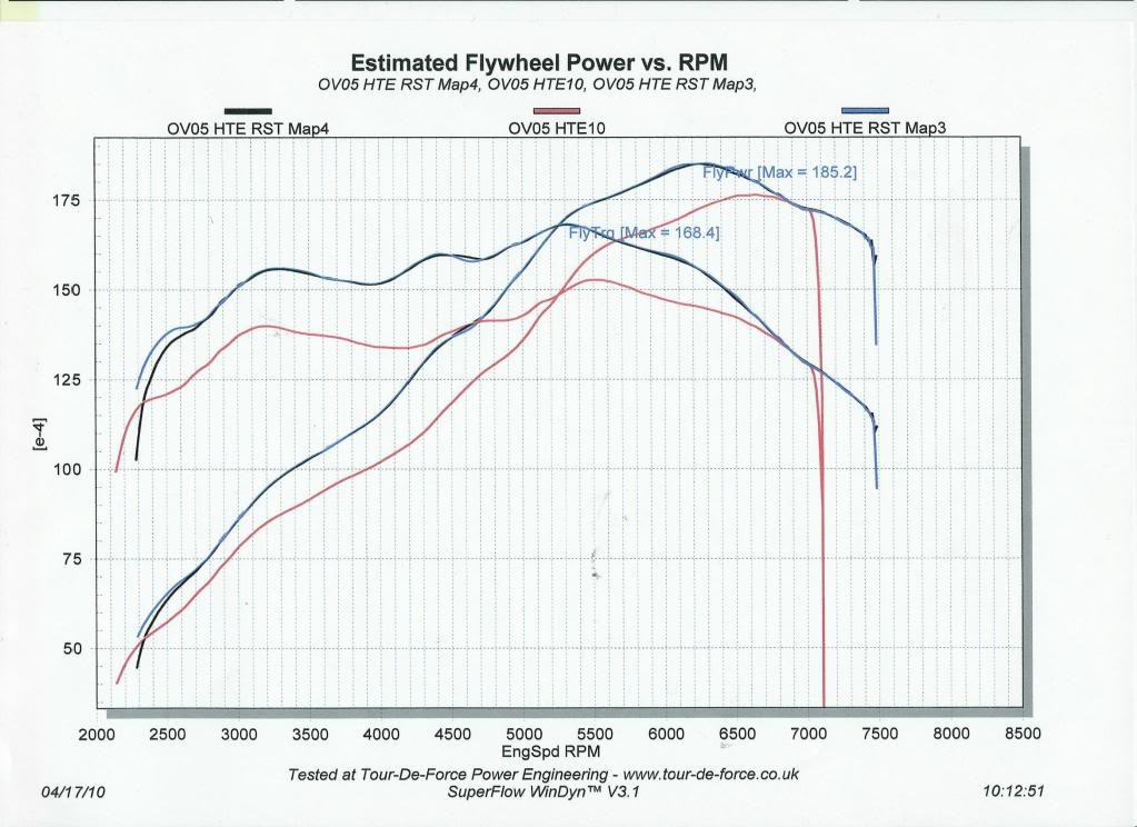

What gains are realistically expected of camshafts and a remap? (if any?)
We gained 10bhp peak and a load more torque, it's nit necessarily about how much peak power u get but how it changes the delivery. It's fierce at 5k now, the tc doesn't know what to do with itself lol here our before and after

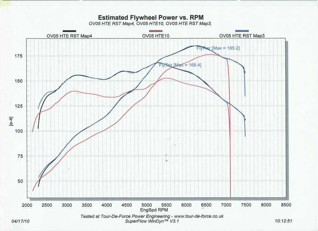

I like the look of that! :eek:
