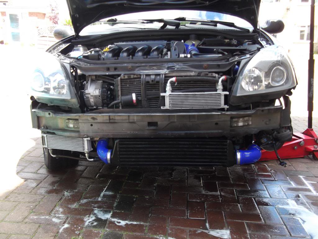

Thinking about going back to see Paul to get the power turned up a bit, going to see what he thinks about using a megane head gasket like Dan has said and try and run around 7-8 psi and get to around 280 bhp.
  KTM 990 SD / S60 D5
Yes mate, you can either make the hole bigger in the one I have or get another. Not sure what sizes they come in though, so will have to look into it. Car is running great so I think she can handle a bit more without going mental and spending a huge amount of money.
  KTM 990 SD / S60 D5
Cool, I would have thought at 10 psi you should be seeing 270- 300 ish depending on the dyno, you still on the standard clutch as well, any slipping if so
Ive got my old restrictor that i had machined out cant remember what size to ill have to measure it, but Paul said it should make around 280bhp he also said at the time that the engine would be fine & didn't recommend fitting a Megane head gasket. You could give my restrictor ago if you want mate save you getting yours machined out incase you want it back to the current power.
Mine was at 0.5 bar or 7 psi making 260bhp & around 220lbs ft on the standard clutch & it was perfectly fine no slipping.
For reference I've took the restrictor out of mine altogether now & its making 0.9 bar or 13 psi

That would be great mate, I have sent a email to Paul so will see what he say's, when I was there before he said mine was running a bit too much boost at 6 psi for a low boost set up :S I will send you a pm once I have spoken to Paul.
Yeh I'm still on the standard clutch. No slipping. My restrictor is in the intercooler and @ 33mm from 29.
That's good to know, does it make much difference where the restrictor is, mine is in the induction pipe about 12 inch's from the charger.

^Interesting, thanks. Just had another look at my dyno graphs and it seems mine is running .6 bar so around 8/9 psi.
Got a email back from Paul, he said that he wouldn't bother with the Meg head gasket, he said the main problem when pushing the standard engine is the ring lands on the pistons and the only way is to try and see if I want more power. Will probably just see what he can get out of the car on the current set up for now and see how it go's, plus wouldn't mind Paul just giving everything a check over.

Dan are you using an rstuning (pro alloy) intercooler? Just with you having the restrictor in the cooler.[/FONT]
Mine was the same as Dans in the intercooler, if I was you Dom I'd be putting yours in the same place, Stu went through two engines & DannyR had the same engine problems all had the restrictor before the charger, might not have been the reason behind the engine troubles but just seems abit strange to me. I don't see why the restrictor would be before the charger either.
Speak you Paul though mate & see what he says.
Try & get a picture of your intercooler Dom, the charger side then I'll no if my restrictor will fit.
Yes mate, and the pro alloy radiator too. I'm not sure if the intercooler is a restriction in itself, as I've opened up the restrictor 4mm I total and gained 2psi. And for a supposed 400bhp charger it's not looking to be flowing very well.

Yeh my previous pistons shat the ring lands. I lowered the compression slightly using the meggy gasket as I was struggling to out anymore than 15* of ign advance in without it detonating. So lowered it to be a bit safer. It certainly doesn't feel like it's suffered for it, and when I comp tested it, I was getting better compression than most 1*2's out there.
Same intercooler & radiator as me then, I no what you mean about the intercooler tho it does seem like it could be restrictive, as I've just said in my thread I think the c30-94 will make its claimed peak power of 400bhp on stuff like golf r32s but on the F4R it will struggle & I'm not sure if you can change the pully size when using them on the clios? I no you can on the R32s.
You can, you could go to an 80mm(I think we have an 85 currently) but we would be over spinning the impeller after about 6700rpm. I dropped my rev limit from 7600 after I found I was over spinning it by 6%

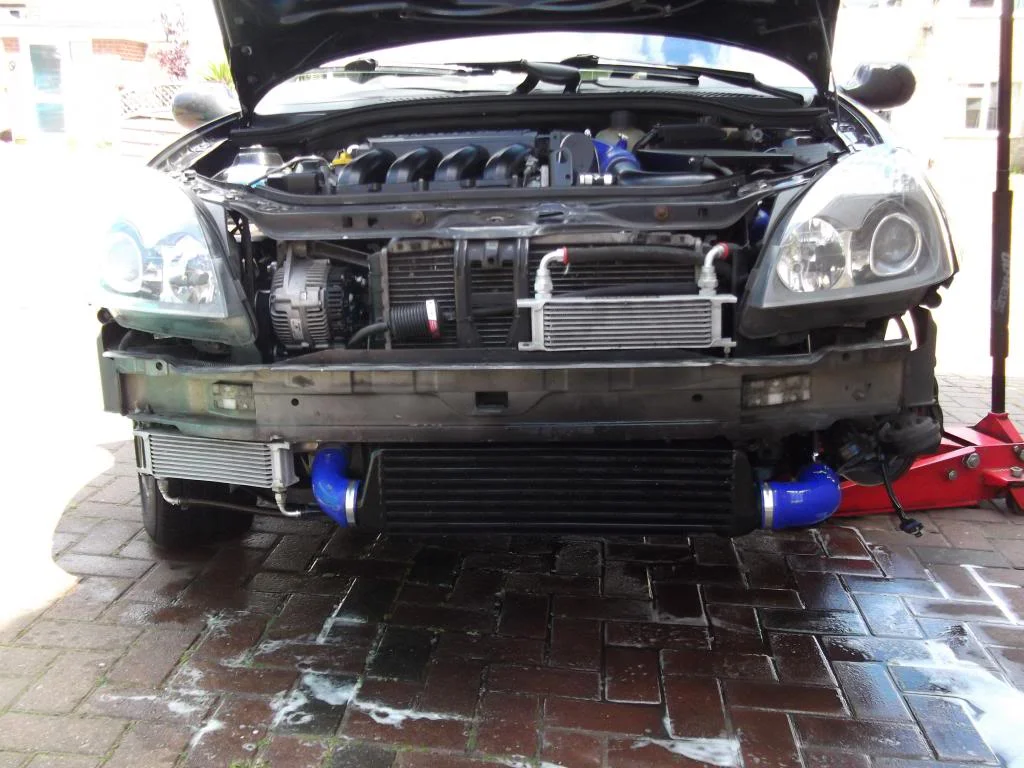

Try & get a picture of your intercooler Dom, the charger side then I'll no if my restrictor will fit.[/QUOTE]
I will speak to Paul about the restrictor placement, can't see why it would be a problem where it is, it just effects how much boost you get through the same size retrictor as Dan has said. Hers a pic anyway.
  KTM 990 SD / S60 D5
Its just under the slam panel on the right, have you managed to mount it that low down then, I know it is suppose to be at same level in the book but tts who helped develop the kit said its ok where it is. I think the main reason rotrex say to have it at the same height or below is to help prevent leeks.
