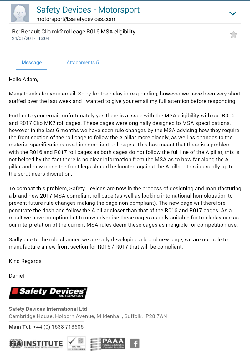

In light of all the recent discussions regarding safety devices cages in competition cars I thought I'd speak to SD themselves, below is the response I received, thought it may be of benefit to others who are in the same position as I am now

Reading somebody else's thread it would appear the 20th March has been quoted, but to be honest my cage was delayed by about a month (got mine in a group buy though)
I'm going for a full weld in one next though, having found out there's a motorsport company in the same town that I live in :)

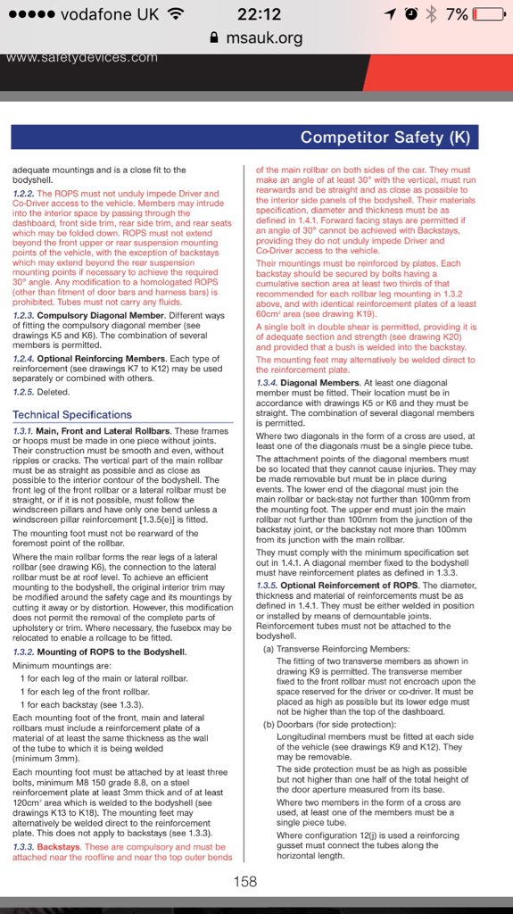

Really ... I need to read the guidance in the Blue Book but sure that means some 50%+ of Clio race cars face modifications for 2017. Classic MSA
Steven_K
  Clio 182
Rules don't look changed for what I remember... and I'd suggest that the Daniel is right in that the MSA don't suggest how close to the A Pillar the leg is required to be. It's a bit ambiguous to me
  Clio 172 Merc ML55
Normally anything that's changed is shown in red from memory?
I've got a copy of 2016 book around somewhere so I'll check that shortly
scotiamr2t
  Mazda 2, Ph1 172
The wording regarding the following of the A pillar hasn't changed. Its simply been brought to light as a view scruts have raised a concern/issue with the design implemented in the current safety devices (and others) cage design
  Clio 172 Merc ML55
I guess whichever way you look at it I'm gonna have to change my cage, and I expect I'm not the only one either

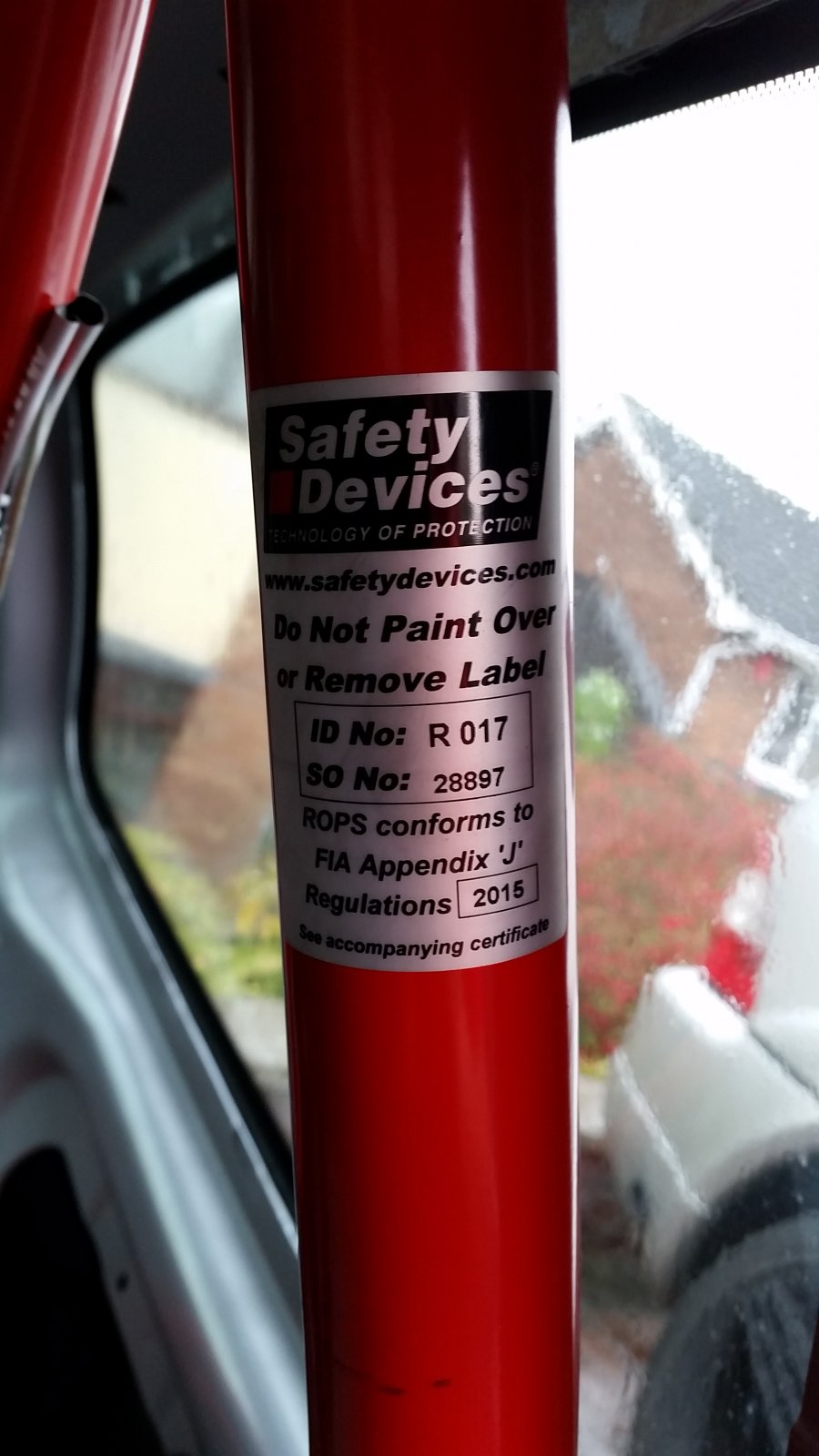

  Clio 172 Merc ML55
Yeah you'd have to assume that any dash dodger could be effected, unless it has FIA/MSA homologation.
This is where I get confused, as I believe mine is homologated, it's got its Fia sticker on B pillar with serial number. I'm not disputing the argument over front section at all, just a little confused

think its any cage that doesn't follow the specifications, its just been bought up with Safety Devices because theirs stops short of the dash and that's against 1.3.1 written above
Interesting.
I contacted SD and they said mine was ok, though mine appears to suffer the same issue as the Clio one.
Ye i can't really get round my head how my cage can now fail scruitinering when the rules haven't changed regarding the a-pillar. Seems very unfair to now make near enough all dash-dodgers now void due to this. I'll be taking mine to be scruitinered with last years stickers on and raising how it passed last year and it hasn't changed!

Emailed my scrutineer and he said as long as I have paperwork, there shouldn't be an issue.
Not sure what paperwork he means, as I just remember it just having the sticker like the above photo
massiveCoRbyn
  Several
I'll try and grab a picture of the sticker on mine at the weekend if I remember. As I say, SD told me mine was ok but said the Clio one was never homologated.
  Clio 172 Merc ML55
According to the Safety Devices website I'm supposed to ring the Msa and pay a £25 fee to get a certificate to show the cage is what it is, I think I'll ring them in the next day or two and what they say

Its confusing as hell. The wording hasn't changed, but the old cage is no good, the new one is going to be to msa spec but that is a completely new cage, but then there is a new front end that will fit the old rear and that will be msa compliant. But i've had it conformed that the new font/old rear will and will not be produced.
Ive cancelled my safety devices order and getting a custom made one to spec.
  Clio 172 Merc ML55
Same here, totally confused. As I said before on your thread I'll be buying another shell and starting again, it's the best way I think
Hyperhatch
  182
The new cage will go through the dash, I have it on order and have said to Mark Fish they can use my car as the test/first car with the new cage. I have been told the end of March for delivery to Mark but I'll hold my breath with that! I imagine there will be a big rush on once it's released!
