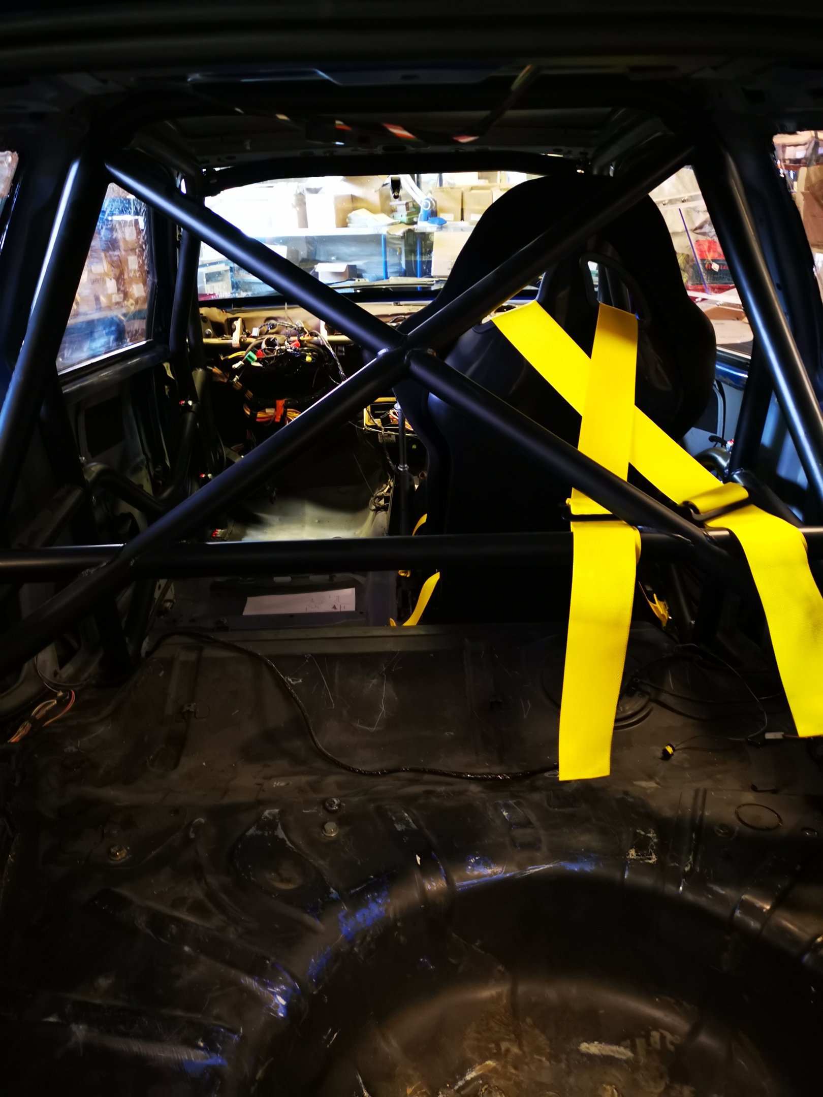

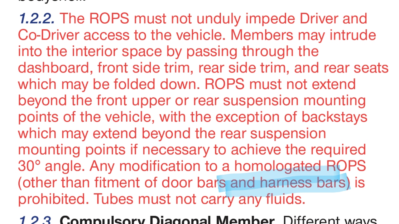

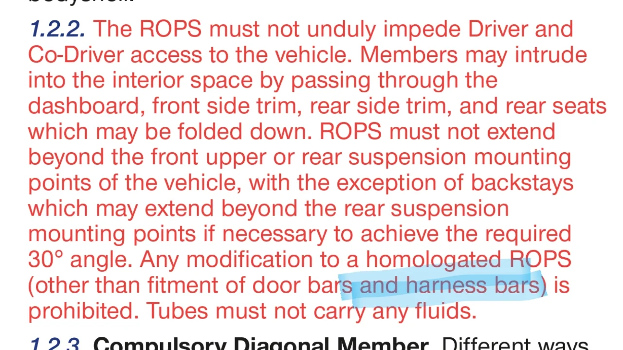

They replied yesterday saying they can't move the harness bar due to homologation.
Crap that as I don't like the diagonals cutting across where the harnesses go. Guess theres nothing else to do about it.

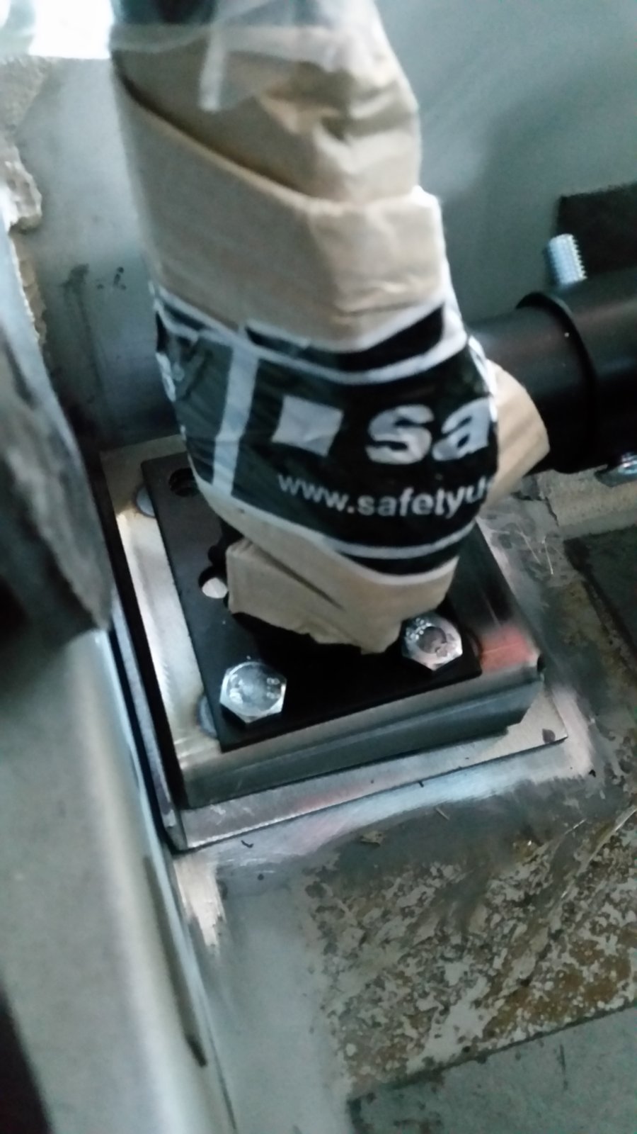

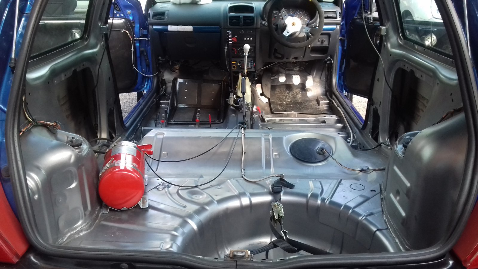

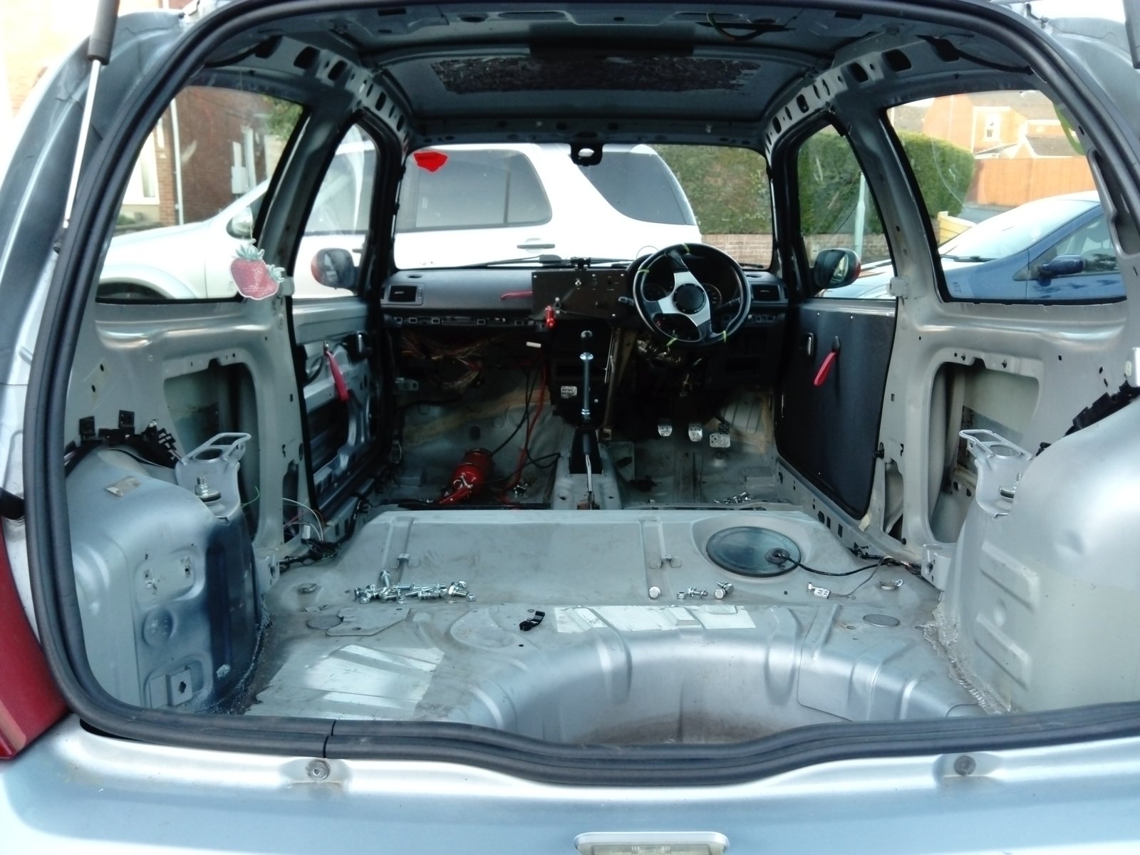

Is it just the front floor plates that have to be repositioned?
I think I am right in saying the rear plates have to be removed as well because the new cage has an extra plate underneath the mounting platform.

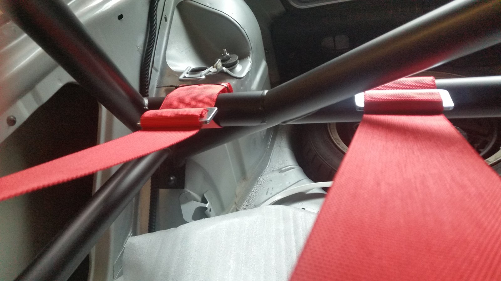

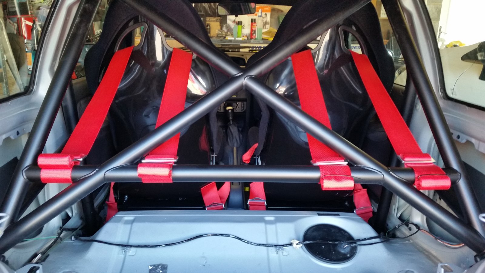

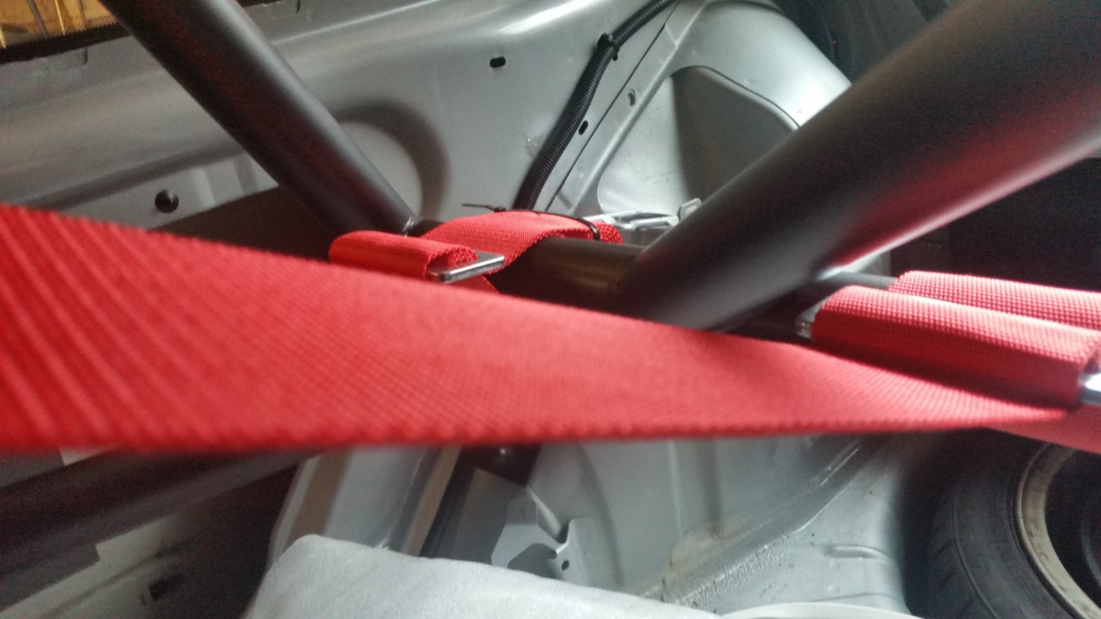

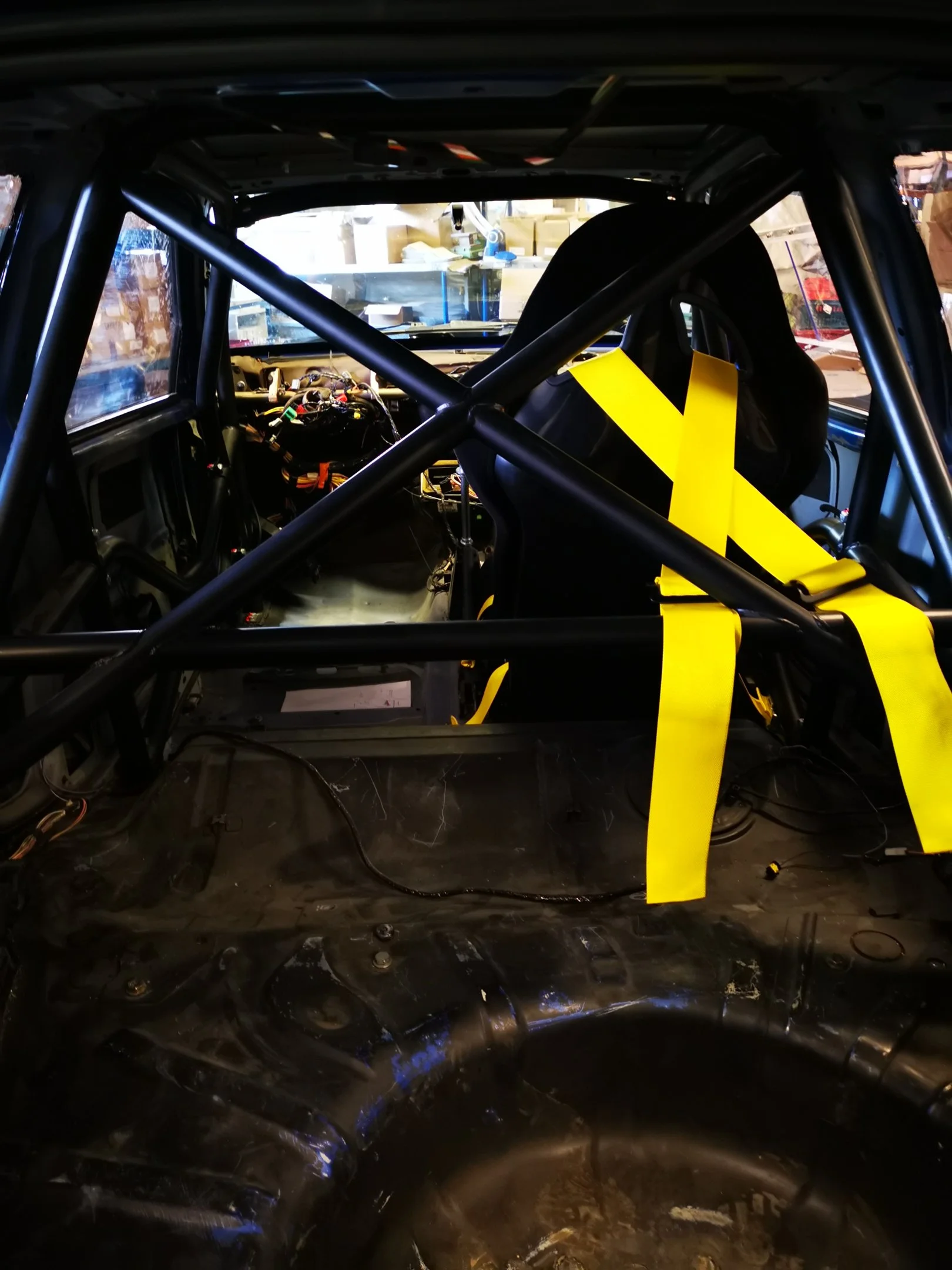

Paul I hope the photo show how the Harnesses fit.
Could you take a photo from directly behind the drivers seat.
The harnesses (when used with a Hans device) should be tapered together equally from the seat to the harness bar, as I would like them to not have the edges of the harness fouling the diagonal/welds.
I think the harnesses may have to be crossed over to maybe avoid them fouling.

I have also asked if I could have the harness bar at the same height as my original cage so that my harnesses don't get fouled by the diagonals.
My car looks naked now
Did they accept the request for the harness bar, as I'll be requesting the same? Cheers
I've asked @markfishy and they can't adjust the harness bar.
EDIT ..... Just seen someone has also confirmed this. Ignore me !

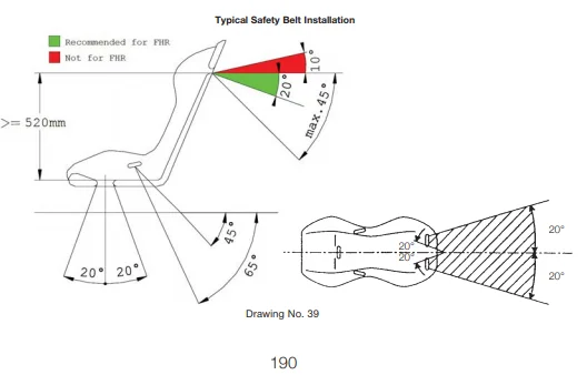

Sorry to bump an old thread, how did people get on with the R022 cage with when running a HANS?

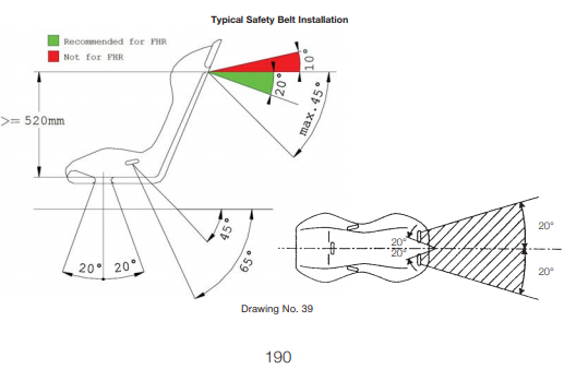

I sent some pics to a scrutineer last week and he commented saying the harness bar looks to low and it will fail its logbook if its above 10 degrees. I rang the MSA technical department and they tell me up to 20 degrees is absolutely fine with a HANS.
Still not bloody sure.
I have measured mine with a protractor from the harness bar to where it goes through the seat best I can and seems 18 degrees.
Mines been fine @donnylad, had no issue in scrutineering whatsoever. It's comfortable (well as comfortable as a HANS can be) and arguably easier to get my harness sitting right than it was with the old cage
