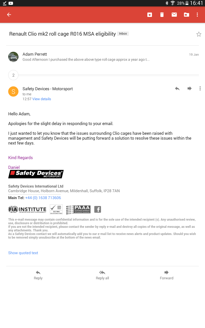

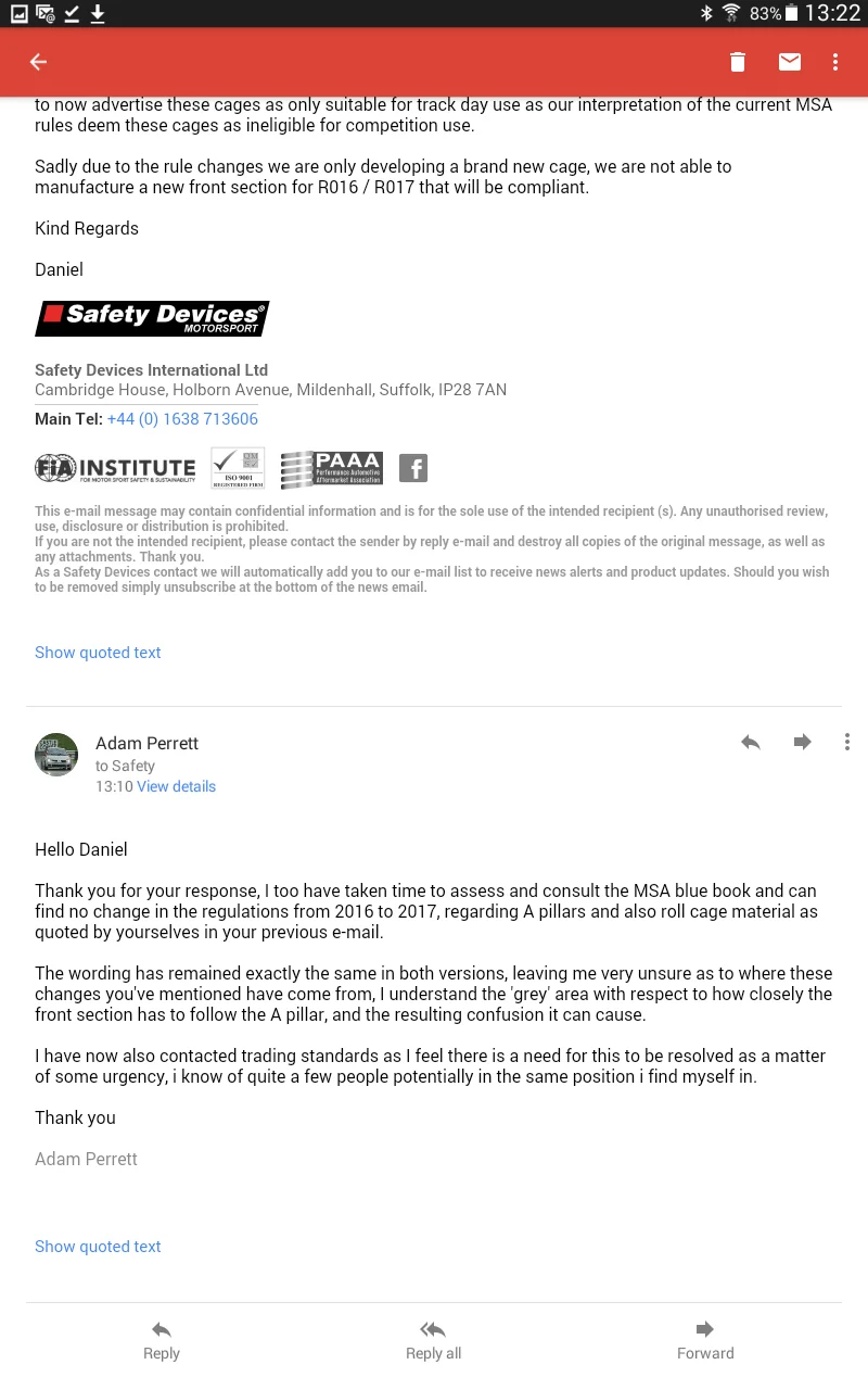

Trading standards
And conversation to SD in full, awaiting a response still

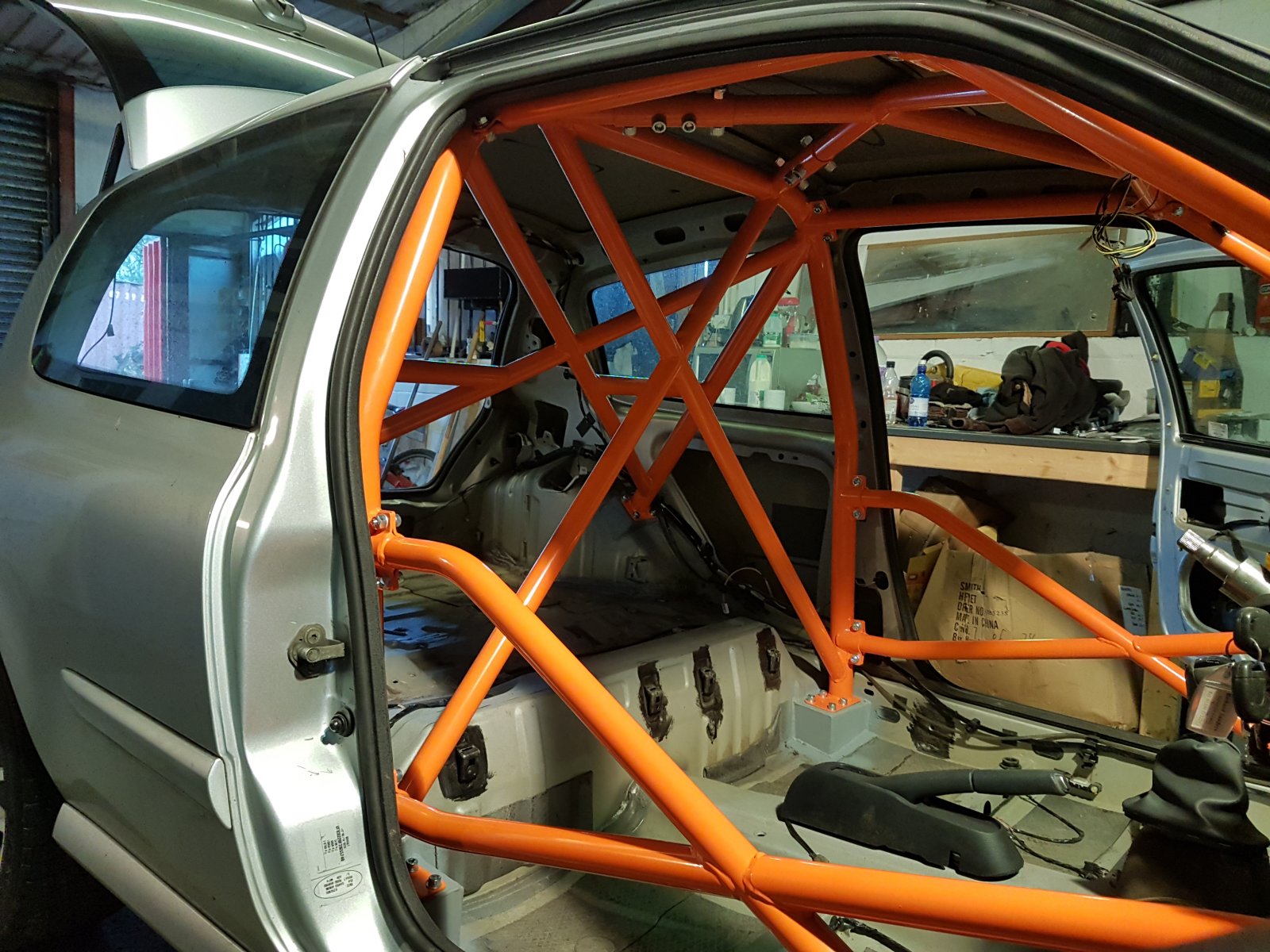

Theres an easy fix to non Homologated cages gents. The wording is:
The front leg of the front rollbar or a lateral rollbar must be straight, or if it is not possible, must follow the windscreen pillars and have only one bend unless a windscreen pillar reinforcement [1.3.5(e)] is fitted.
They key to that is the first line - must be straight. Simply get a bar welded to comply with section 1.3.5 E (diagram K62)
Windscreen Pillar Reinforcement: A tube the upper end of which must be less than 100mm from the junction between the front (lateral) rollbar and the longitudinal (transversal)
member and the lower end less than 100mm from the front mounting foot of the front (lateral) rollbar,
as shown in drawing K62. The tube may be bent on condition that it is straight in side view and that the angle of the bend does not exceed 20°.

Have tonwonder whether the words trading and standards have had anything to do with this?

As per the link below? before committing to such work i would be having a scrutineer double check that the below amendment would suffice
http://www.customcages.co.uk/news-room/msa-rule-changes-and-update-kits
i am not convinced that is the solution as the front leg still does not follow the windscreen pillar
The rule is it must be straight OR follow the line of the screen, so by making it straight the distance from screen is no longer relevant.
This is what the mk3 cages do.

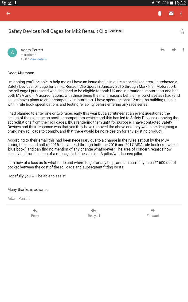

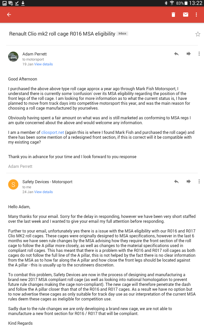

As per the extract below, as I understand it the cage has never complied due to not following the A pillar
loggyboy
If it has a homologation certificate loke shown earlier in this thread then it doesn't need to comply with blue book regs, regardless of any changes. A tested, certificated and approved cage is different to one that is built to comply with the blu book. This has come up a lot on the Locost series also in recent months. Is your cage certificated (with label and documents)?

How old is the cage? The certification rules changed in 2003. Before 2003 a manufacturer could certify their own cages, after that they had to be independently tested, so it could be a very early cage that was certified, where as after 2003 most manufacturers changed to use blue book standards as independent testing was expensive.
  Clio 172 Merc ML55
Its only a year old :(, but your post answers my confusion and explains why all of this has come to light

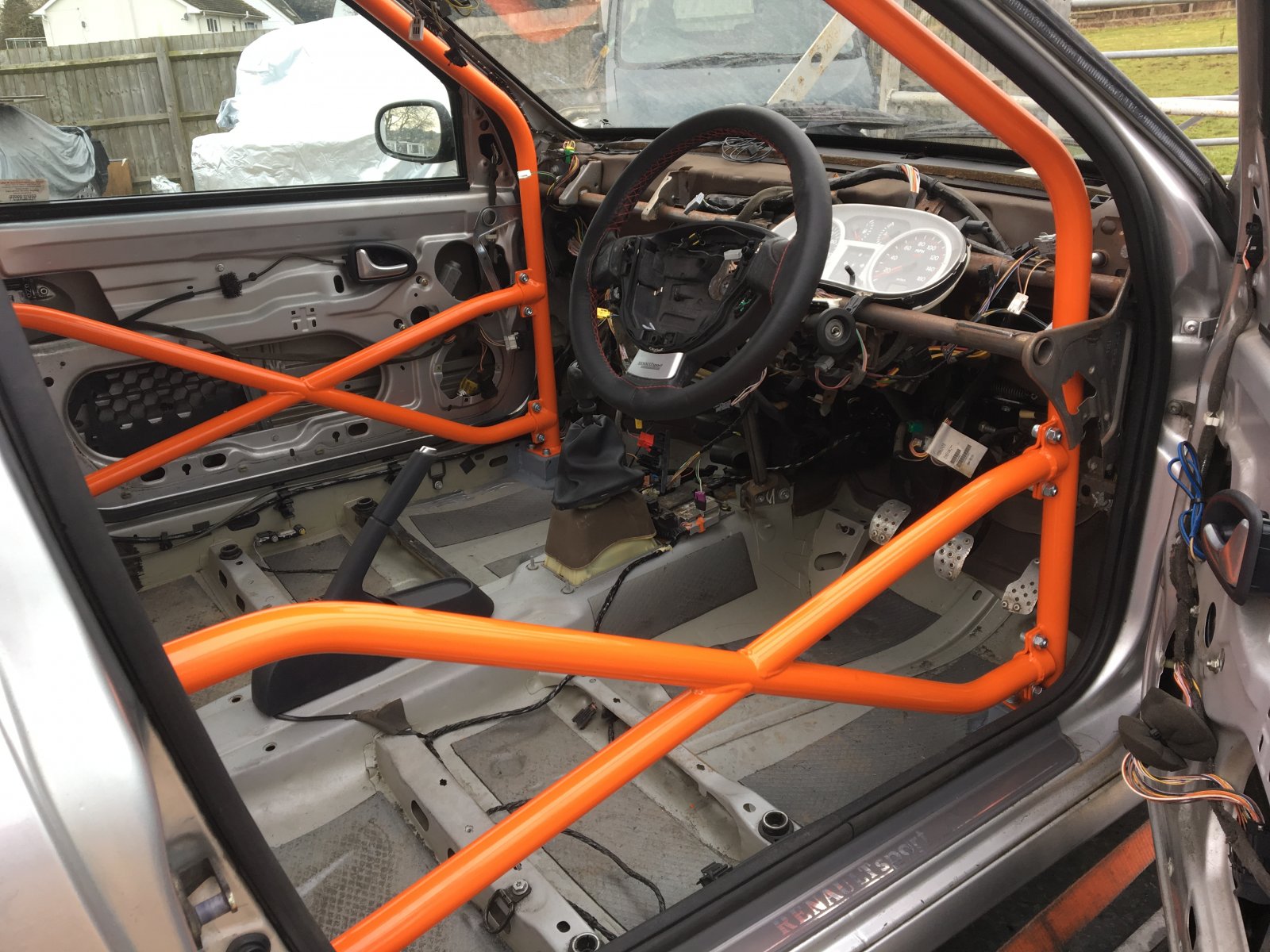

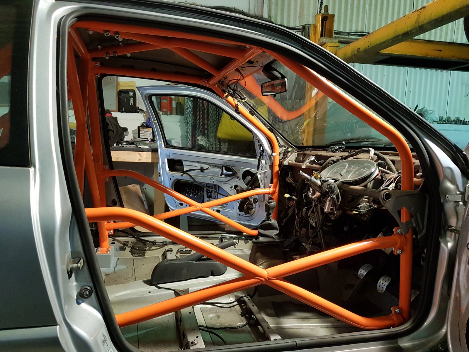

View attachment 177510 View attachment 177511
Nice looking cages mate. What make are they? Look very similar to safety devices but obviously through the dash.....attachment brackets from rear cage to front section appear identical even so I'm guessing could be easy for you to produce the front section to go onto a safety devices cage? Might be a market for you there :)
  clio 182
Nice looking cages mate. What make are they? Look very similar to safety devices but obviously through the dash.....attachment brackets from rear cage to front section appear identical even so I'm guessing could be easy for you to produce the front section to go onto a safety devices cage? Might be a market for you there :smile:
I make them pal so they're my make :tongueclosed:
Dear All,
We have recently received correspondence from members of the ClioSport forum, and felt it worthwhile responding directly to clarify the current situation and our intentions moving forward.
Firstly, to provide a little background information, the R017 6-point bolt in roll cage was originally developed in the early 2000's in conjunction with Mark Fish Motorsport. The brief for the roll cage was to be compliant with regulations while intruding as little as possible into the existing trim and dashboard. This approach was common place at the time and followed widely accepted interpretation, specifically with regards to positioning of front legs in relation to the windscreen pillar.
However, over the past couple of years, interpretation of the regulation has changed - recently brought to the fore with the R017 cage. We are aware of issues caused to some customers, but as importantly, the potential inconvenience for others if they were to encounter issues when scrutineering during a race weekend.
As many of you will know, we have just completed the development of an alternative Mk2 Clio roll cage (R022), which is designed to MSA specification and will be Nationally Homologated to prevent any future compliance issues. The cage is designed for cars with no trim to provide an improved fit, and penetrates the dashboard to follow the windscreen profile. The roll cage includes windscreen reinforcement bars, as well as optional cross door bars, tunnel brace, lower backstays, cross diagonals and harness bars. A general assembly drawing will be added to our website soon, but in the meantime, we have uploaded a photo of the pattern for illustration purposes.

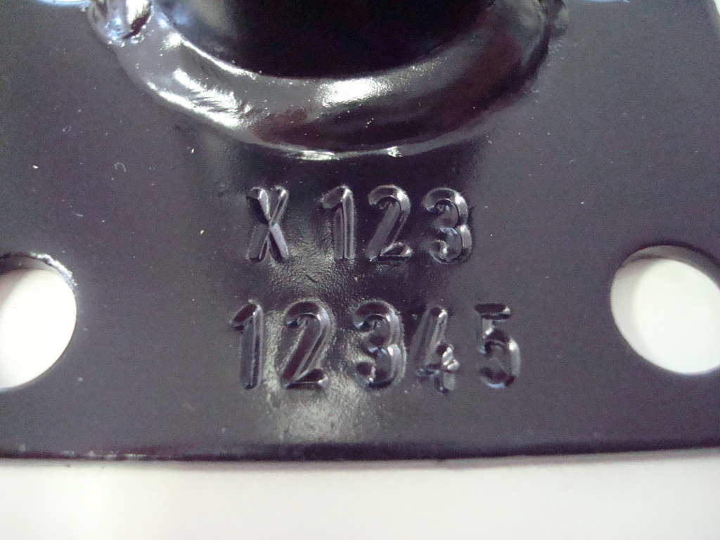

Sales order number which is stamped into the footplate of the roll cage (example below)
Could you confirm why SD felt the need to add the reinforcement bars as well as adjusting to suit the windscreen?
Pauleds
  Merc Dueliner sport
This is because you are only allowed 1 bend on the front leg to msa regs, unless it has the extra supports like SD have done.
We included the windscreen reinforcement bars to provide additional strength, given the front legs are now at a steeper angle. Although not required by regulations in this instance, it's our standard practice for new developments.
