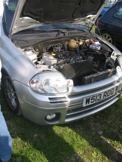

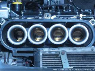

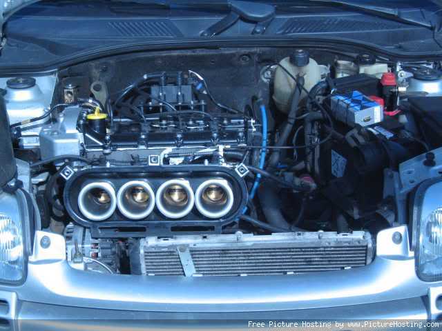

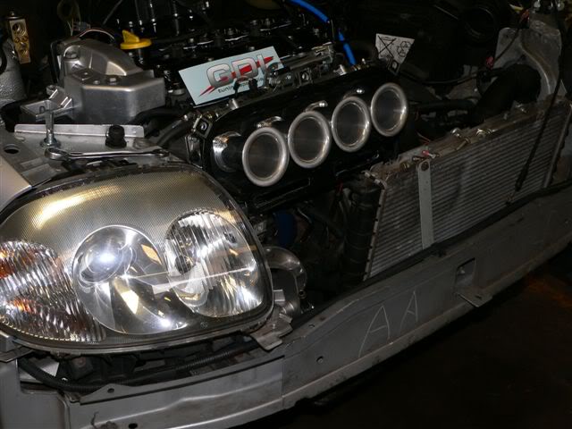

yeah mines the Jenvey kit mate, there are other ones, like the Webber, but Jenvey's proven and tested to produce power and reliability. Someone's developing direct to head bodies for a Clio, but they wont be here anytime soon and would imagine the conversion process would take over 6 months plus.
I'll speak to Andy and get all the pics from when it was done, as he did a step by step in pictures of it all. Here's a couple of samples though:
