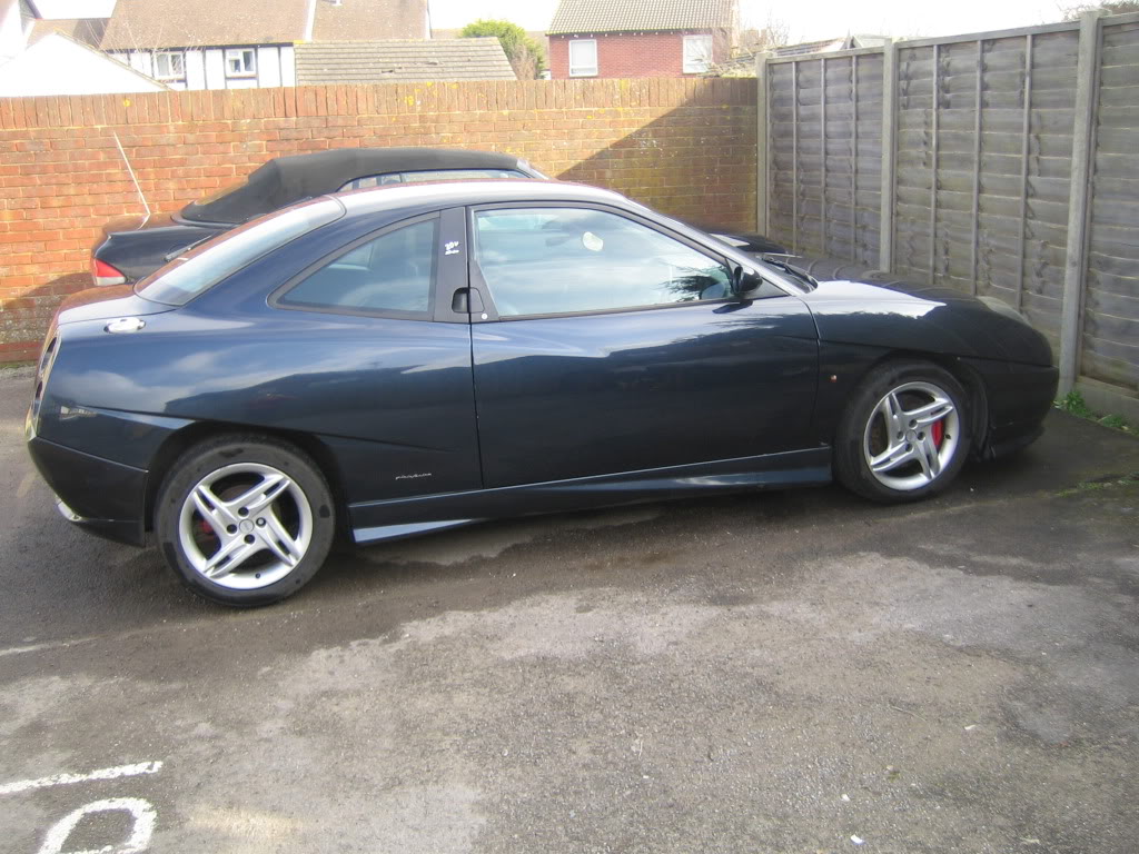

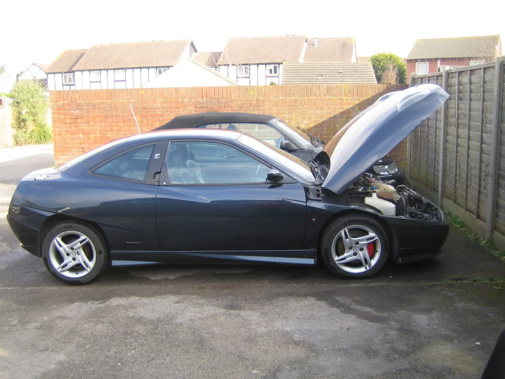

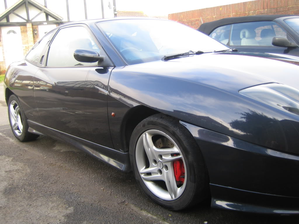

First off some clean car pics

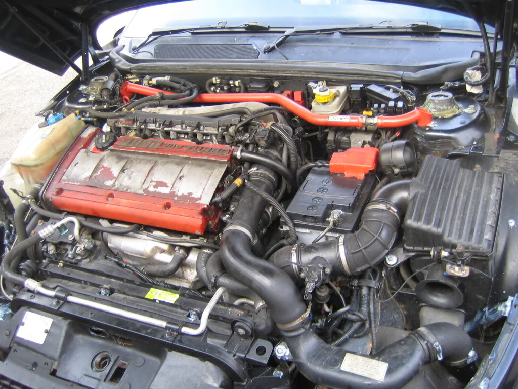

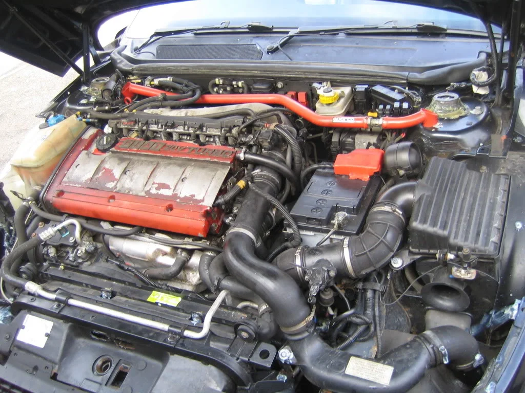

First up was a Bailey Re circulating dump valve as the old bosh one was leaking . This was done with a BMC panel air filter.

The remap showed that the engine compression was low on all cylinders and that cam timing was the most likely cause. Layton also said that there was a knocking coming from the offside .
Next was to go back to FC performance for a cambelt change with all other belts water pump etc. A new thermostat was fitted along with a new injector as no 2 was dead . The knocking turned out to be a collapsed shock and a broken track rod . With all this done the compression was back up to 155 psi and cam timing was the cause of this as it was out on the crank , inlet and exhaust by some way . The last thing was to tweak the remap and all was well and power was back as it should be.

Looks very tidy! Although I can't believe how dated they look now. I remember the first one I ever saw and nearly creamedmy pants. A bright blue 20vT.
I've owned 3 and all of them the wheels were fubar'd. Have you had yours refurb'd? They look really tidy.

No just cleaned them . They will need a refurb at some point mind . The colour is ink black but looks just like dark blue .
