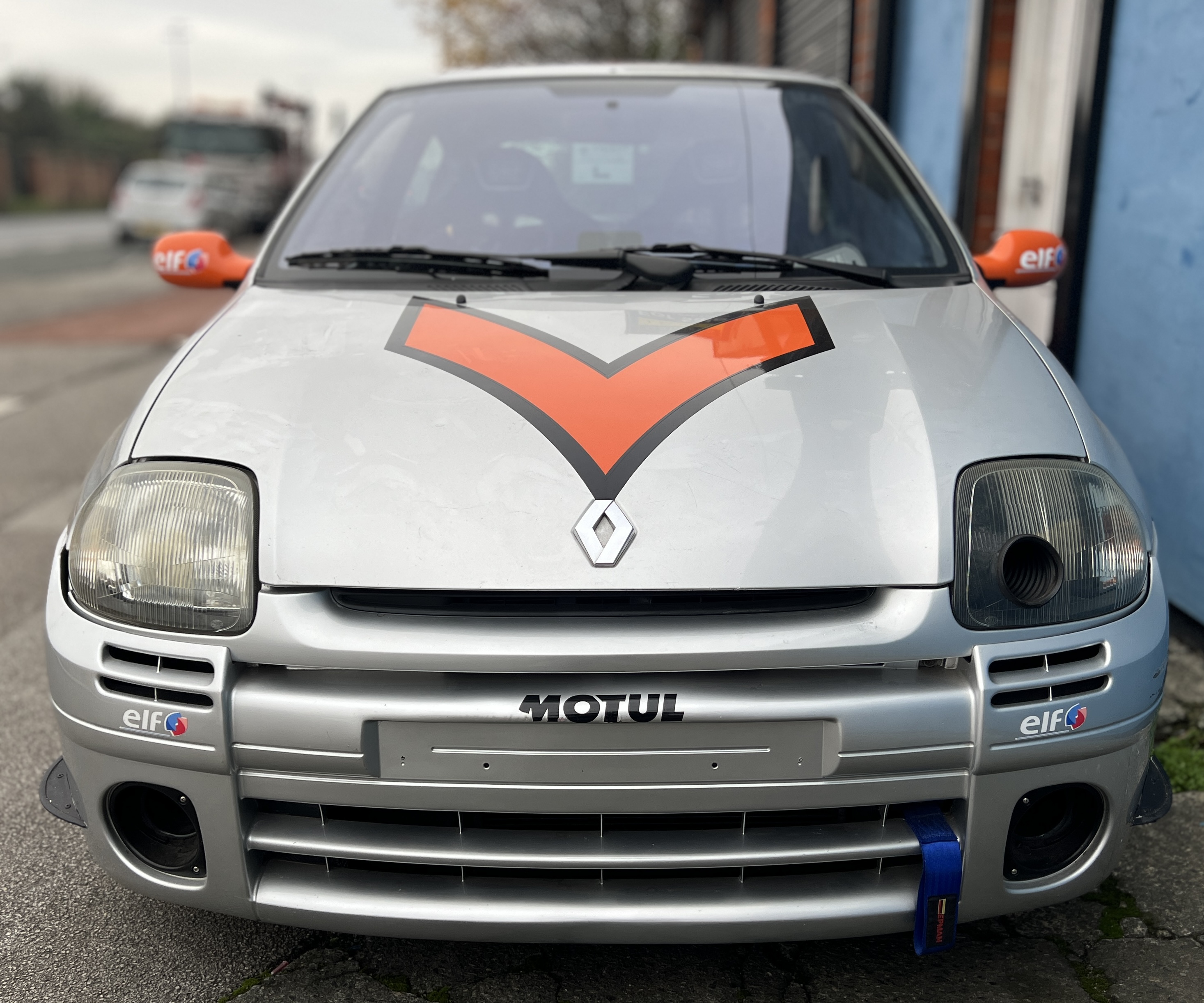

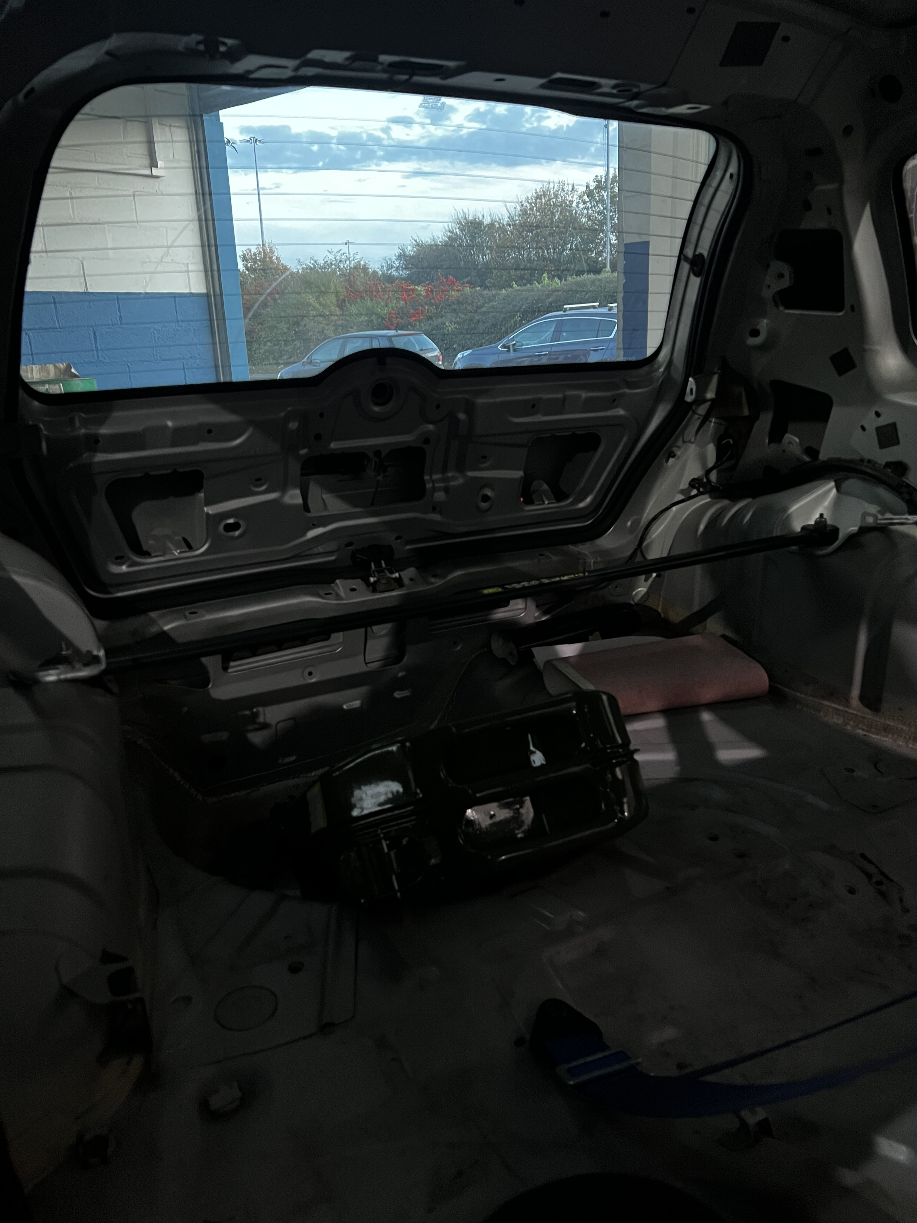

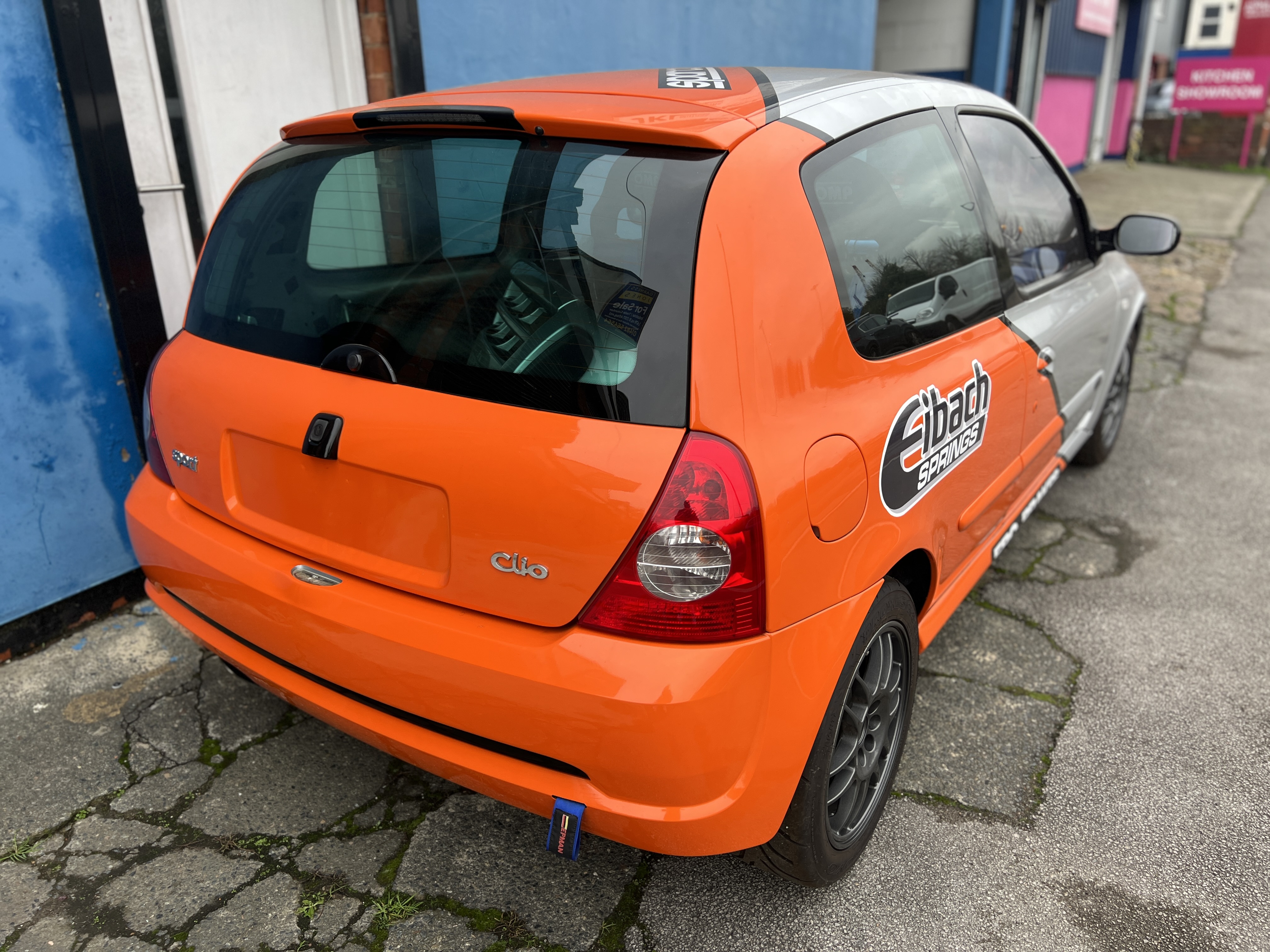

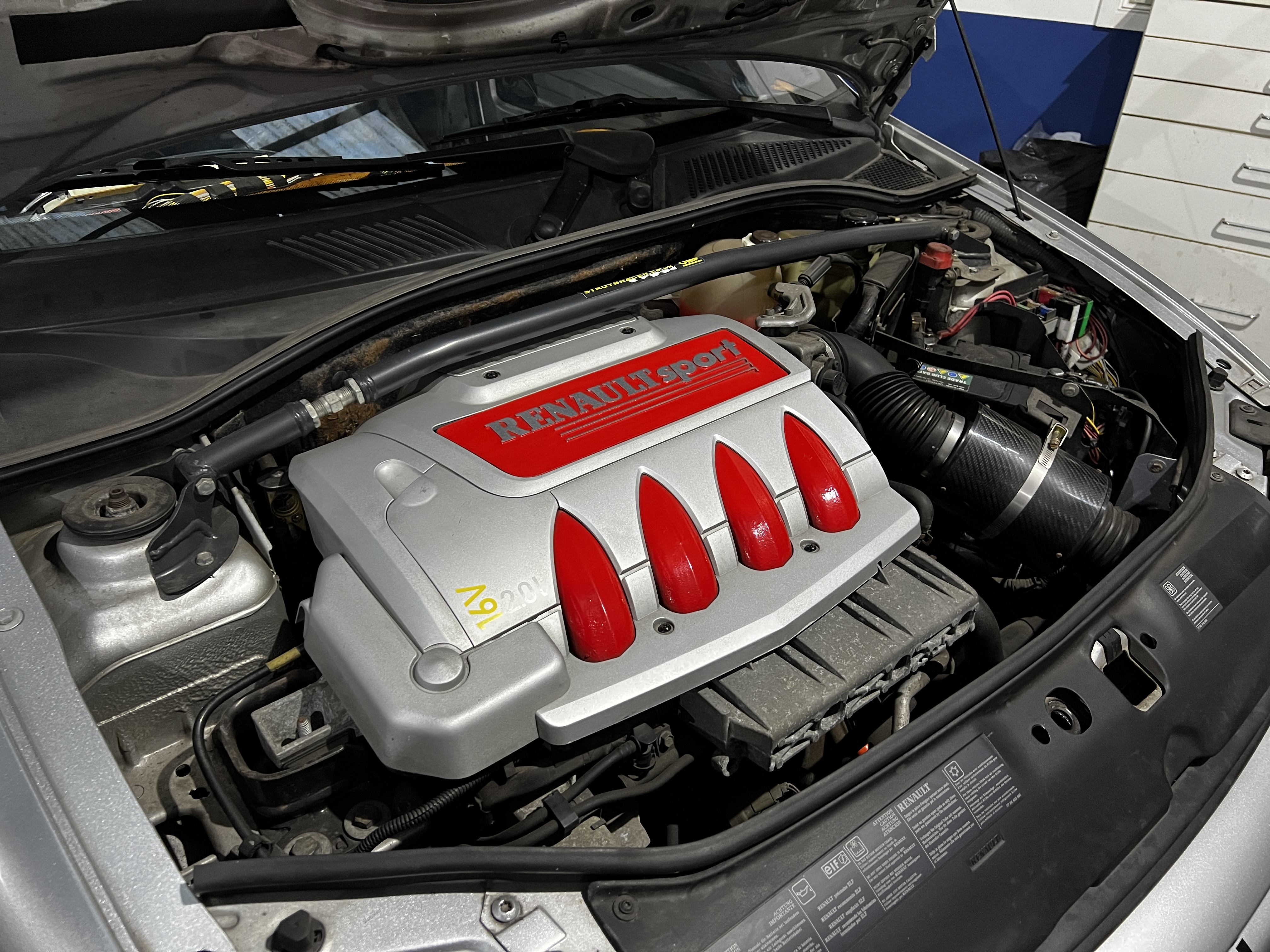

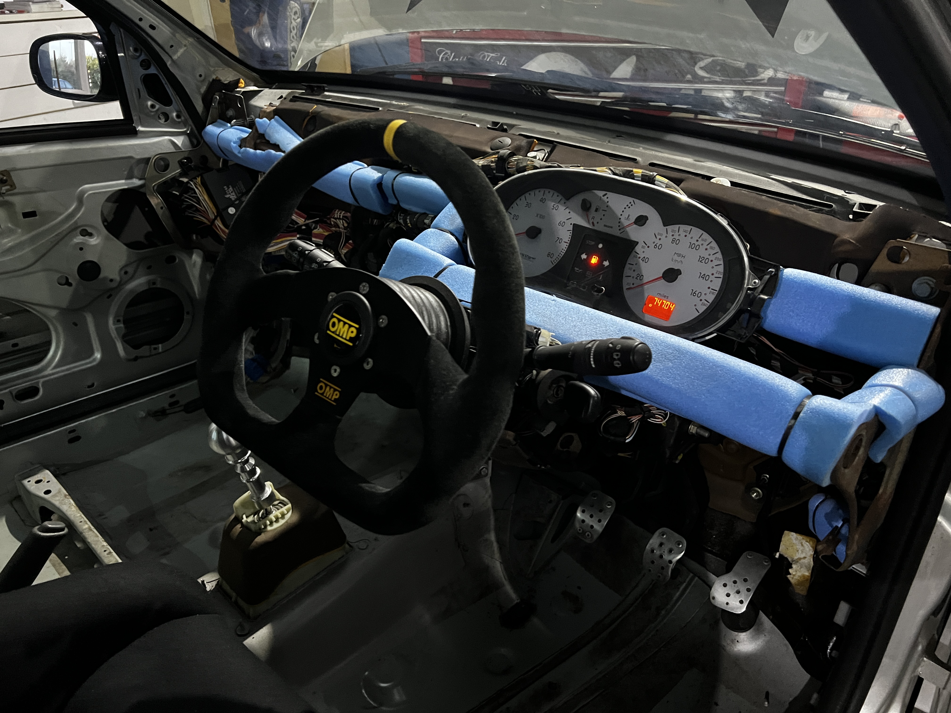

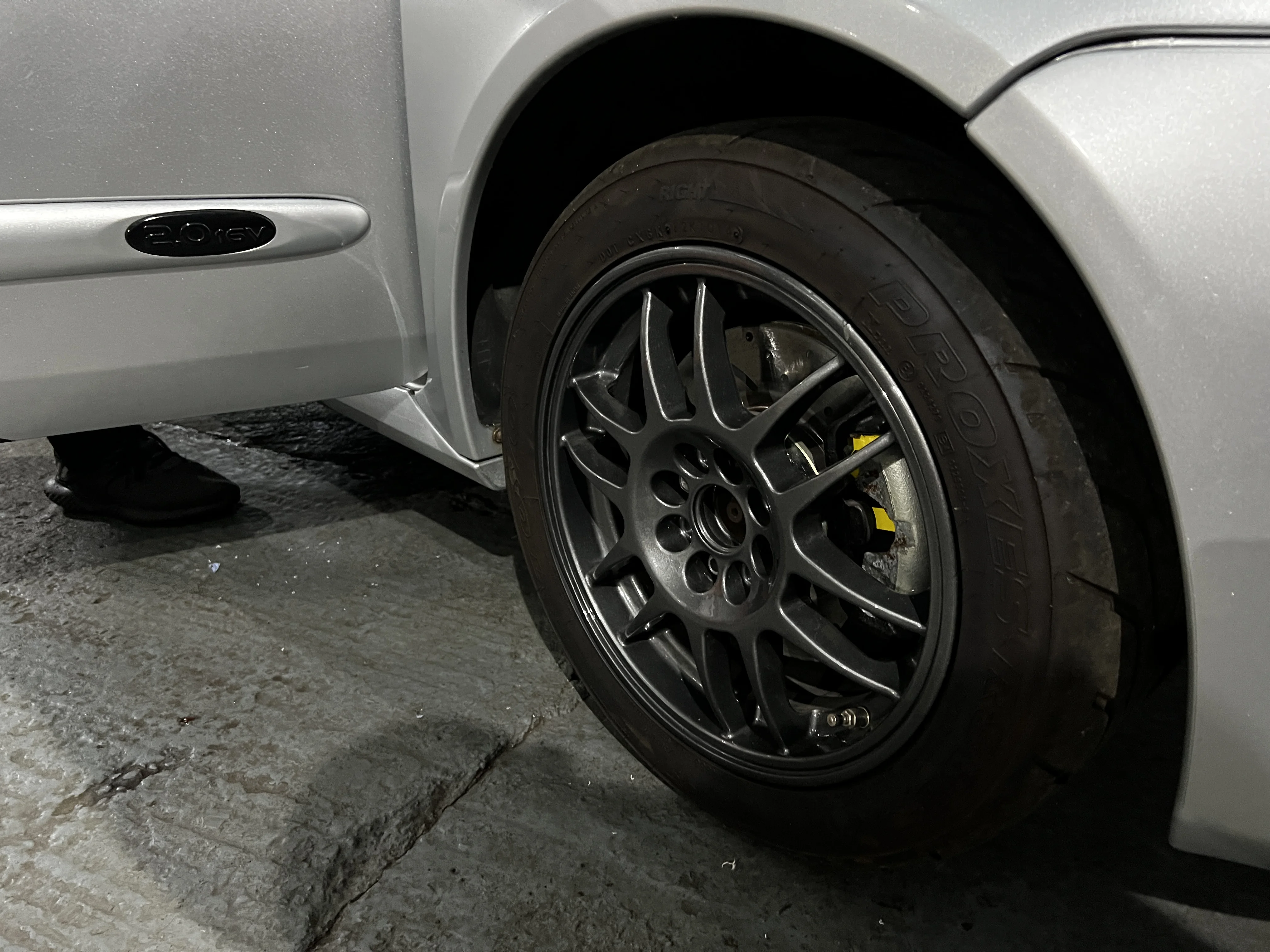

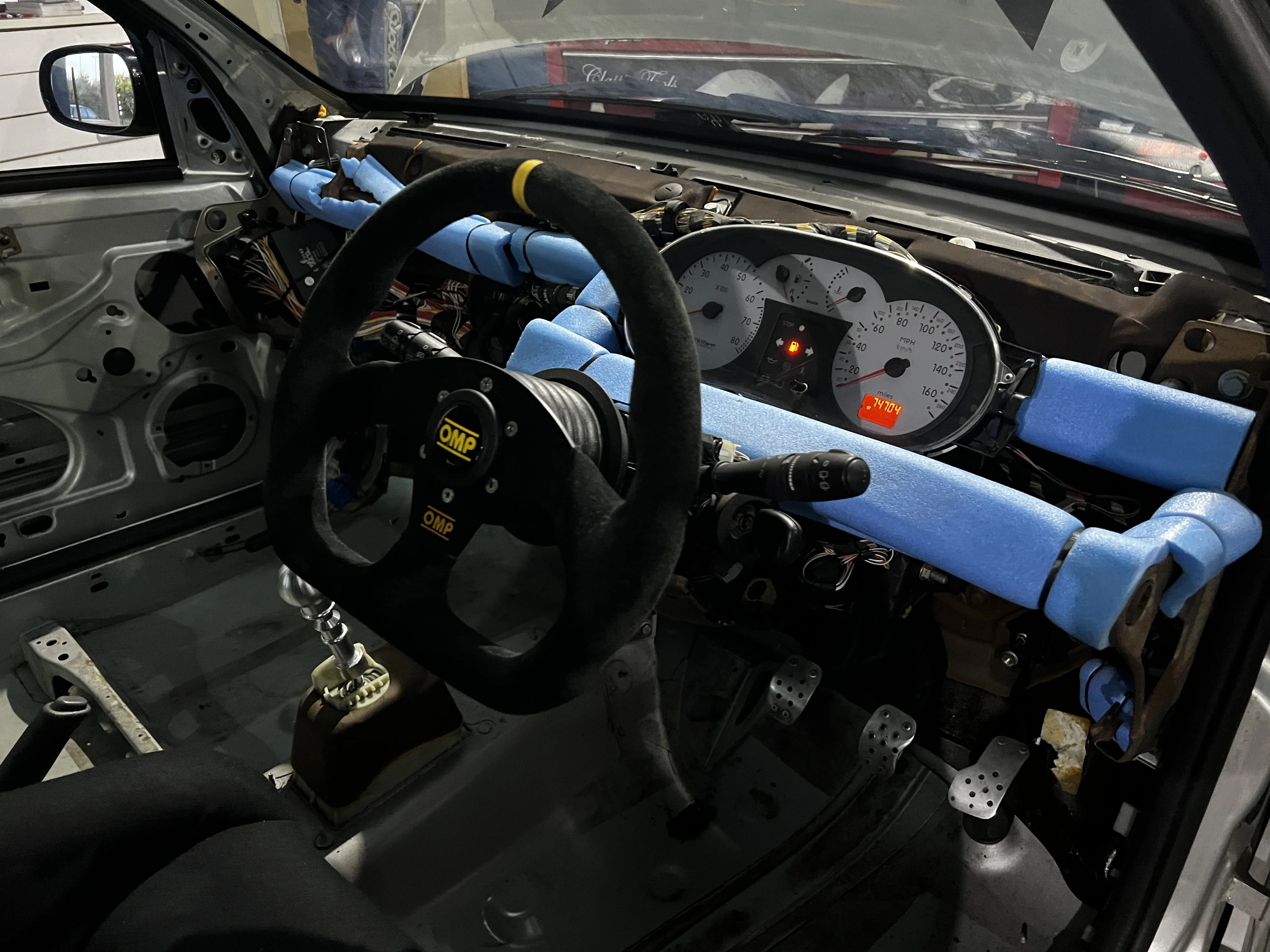

Some pics of the car.

so with that much power and weight reduction sorted the next thing is to look at suspension, i've not seen the eibach adjustable dampers but if you like them and they're stiff enough for you leave them be, if not a good set of coilovers from ast, avo, bc racing. look at combing this with a roll centre and bump steer kit. Theres three options now i think. Pure motorsport, northloop kit or pro am racing. Also adding a rear anti roll bar is great. Then pure motorsport sells wishbone strengthing and bearing kit and the same for the rear beam.
Thank you - anti roll bar and strut brace are the same thing, no? Forgive my ignorance. It’s got both front and rear strut braces (across the top of the dampers). The suspension is stiff enough, however I think I need to play with the ride height as it’s riding quite high after everything has been stripped out, for a better centre of gravity.
No rear anti roll bar fits underneath and depending on which kit either bolts to the bottom of the rear dampers or the beam mounting points.
Cool thank you - consider me educated! I’ll look into that. It’s already a lot of fun on the circuit - just looking at ways that we can make it more so. Don’t need a blown, 250bhp monster - would rather have something that’s fun in the corners and can hold its own on the straight bits without scaring the bejesus out of me! 🤣 So I think handling improvements seem to be the way forward for the time being.
Just booked the car in to get it lowered a little before we go to Blyton Park in a couple of weeks. Handily, the guy we bought it from is a mechanic (30 yrs in the trade), so knows his onions and is pleased to still be involved with the car.
