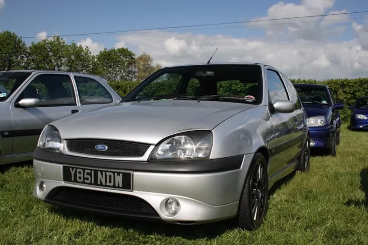

So at the back end of last year I decided to take the Clio 172 off track day duties, I sold some of the track focus parts on, had the paintwork sorted, bought a set of Turini’s.
I still had an itch I needed to scratch, trackday. So the hunt was on for a new track day car, I had seen a few things I had liked including a 106 XSI on ITB’s, I kept looking at Elise’s but they was a bit out of budget.

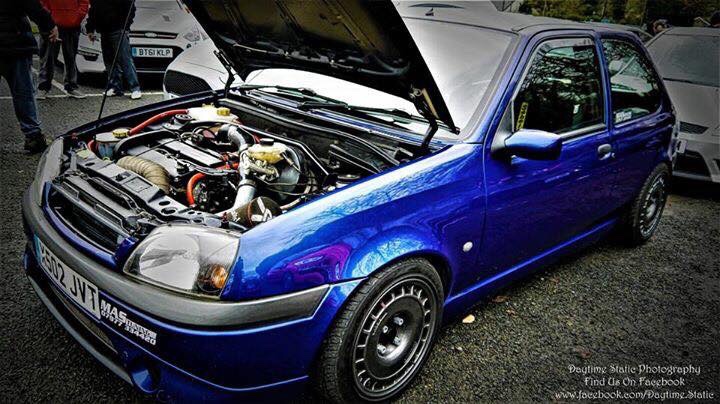

Then this came up for sale, Ford Fiesta Zetec S with a Focus RS Engine. I was intrigued, so I went to view it with my eyes wide open.
The car needed some work, but I was happy enough with the car in it’s current state. So handed over some cash and it was mine.
Basic spec of the car;
2000 Ford Fiesta Zetec S
Focus RS 2.0 Turbo
Approx 300bhp

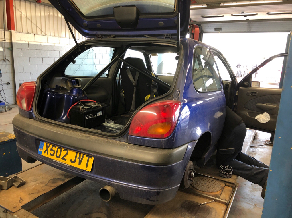

Plans for the car, included sorting out the sketchy interior, wasn’t happy with any of it really. Seats, Harnesses, cage, steering wheel.
Brakes, very noisey all the time. Rust, rear arches showing signs of rust and a little bit on the boot lid.

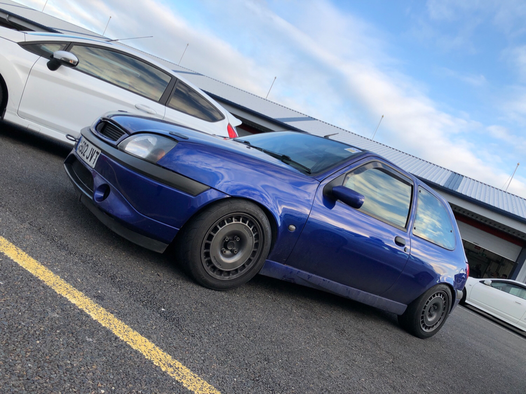

First things first, collected the car.

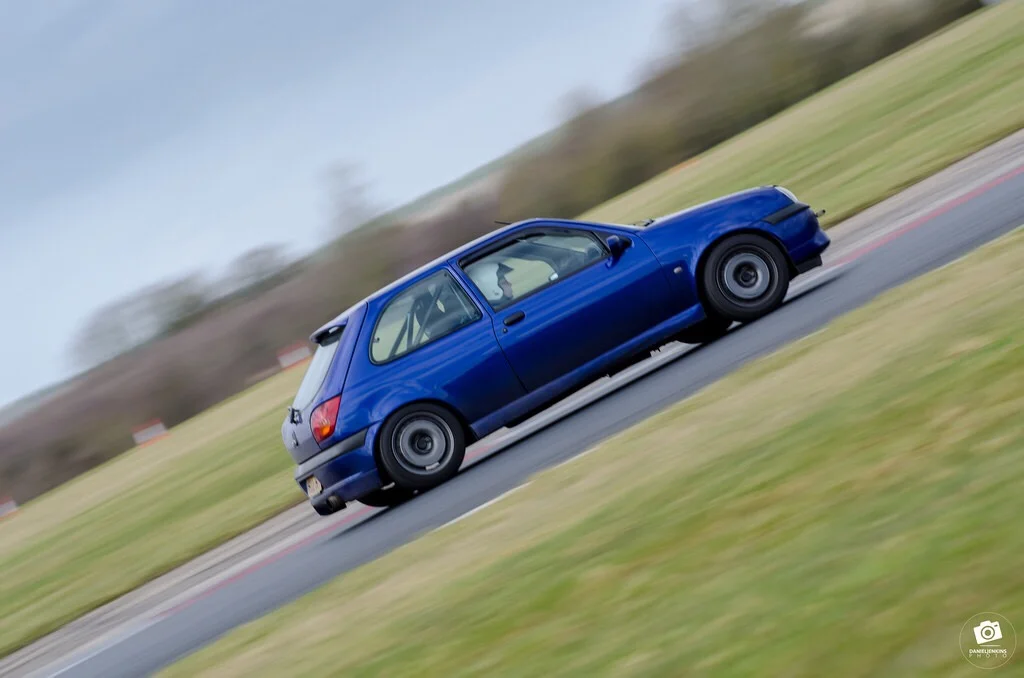

God it’s a riot, it’s completely unusable on the road but it’s a proper riot. Suspension is stiff, MPG is atrocious, and it makes some hilarious noises on overrun. Pops and Bangs, that a ktec map would be proud off.
It was raining on my way home, and it was spinning up in 5th when on boost. I hadn’t really previously experienced anything like it before, the Quaife ATB RS diff trying to keep things in check.
Overall though, over the moon with my purchase.

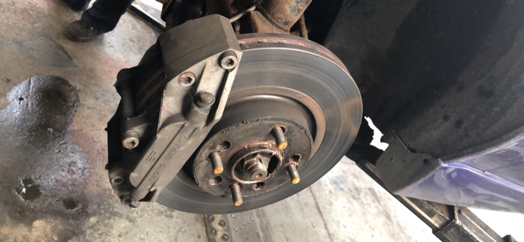

Quickly I wanted the brakes changing they had Mintex M1155 pads in there, on AP four pot calipers and 305mm brake discs, I spoke to George @ RTR and ordered a set of DS1.11’s. I was happy with the rest of the braking system.

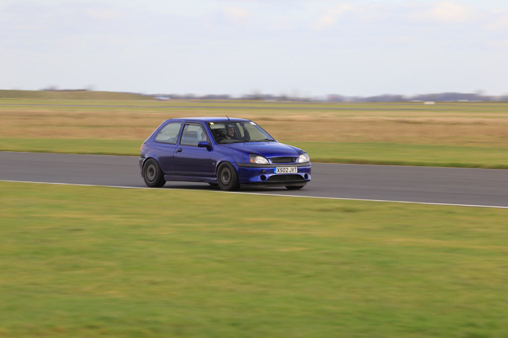

On to the first track day, at Bedford in February, a few weeks after buying the car.
Started the day, with no boost, the pin that held the Forge actuator on, had fell off, so used some lockwire and secured the actuator back on, car was still pulling about 1.6bar of boost, so all good.
Car performed well on the GT circuit, a 6/7 lap session was using about a 1/4 of a tank of fuel, I don’t what to work out the MPG. [emoji23]
The car was also suffering with fuel starvation on left hand bends with under 3/4’s of a tank of fuel. No massive drama at this point, just had to keep the tank full.
All in all, a really good day, worked out some areas that needed improvement and the car drove and handled the power really well. The chassis didn’t feel like it couldn’t cope with 3 times the power it left the factory with.

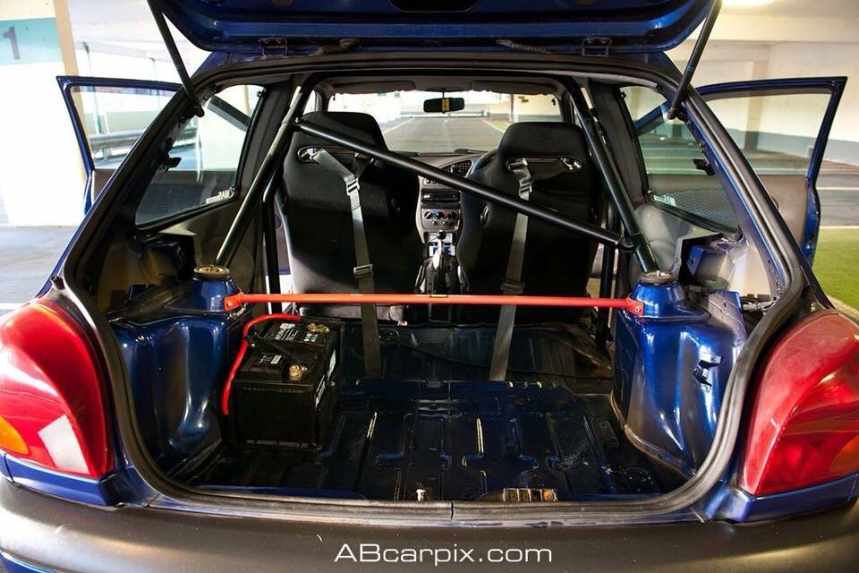

So bit of an update from when I decided to strip the interior.

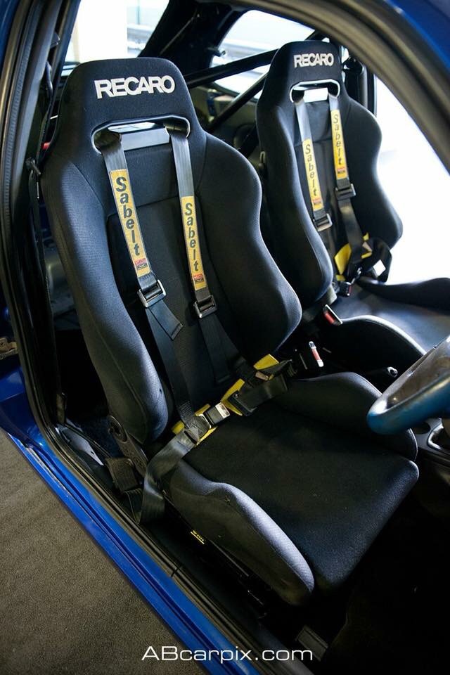

I wasn’t at all happy with the interior on the car, the recaro’s seats were not ideal - they weren’t particularly safe. The rollcage was a show cage and again really not up the standard I wanted. The less said about the harnesses - the better.
The plan was simple, strip everything back to bare bones, paint the interior grey, get some bucket seats, a proper welded in cage, some proper harnesses. I wanted the car to be functional, clean and most importantly safe.

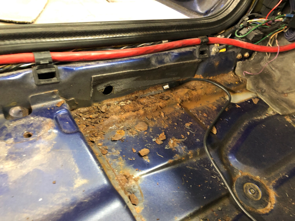

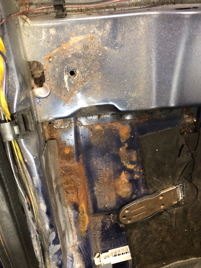

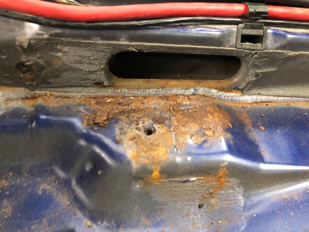

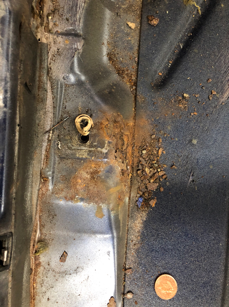

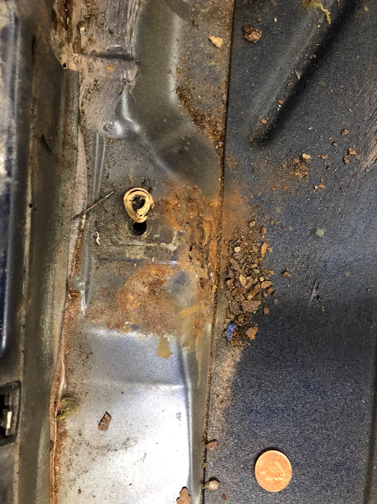

So everything was coming out, and carpets were lifted. What was underneath was rust, some more rust and holes.
The worst of it too.
I was gutted when I found this lurking under the carpet. The ground underneath visible in places, same as anything is repairable so onwards we must go!

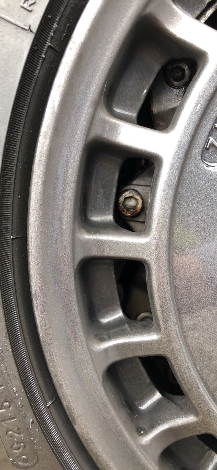

I did try a set of OZ Superleggera’s, but they didn’t offer enough clearance and the brakes caught on the wheel weights!

All is well now thankfully. Was all patched up when cage was fitted.
