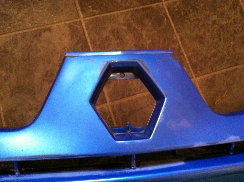

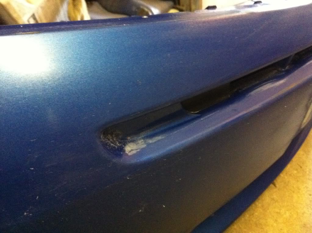

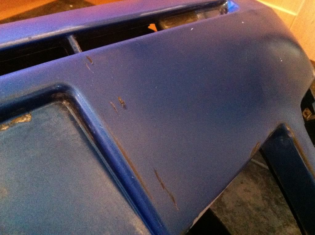

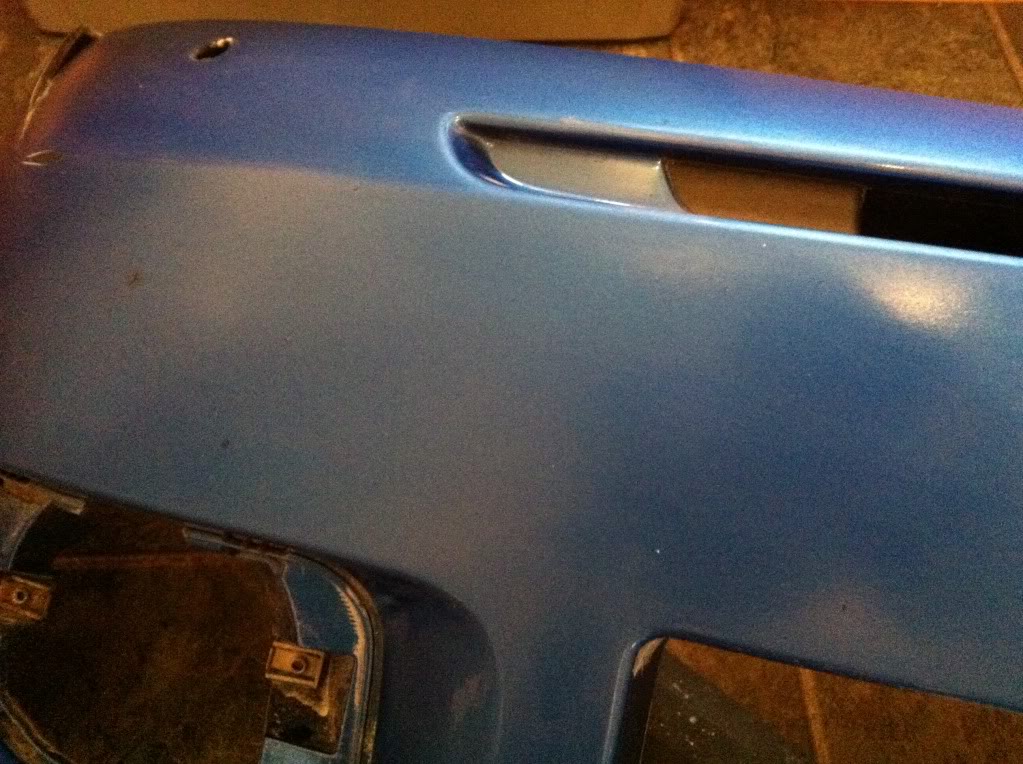

But heres some photos of where the bumpers at, I've tool the majority of the clearcoat and 'gloss' off of the paint (I read on here that you need a dull/matte finish)... I got the diamond housing off with a pair of pliers because the bolts were seized somehow and I got the archliner off the same way.

is it the scratches to the right of the number plate bit you wanted to fill ? if so they far from need filler just a quick sand with 180 then a bit of high fill primer would sort that right out

There's more scratches, they're all around the diamond recess and next to the wings and on the bottom, I don't wanna sand them that far down for fear of making the bumper too thin. May be anal but Ive never done this before. And lol at rich

you made a bumper to thin ? jeeezz how far did you go with it lol ? there only light scratches tbh sanding would be fine

Lol dude, I'm aware I could sound thick but it was covered in fairly deep scratches. The majority of them are flush now. I don't wanna risk going too deep so to speak.

judgement on when to use filler and when not is something that comes with experience... you will be surprised at what you can actually get out of a bumper without going to far
