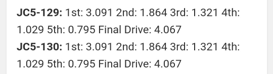

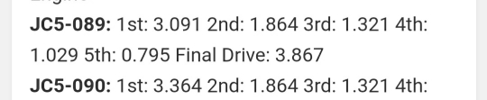

I think its possible that you have understood things a little wrong. The megane part of things will be the 5th gear. The final drive will refer to the crown and pinion gears. Now as i understand it the final drive ratio of a PH1JC5 089 gearbox is of a higher ratio to that of ANY ph2 JC5 129/130 gearbox. The actual 1st to 5th gears on all the JC5 *** gearboxes are all the same, its just the final drive in the 129/130 which is lower ratio than 089.
Sent from my SM-G977B using Tapatalk
Oh forgot to mention, the Megane 5th gear would change the ratio to 0.891. Hope this helps
