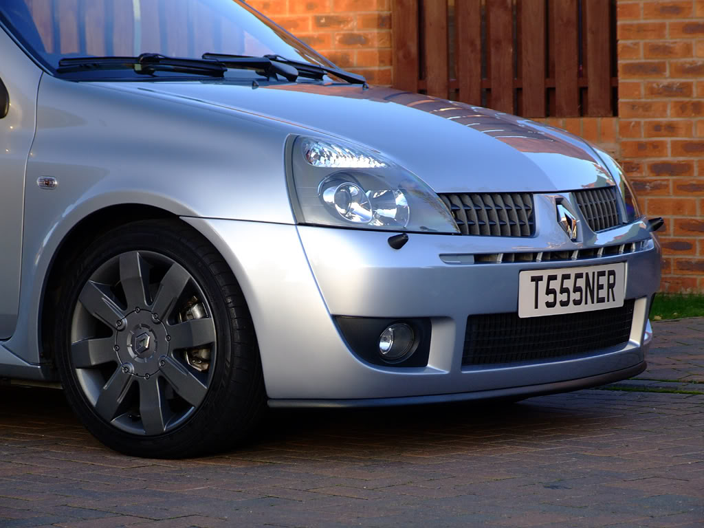

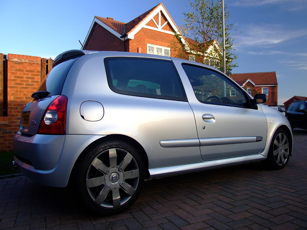

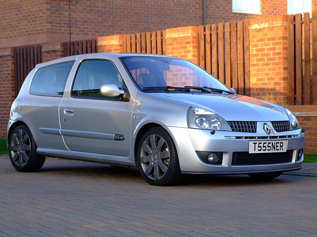

first we clayed the bonnet and wings as the rest of the car was in not bad shape and then clayed the roof
James used the bonnet as a tester to see what cut and which polishes to use
anyway he started while it was sunny but thank god we had cover then he finished when the sun was going down and heres a few i took and the better ones are what james took on his very tidy camera
The finised article
thanks again james:star:

Im well impressed with the results as it had some small scraches and there all gone now and its as smooth as glass

Wonder what the reason is for using what looks like a 4" spot pad on the roof and bonnet? I always use a 6" Unless its the pics making it look smaller. Looks tip top though!!! :) Fook doing it as a job, i HATE it!!!

Yeah. The usual way to do a clio (imo) would be to use the 4" pad on the wings, bumpstrips and below all round, boot and bumper. Bigger panels like bonnet, roof and above bump strips i'd use a 6" as it saves time. Just curious that all (might learn something lol)

Only seem to have pics of when we had the 4" spot pad on. Reason for that was getting rid of the local scratches that Adam pointed out. Some areas needed working on the bonnet and there was a six inch scratch on the roof which we did our best to reduce. Apart from a small witness mark on the roof one, the scratches to the front and rear wings were eradicated.:D
I personally think this is one of the best looking cars in the club. I couldnt believe the condition when I turned up, just shows how well Adams looked after it. The process helped get rid of the usual surface scratching from everyday driving and weekly washes.
Bonnet ending up looking like a mirror!
For those of you who want to know we used;
Sonus Green Clay
Megs Last Touch cut 70/30 with filtered water.
Menz IP on yellow pads
Menz Final Finish on white pads
Jeffs Acrylic Jett Trigger spray [gotta get myself some of this!!]
