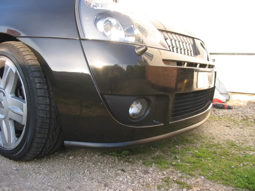

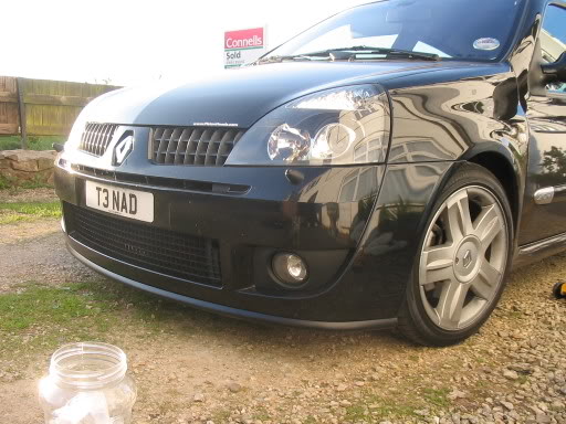

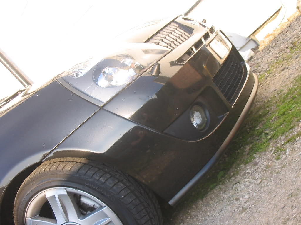

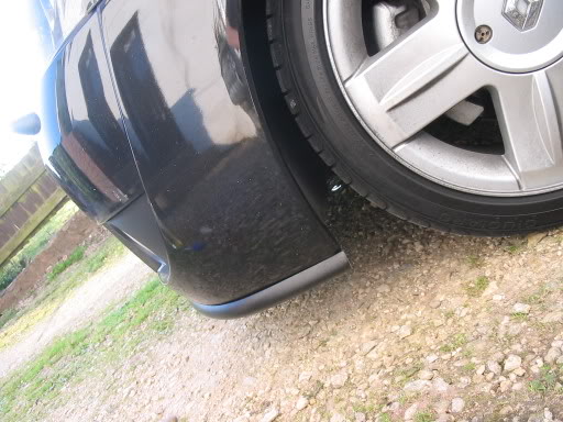

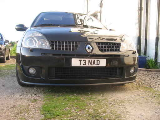

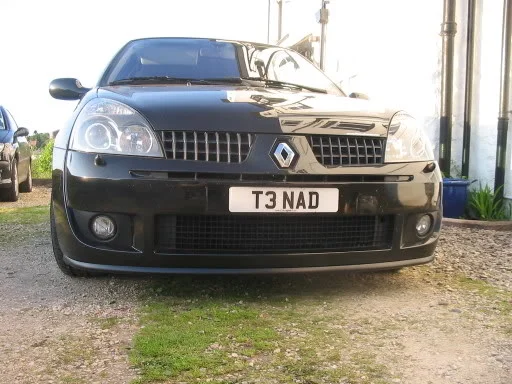

Finally....its on....and its the right way up! ;)
Car  No more clio's for me!
After 3 hours of fookin about with the splitter yesterday, trying to fit the damn thing up side down! :o Finally managed to sort it!
Looks fookin amazing...thanks to Craig172 ;)

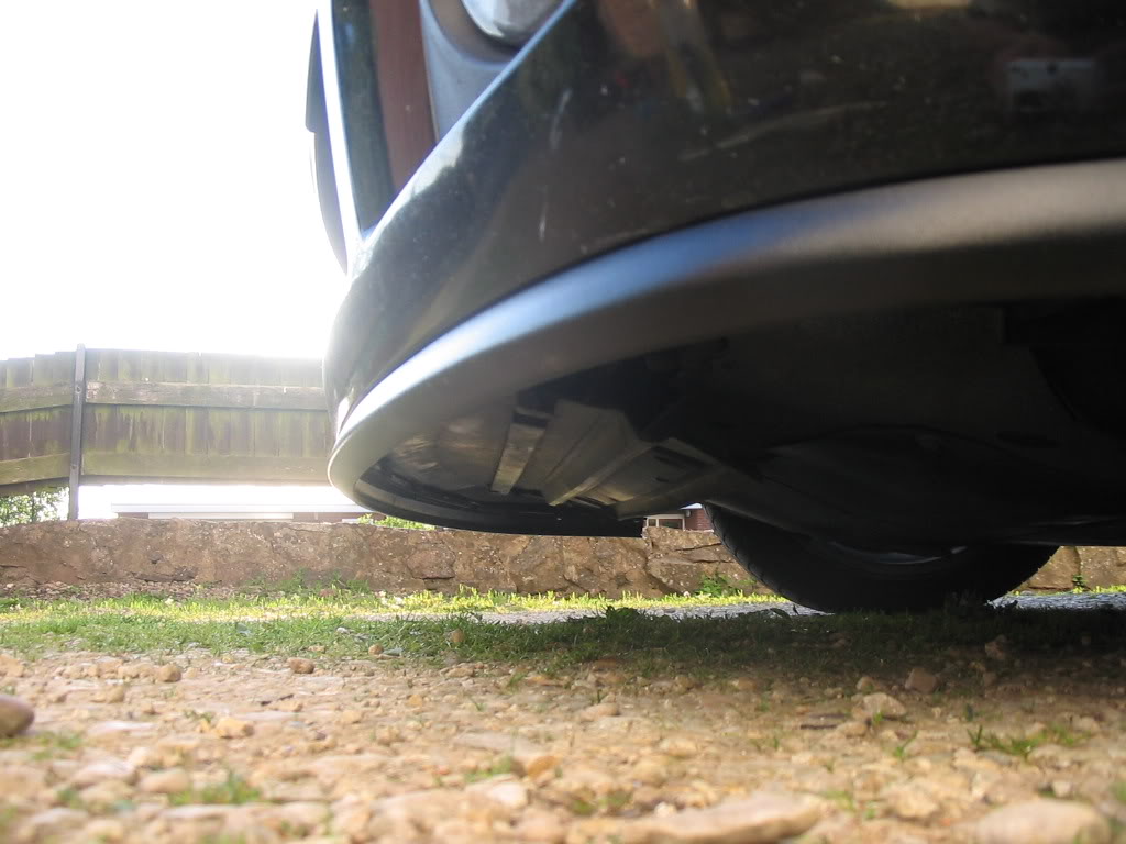

It could be fitted slightly better in places, but thats down to me, its got a million screws in it holding it on so it aint going no where! lol
Finally got my brain sorted!!!
:rasp:
looks a million times better with a cup splitter.
whats the best method of puttin them onto the bumper?
Renault suppply it with 8 self tappers, but pop rivets are the best bet. That's how mine is held on.
Firstly make sure have the thing the right way up, i fell at this hurdle!
I tie wrapped it into place
drilled a pilot hole through the splitter and bottom lip of the bumper
tacked it into place with the 8 self tappers and numerous other screws
finally securely screwed into place.
Their quite easy to do, the hardest part is lying on your back fitting the screws.

Also, if you've got it up on ramps, put a brick on the bottom bit, as I nearly ripped off my newly fitted splitter because it was catching on the bottom of the ramps!!!
