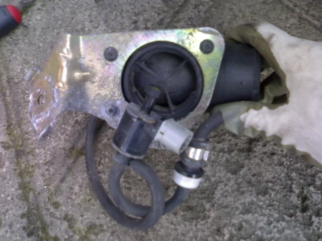

first, i took all this out
[pic at bottom] i'm guessing thats right? acoustic valve and gubbins?

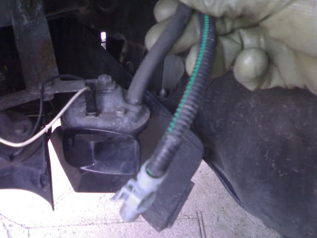

then i was left with 2 leads. the black one i blocked with a screw.
whats the other electrical one with the green stripe? hoping i dont need it!

and cover the electrical wire that isn't being used with tape.

Whats that thing for anywayz?
the acoustic valve is supposed to open up at certain revs supplying air to the filter - it stays closed at lower revs to give better torque apparently - I dont understand the principal though but makes sense to me removing it

Daze, what did you have to do to remove that accoustic valve thing anyway? When fitting my viper it looked like I had to remove the front bumper or something to get to it!
I think it has something to do with the inlet/hose lengths at different engine speeds
Remember to plug the hose up to this valve neat the throttle body.
remove nearside front wheel, then remove the arch liner and you see it.
one bolt to undo to get it off [the horn also comes off but just re-attach it]
be carefull with the plastic plugs that hold the arch liner in, i broke them pulling them out :)
