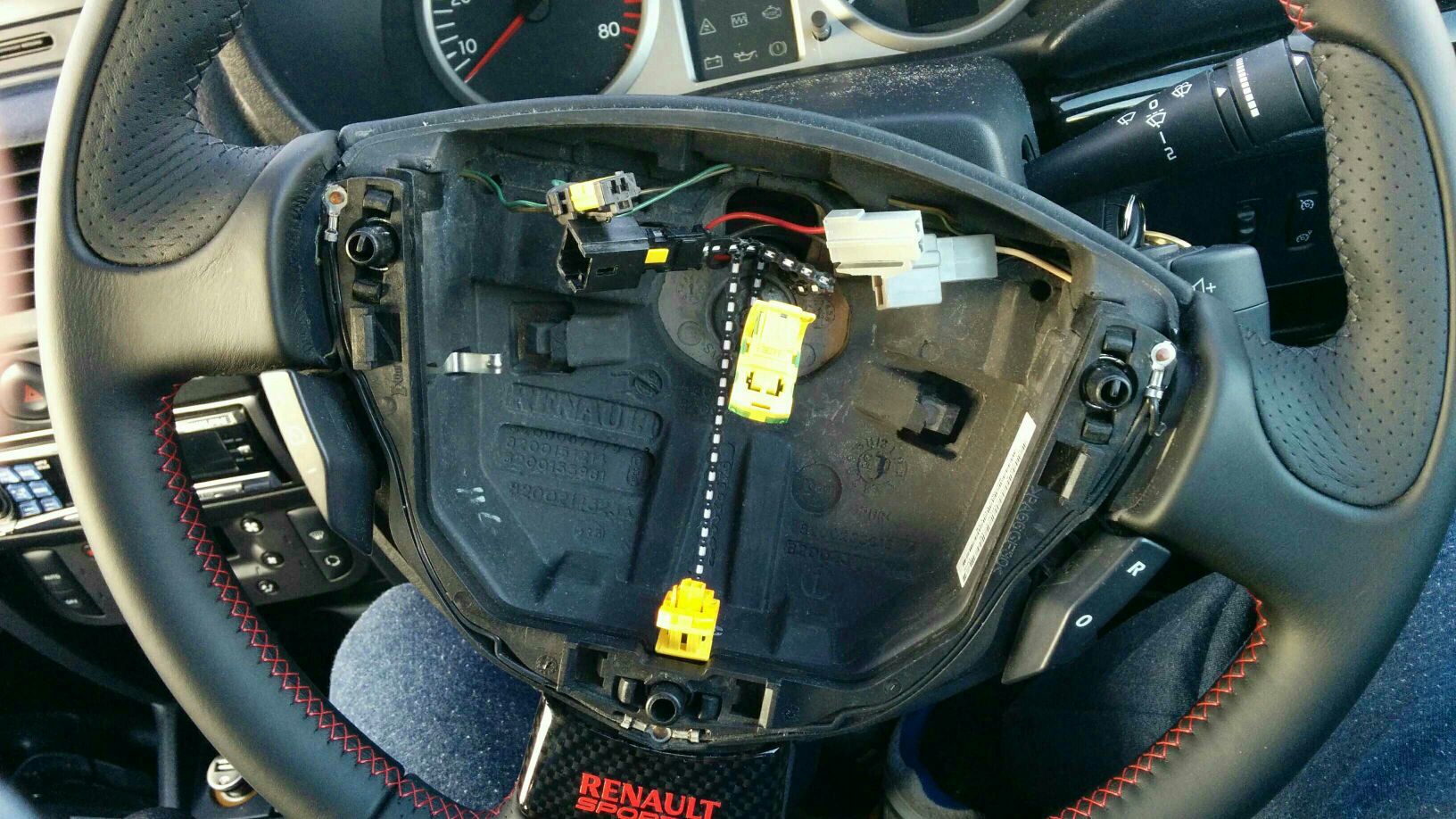

Buttons aren't working after several restarts of the car so starting now to take the airbag off to examine the connections

Can't see any obvious damage to plugs so putting my original wheel back on to test it's buttons
it wouldn't be obvious as the wire could have snapped and pulled away 1mm. Check the squib is working by putting a multimeter between the pins on the back of the squib (top 2) and the pins in the CC plug.
Don't have a multimeter unfortunately! If it comes down to it the car is going to the mechanics in a few weeks to get a few things done so can get him to check it out with the multimeter

Shortly after my buttons worked again they have stopped. I've got a multimeter now so I'll check the connections behind the airbag.

Checked the cruise control plug with my multimeter and its working.
Looks like the car is going to need plugged into Clip to see whats up :confused:
