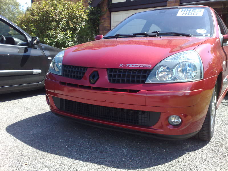

Right, this was not on my car. My mate went down to Renault a couple of weeks ago and ordered an RS lower grille thinking he would be able to fit it without a problem... however, as many of you know will know; its not that simple!
Completely different shape, clip spacing, curve of bumper etc etc...
Anyway after a whole days work and much trial and error we managed to get it to fit quite nicely!
I think it looks pretty good, only have one pic for now, will try and get some more to show how it fits...
Comments welcome
Cheers
Looks alright actually, how much was it? I just got the grille and fog surrounds for £31 so it'd better not be any more than that :(
  Coiley'd Clio PH2
I think the lower Grille was £40 from renault...
COBHC, what did you get them for? Im guessing you bought a sport front bumper?
Yeah, both off eBay. Grille and fogs were brand new but I had no idea how much they were from Renault, so that's a relief. :)

Really like it, as said looks like a mini megane ph1 225 witht eh fog lights bulging out of the bumper. Well done!!

wasnt sure whether you guys on here would like it but the comment so far are really good, cheers.
Well, we had to do a bit of cutting to get the grille to fit as there are little flanges on it, then we had cut slots in it so that it would clip into the bumpers clips.
Then, obviously there was 2 large gaps either side of the grille... so we searched all over (The House, Halfords, B&Q) until we came across some old video cassette cases that had a textured black plastic look to them which was almost identical to the renault grille plastic.
We then cut this down and made up two good fitting plastic covers, these were then glued to the grille and the whole thing was attached to the bumper with the clips. Any small gaps or holes left over were then sealed with black silicone sealant.
Job done.
Coby.

Looks really really good..... I'm surprised no company has not already produced some thing like this

looks good. the top rs grill now matches. dont like the rs grill on non-sports myself, but that works now.

weres the Hole to fit a Tow Ring Tho ??
looks good, just been arguin with Dajones sayin it cant be done etc,:eek:My bad

which bumper did this have originally , the newer mk 2 one or the older ? this looks awesome imo .
Its the newer one mate, cheers for the comment.
Looks good bud :)
And loose the square plate in the window :S
If your gonna run without a front plate on your bumper get a standard one and attach it to the outside of your pasengers side sun visor like so on the white Mk5 Golf Gti in background.
Then its on show through window when visor is down.
