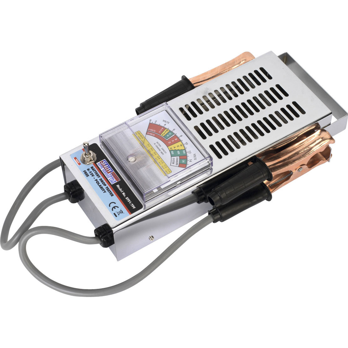

a drop test, not heard of one but have an inkling and google is my friend. some stuff i've looked at reels off a list of different tests.
for testing cranking power, should i just disable the system and then let it crank for 15 seconds and see what voltage i get? or am i going in wrong direction?
what's the best way to disable the system? i thought pull the plug on the coilpack, but i guess this would still flood the engine. fuse for fuel pump then?
been scanning this:
http://www.aa1car.com/library/voltage_drop_testing.htm
a drop tester applys a current draw load to simulate the load a starter motor would put on the battery, then tells you if it's healthy.
