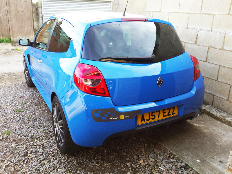

Right where were we? I had bought myself a lovely little R27 and driven the nuts off of it around the Welsh Valleys for 3 days. All in all a great success. Unfortunately I then had to go back to work, which always puts a downer on proceedings.
For the next few weeks I drove it alongside my Rallye, up and down the A419 to work and back (a 30mile round trip) and was amazed at just how similar they were. Obviously the Clio was a far more comfortable place to be thanks to the awesome seats and the climate control, exactly the reason I bought it, but in handling and performance terms there was very little to choose between them. A huge testament to the 306 when you consider it was 8 years the Renault’s senior, and wore nearly three times the mileage. Eventually I decided I needed to pull my finger out and let the Peugeot find a new home, a car that good deserved to be driven, and I found myself grabbing the keys to its younger brother 9 times out of 10 when leaving the house. I advertised it on Pistonheads and it was viewed, paid for and collected within two days. Can’t ask any more than that! I did find a brief moment to snap one final photo of it alongside the Clio and my girlfriends (frankly awful) Corsa. I’d love to say it will be missed, but to be honest all the desirable qualities of it are mirrored, or improved upon, by its replacement, so I would be lying! Still, it was great fun whilst it lasted.
So it was time to get stuck into the Clio, and the first thing on the list was to get rid of the horrific blue interior lights. Not only were they not at all to my taste, but their light output was simply dismal. Therefore out they came (all 9 of them!) to be replaced by bright white LED alternatives. Much better. I celebrated by dropping into my mates unit for a bit of a cleaning session, as they all prepped their cars for the annual Retro Rides show. It looked a bit out of place mixing it with this gang of ancient tin, but that just succeeded in motivating me further to crack on with the Husky project.

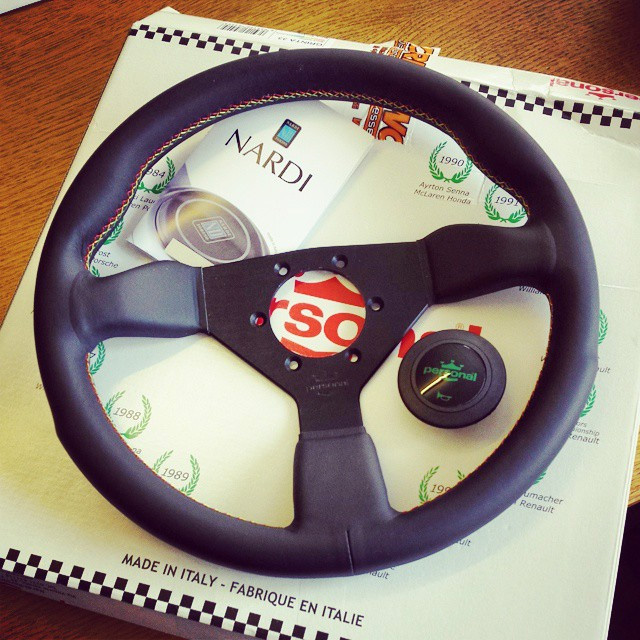

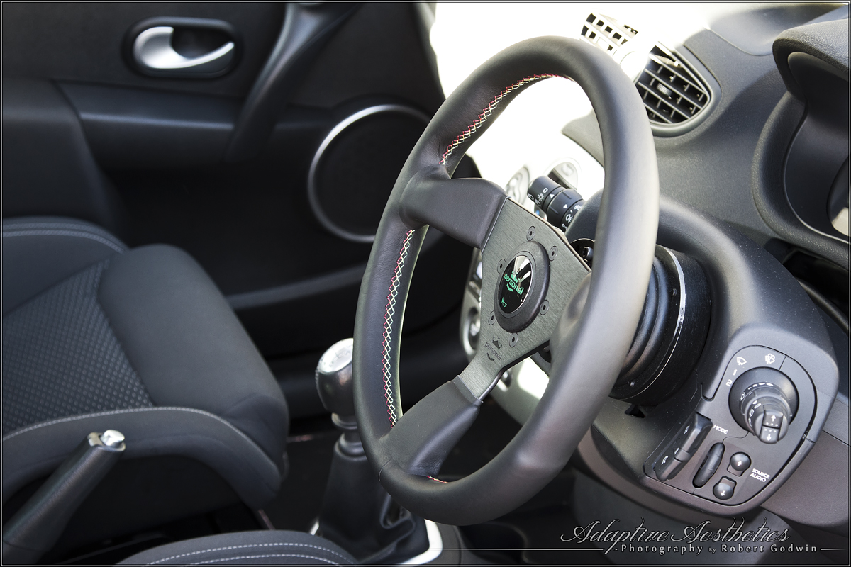

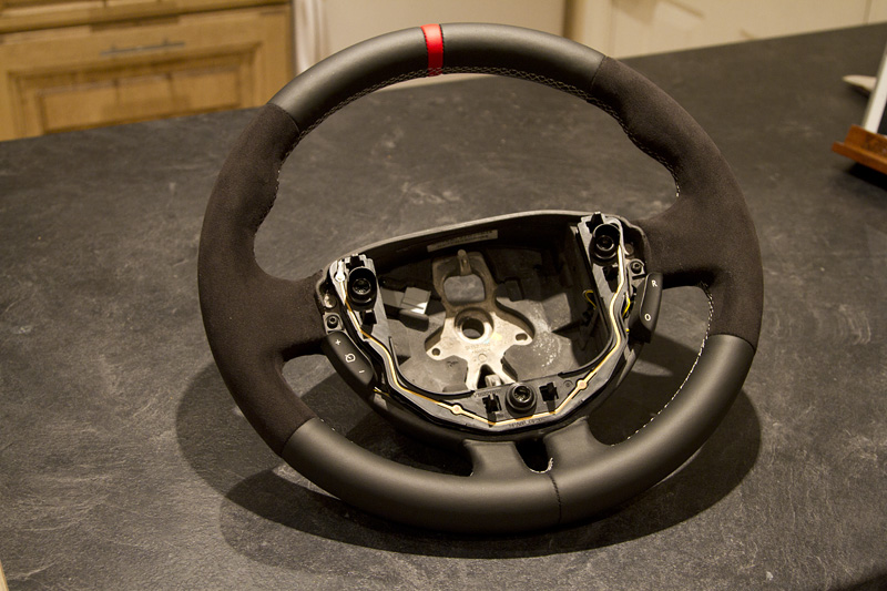

Next on the list was the steering wheel. The previous owner had fitted a suede 300mm Oreca number, atop an awful China-spec snap off boss. The wheel itself was acceptable on track and tight B-Road’s, giving some excellent feedback and response, but everywhere else, especially motorways and dualys, it made the car far too fidgety and snappy. The aforementioned boss was even worse, it had way too much play, knocking and banging around the show like an inebriated uncle at a wedding. They both had to disappear.
Fortunately the stock wheel was included when I bought the car, but it was badly melted, so I decided to dig it out and send it off to Royal Steering Wheels for a refurb. After much deliberation and to-ing and fro-ing with owner Jack, I settled on black Alcantara sides with Nappa leather top and bottom, held together with silver stitching and a red TDC band. He turned it around inside 2 weeks, including return postage, which I thought was very impressive. The quality of the workmanship was also excellent and the Alcantara was ridiculously nice. I did have a couple of very minor niggles with it but I can be an infuriating perfectionist at times.
I whipped the Oreca off, followed by the boss kit, to fit the freshly trimmed replacement... Except it quickly transpired that when it was originally removed it was done so using a machete and hammer. The clock spring was destroyed. My bargainous wheel swap had swiftly got a whole lot more expensive. In any case I could at least trial fit it, sans airbag and cruise control, to see if I liked it. Which I didn’t! Well that’s not really fair, the wheel itself was most agreeable, a lot comfier to operate than its predecessor, and caressing the Alcantara around the thumb drips was simply glorious. But it was just a little too far away and a little too large. I went for a short blast taking in some local twisty bits and, there was no getting around the fact, the car felt much, much worse. Balls. So back off it came and into the classifieds. I needed to find a happy middle ground, so I went on the hunt for another aftermarket option. I shall continue this saga a bit later!

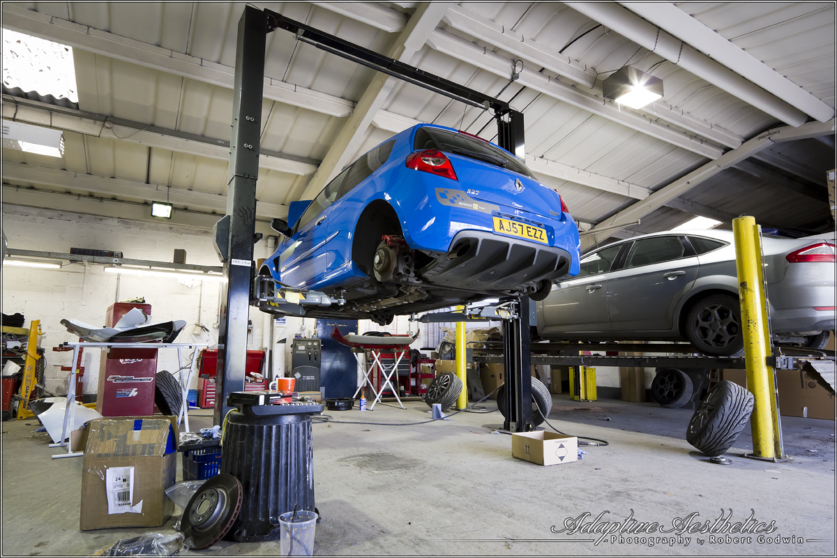

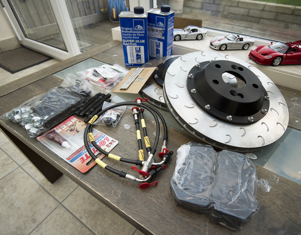

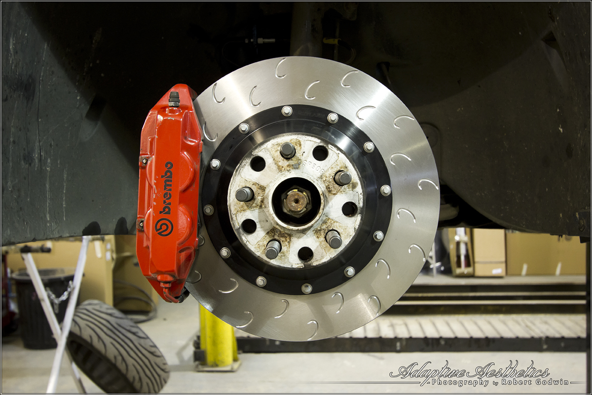

Seeing as I had cooked my brakes at Combe (including possibly warping the discs) I felt inclined to upgrade. It wasn’t as though the brakes weren’t good enough, in fact they were more than adequate at both tracks, I just wanted them to be even better! Firstly, if I had to replace them anyway it made sense to upgrade now and get a good amount of use out of them - I have been known to spend serious money on cars just to sell them soon after. Secondly, braking was one thing I was never happy with on my last build, I kind of neglected it over everything else, and although I was running a half-decent setup they just weren’t up to the same standard as the rest of the car. I wasn’t going to make that mistake again!
So Cazan were called into action again, providing me with a pair of their incredible 330mm two piece discs, a set of Ferrodo DS2500 pads and a quartet of Goodridge braided hoses. Eurocarparts supplied a couple of bottles of ATE superblue fluid, Renault a fresh set of bleed nipples, and “Mr. Pink” completed the party with a set of uprated retaining pins. And here is the proof:
I managed to blag a 2-post ramp to get all these goodies fitted which made things a lot quicker and easier. In fact everything went very smoothly. It’s quite nice working on a new(ish) car where all the bolts aren’t seized and covered in 5mm of rust!
Out with the old…
And in with the new…
We flushed the system with the new ATE fluid which was easy enough, barely any air was let in whilst changing the lines which was a relief, and left the pedal lovely and firm. I was expecting them to be a bit “fluffy” for the first few miles, as with every other set of new pads I have ever fitted, but much to my surprise they felt fine straight off the button. I ran them gently for the first 200 odd miles (slightly longer than usual as it was mainly dual carriage ways) and then ran them through a savage heat cycle to bed them in properly. They are now outrageous. Whenever I’ve been driving another car and get back in the Clio, I find it hard not to head-butt the windscreen the first time I hit the anchors. I just can’t wait to put them through their paces on track now.

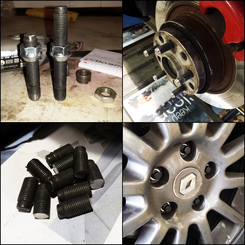

Eagle eye’d of you may have noticed in the last picture above, the K-Tec 19mm spacers which came with the car. These give it a much wider and more purposeful stance which I don’t think I could reverse now, I believe they look a little under-wheeled as standard. The 225 section tyres also add to the aggressive quality. However I soon discovered the difficulties of lining everything up when refitting the wheels. Bolts are a pain in the poo-shoot at the best of times, but add in another set of holes which find it absolutely hilarious to fractionally rotate at the last moment, and you are soon throwing torque wrenches around the garage with rage. Therefore I decided a stud conversion kit would be a great idea, again you may have spotted these in the last image, although this was a saga in itself.
I popped an email across to K-Tec enquiring about their kits and what would be best to use. They replied promptly advising that I should use the 100mm length studs as they are perfect for use with their 19mm spacers, and I duly ordered them up. I fitted them at the same time as the brakes but was shocked at just how long they were, on refitting the wheels they protruded a good 30mm from the ends of the nuts! Not only did this look a bit rubbish, they were in a prime position for ripping open some poor buggers calf (most likely mine), and my deep 19mm socket only just reached the nuts to torque them up. Not ideal in any way shape or form.
I sent another email to K-Tec expressing my feelings, along with a couple of photos, but this time had no reply. After a few days I got bored of waiting and instead got on the blower. The guy who answered seemed nice enough and said he needed to discuss it with his manager who wasn’t available, but would ring me back asap. This didn’t happen. I had to call them back at the end of the day and spoke to the same chap, who again seemed relatively amiable, but refused to do anything for me as I had fitted the studs and also stated they had never had any complaints before, which I find very surprising. I wasn’t a happy bunny so persisted a little and he agreed he would pass on some additional discount on my next purchase. I gave in at this point as I could tell I was banging my head against a brick wall. I did ask if they could supply me with one additional stud (as I had cross-threaded one slightly) which he said he could, and would charge it to the same card as before. A bit petty given what he had just said about discount but it would only be about £1.50 so whatever… oh except they also charged me £4 for postage! For one wheel stud! Unbelievable.
Needless to say my first experience with this company may well be my last, unfortunate for them as my next purchases were liable to be a rather more expensive than a £90 set of fasteners.
In any case I wasn’t about to leave the studs as they were, so had to get a bit a bit innovative and engineer them down myself. A lathe would have been ideal for this, and luckily I do have access to one if needed, but as they were fitted already this was not an option. Therefore out came the die grinder and the Dremel! I took 30mm off the rear studs and 25mm off of the fronts (which sit slightly further in due to threading into the hub and not the disc), sanded a further 5mm off the threads to create the all-important bullet tips, and splashed on a bit of etch primer and satin black to stop them corroding. This was not a quick job, in fact it took fapping ages, but was well worth it.

A limited run Personal Neo Grinta Kingston Edition, 330mm in diameter, leather trimmed, with Rasta-spec tri-colour stitching. Lovely stuff. I teamed this with a 40mm black anodised spacer from Netherlands-based company FullCarTuning, as I could find nothing in this size in the UK at all! I am happy to say this setup is absolutely bang on now, close enough to be comfortable even when harnessed in, with the stalks still in easy reach, and small enough for that “go-kart” feeling yet large enough for lazy straight line cruising. Smug face initiated. All I need to do now is get the cruise control switches retro-fitted, but to do that I need to obtain a non-butchered clock spring, which is proving a little illusive.

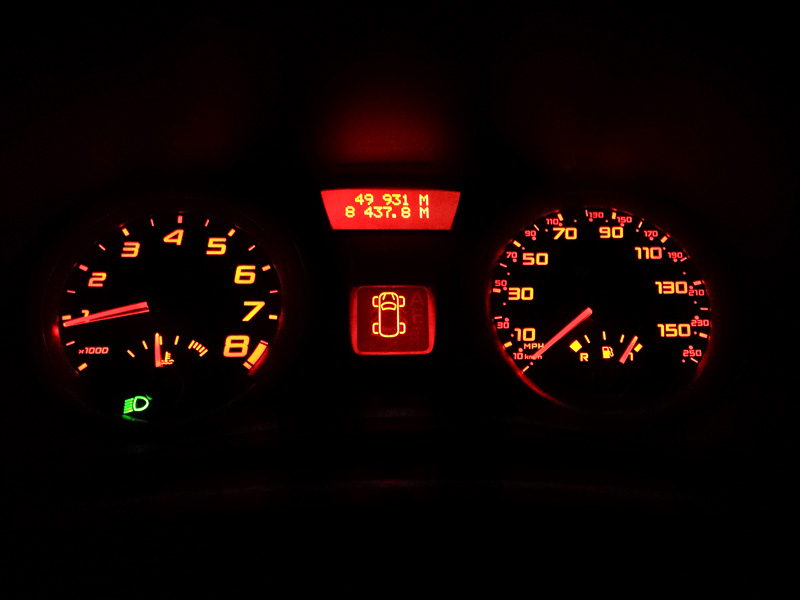

First off, you may remember my tale of woe regarding the airbag clock spring, which had previously been butchered by a would-be Edward Scissorhands, leaving a permanent warning lamp on the dash and inoperative cruise control. Well, when I was first searching for a new one I had set up a saved search on the good old Bay of E’s with the part number of the bit that I required, and then immediately forgotten about it. A good few weeks later I was reminded when an email dropped into my inbox saying one had just been listed. Moreover it was an absolute steal at approximately half the price of the ones I had seen previously. The big bad “Buy It Now” button was clicked without delay, and two days later it arrived on my desk.
Fitting it was pretty straight forward fortunately, although looking at this mess half way through was just a touch scary!
Once it was all thrown back together, and I nervously re-connected the battery and hit the start button, not only did nothing explode in my face, but I was greeted by a lovely warning free set of dials!
However, a short couple of days later, those same dials did deliver me a somewhat depressing message – my relatively low mileage R27 had now ticked its way into the big five-o’s. Is it just me or does this number somehow seem a far scarier prospect than the mid-to-late 40’s? Still, it has certainly covered a lot less tarmac than every one of my previously owned cars, so I really shouldn’t grumble!
Anyway, the fitment of the new clock spring assembly finally allowed me to connect up the cruise control switches which I had retained from the OEM wheel, but first I needed to fabricate a bracket. And here it is; from initial prototype, through dodgy aluminium test piece, to finished and painted article on the bottom right. It fits like a glove! I can now smash down the motorway at 70mph whilst getting all Michael Flatley on the dashboard, or at least I probably could after a few years of intensive yoga training.
