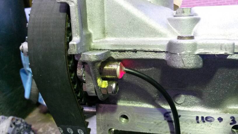

Here is mine. Replaced all but 1 of the VVT bolts with stainless. Works perfectly although would not want a sensor failure. Next one I'll probably put a boss mounted one so I can replace. Have seen the same but mounted from the engine mount side welded into the cover. Have also seen them on the gearbox end of the camshaft where the seal is. Good luck!

Hey, I’m new on here, just bought a 182 project car and going to fit an aftermarket ECU. This mod is just what I need so go sequential injection, I’m doing the belts and dephaser this week so I’ll get some SS bolts orderd. Can you remember what size bolts you used?

Nice one. I can't recall I'm sorry but the are just the size that is in the dephaser maybe M6 fine. I can't recall the heads on the dephaser bolts but I had to grind slots in them to get them out. On my latest car I am going to mount from the other side (ie the engine mount side) - may be able to space just one bolt out 5-10mm and leave the rest to avoid having to remove them all (I'm using vernier pulleys so will be a little easier).

Ok, my new dephaser just arrived, I see what you mean about the bolt heads.. might need to go in via the cam cover side as you mentioned.
