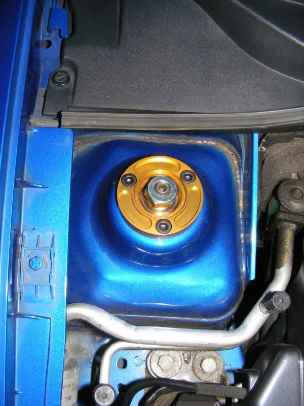

You need a drill bit the same size as the bolts 8mm iirc
Here's a picture of mine fitted

Thanks both, so the best thing to do would be to use the top cap as a template then drill the holes? It's usually the simple jobs that end up being the hardest!
