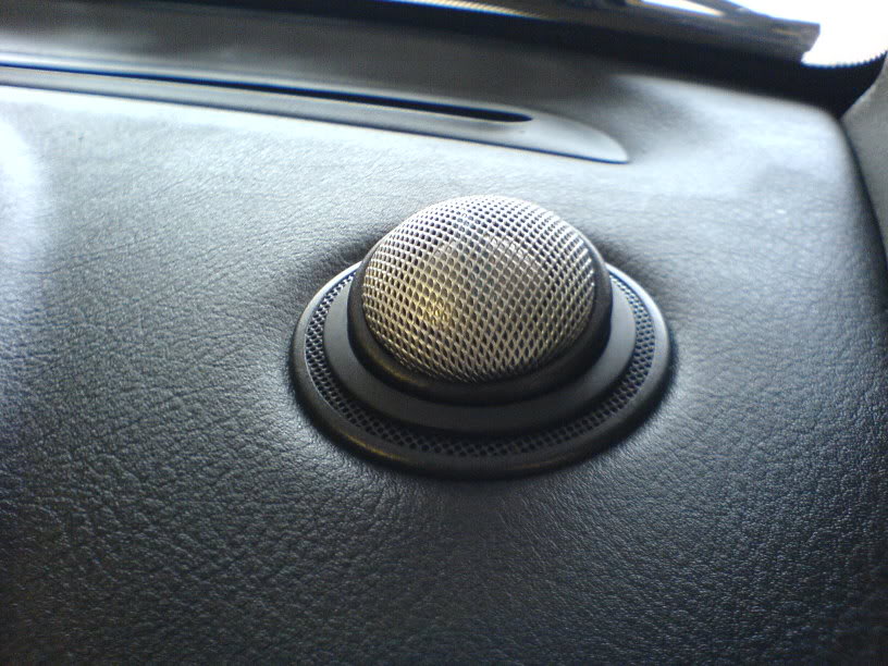

I've nearly got the dash out of my car, Its catching where the passenger airbag is though.
Ive got some components and wanted to fit them without an amp. On the crossovers just wondering where its best to cut the wires to connect them?
no need to remove the dash, why dont you fit the tweeter to the door card, and leave the stock tweeter in place, the replacement one will sound better being run from the crossover. to power the cross over just cut the connector off the door speaker and run a cable from that to your crossover, which if your lucky will sit behind the doorcard. The run cables from the crossover to the tweeter and woofer (everything being contained on the doorcard)
I took the dash off in the end, and got a friend to fit the crossovers in for me, the rest was quite easy. Sounds so much better i reccommend anyone to upgrade their speakers!
