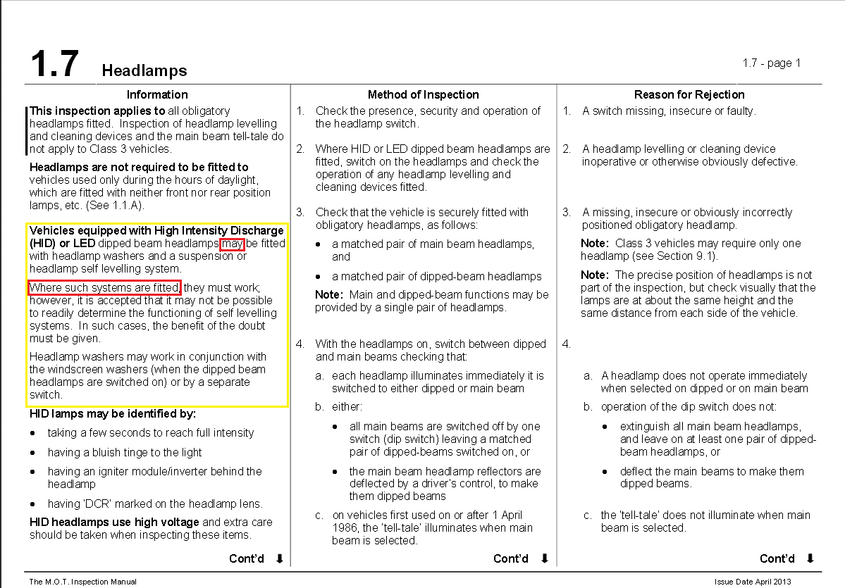

One was knocked off so have bought a replacement. I read on another thread that cars with HIDs won't pass MOT without headlamp washers otherwise I would have opted to blank them.
Never failed an MOT in 6 years of them not wrorking
Reason for rejection #2
I know that mate, i wasnt disagreeing that it should be a fail. Im just stating that in 6 years not one garage has failed me for them....
