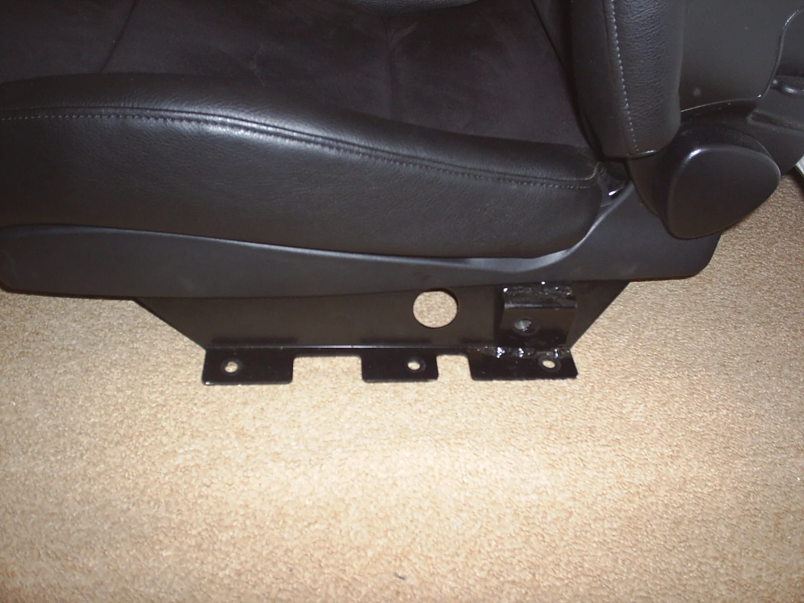

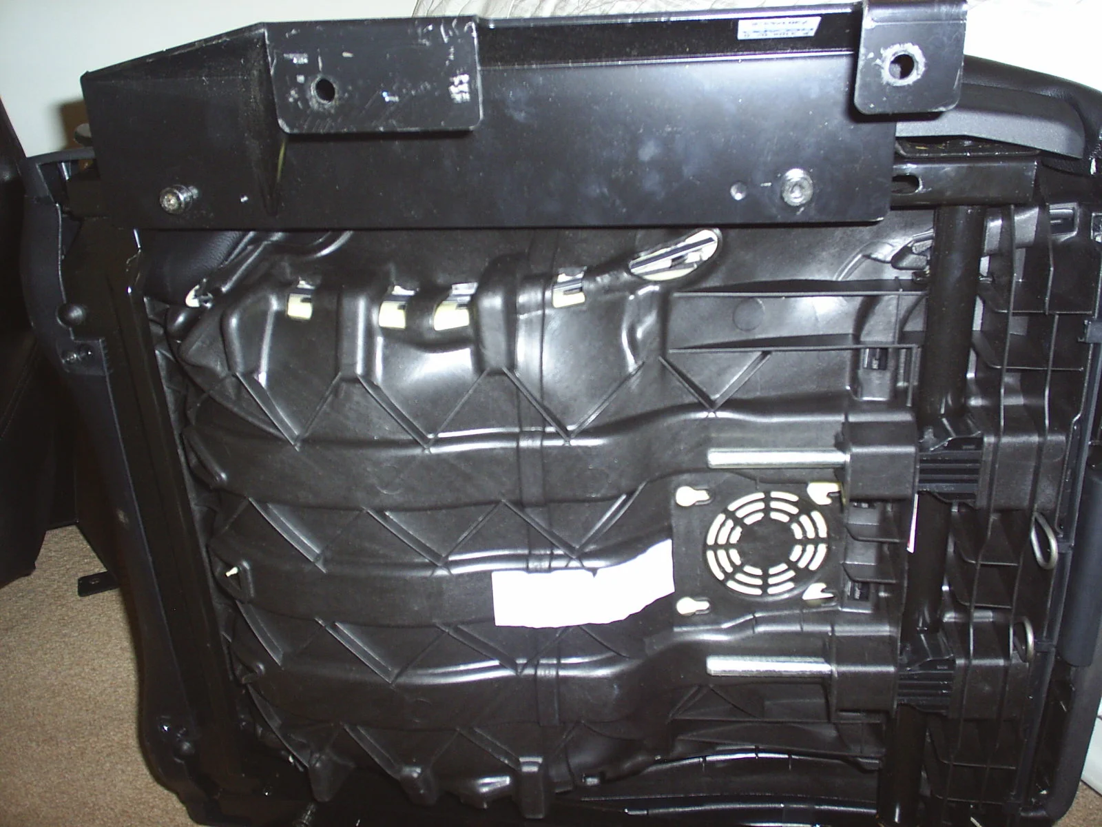

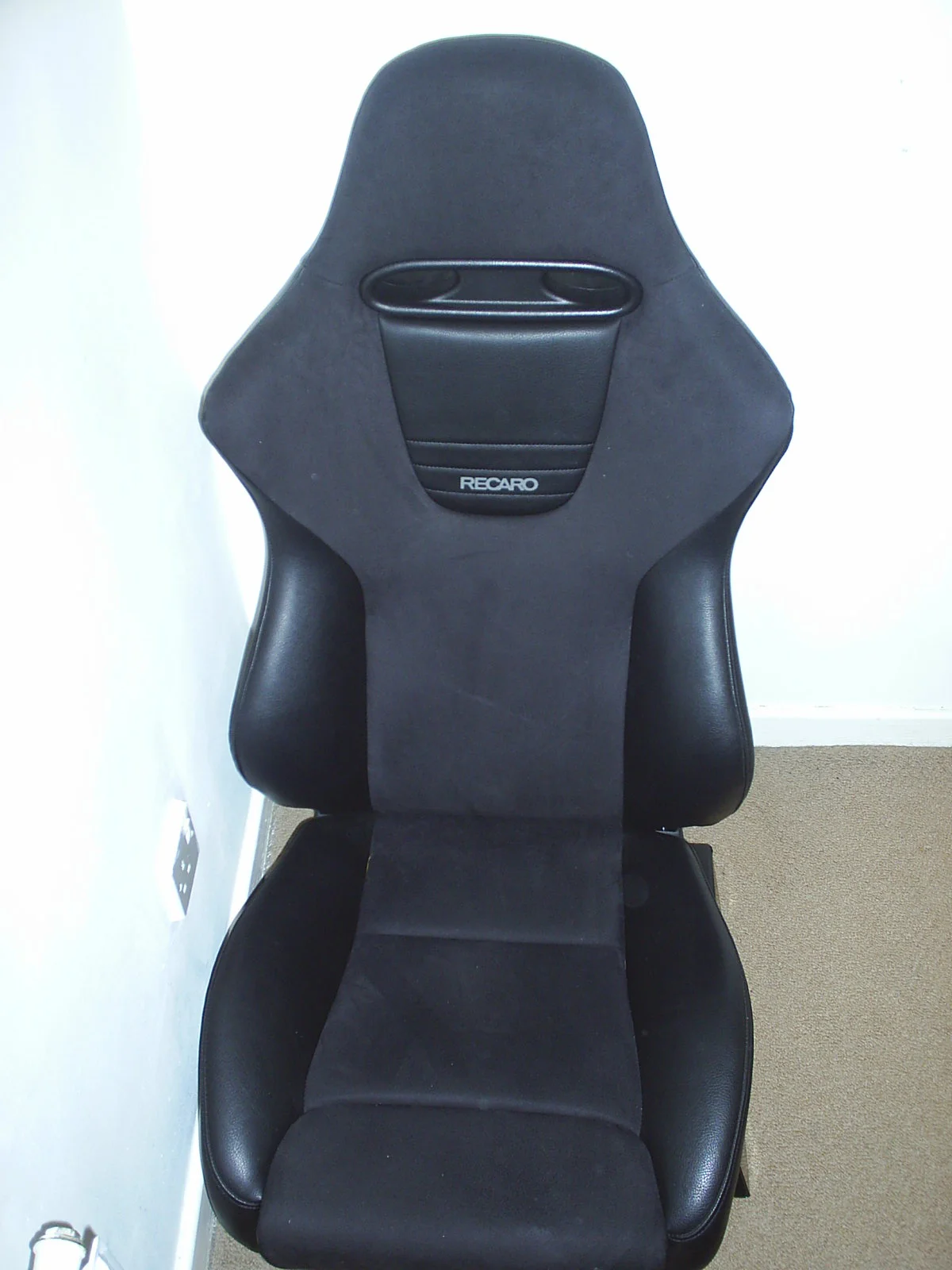

Please can you take a look at the following pictures.
Picked up these seats, don't appear to be the original Trophy items(?) but did just come out of a 172 so those frames are correct...
With the existing 172 seats the former owner told me to reuse those bolts which hold it in currently, but I thought they were part of the subframe and attached to the standard seat? Do they come out or do I need new bolts. I don't doubt the previous owner but was puzzled by what they said.

Right mate first of all dont use mapelin for resistors they are sh*te get on the blower to capital seating and ask them for some universal airbag resistors i think they were £10 each i've had no problem's with myne.
Get some pics of the side of the sub frame up ???

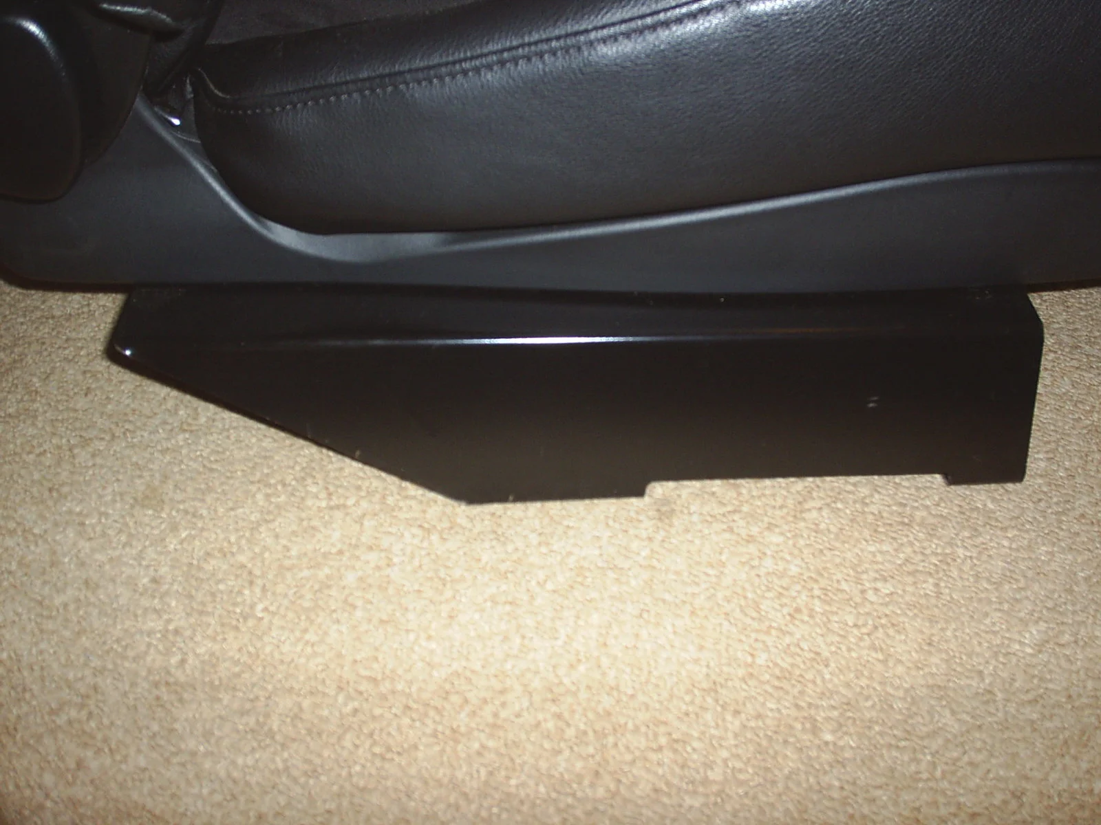

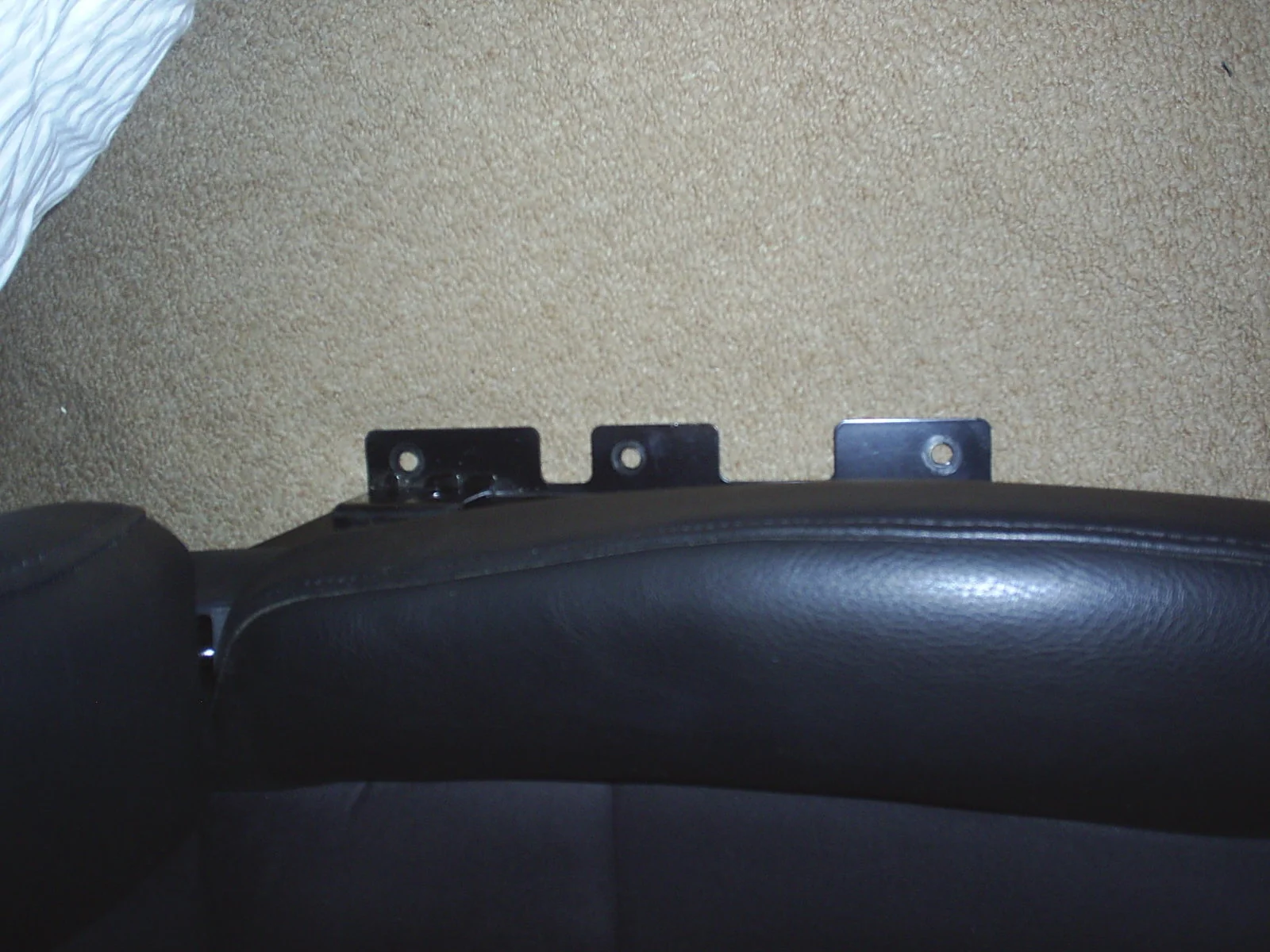

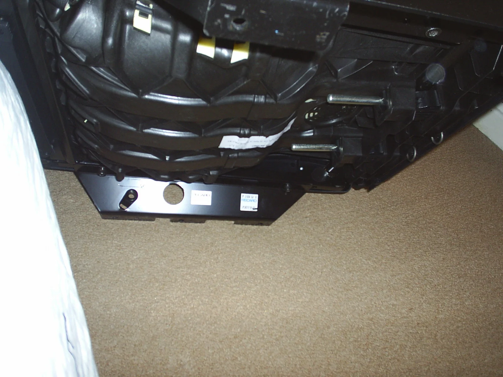

Further to the above, more pics.
It seems actually upon looking more closley that these seats are infact on the rails and will slide within the the seat so itself should just bolt to the car which is correct.
However, I still wonder about the bolts..... What bolts go through the seat frames into the car? Can these be removed from the existing seat as what you see is what I have for them.

If they are on the frames mate it should just be a case of undoing the ones that are currently in your car and using the same bolts the attach the recaros.

Yeah, that wasn't the question I was getting at. When you remove the existing seats they are on a frame. Of which there are four bolts which go into the car... Those 4 bolts appear to me, to be attached to that seat subframe and can not be removed. What I am asking is am I wrong? Do the bolts which are on the existing seats detach and can be used on the new Recaro ones of mine?
  alien green rs133
one ones in the exsisting 172 seats are welded on.
it appears to me that the "runners" on the bottom of the 172 seat needs to be removed ( can be seen when you remove plastic side covers on 172 seats) and then bolted onto bottom of recaros and fastened to car.

Think it's worth mentioning, when you take off the runners try not to let them slide out of place, as sometimes they will just lock up completely.
