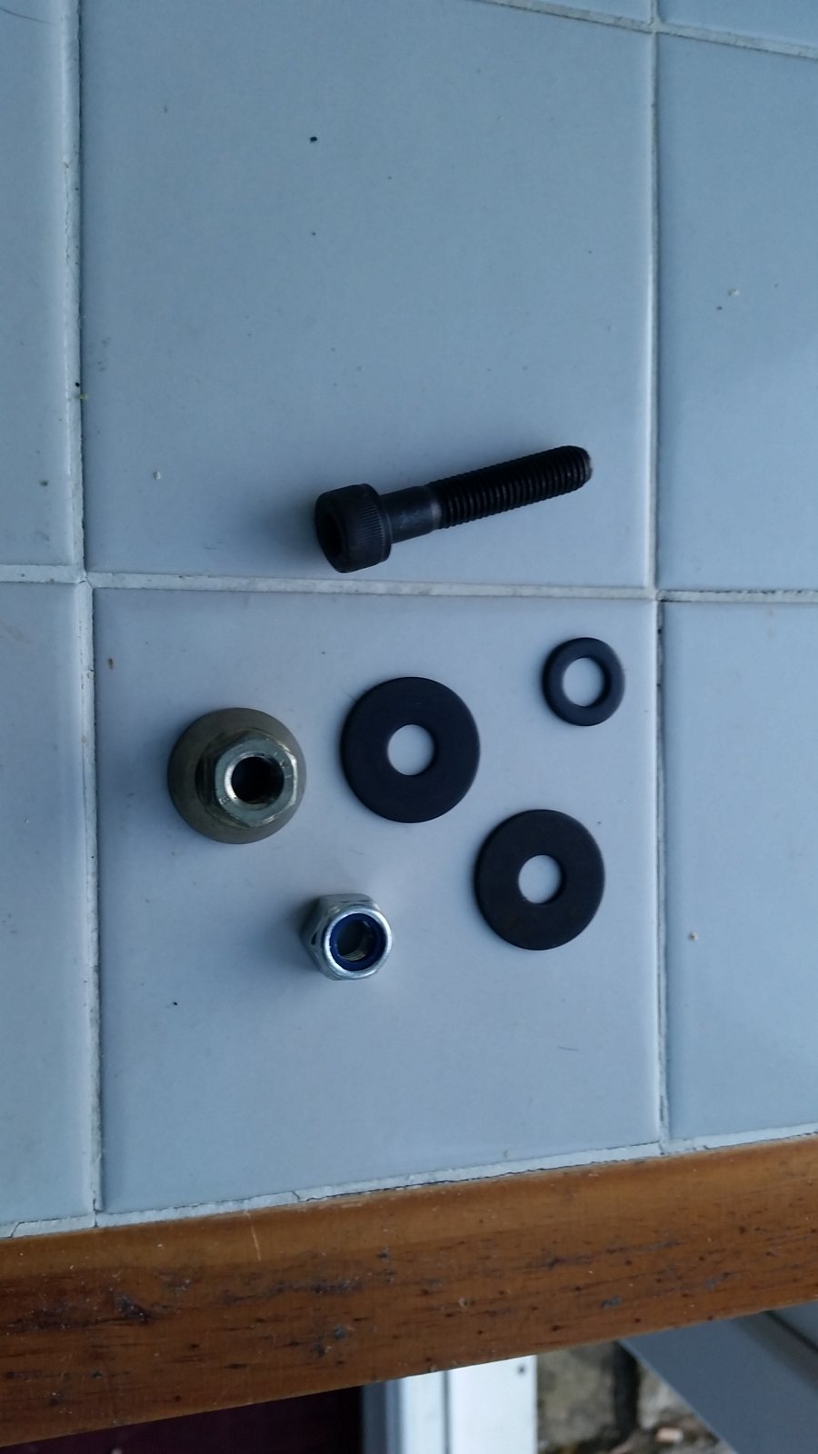

From memory mine are as follows
M8 x 40 (I think)12.9 high tensile cap head bolts x 4
M8 washers x 8
M8 penny/repair washers x 8
M8 nyloc nuts x 4

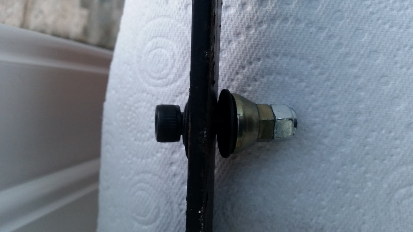

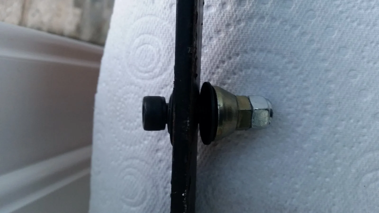

I also reused the original top hat nuts from the seats to double up underneath, also used one of each washer top and bottom.
I removed all the plastic spacers from the car floor as well, as a side note the omp subframes don't sit level, to correct this the inner side needs to be raised by approx 20mm I think so would need longer bolts if you go down that route. I didn't bother as my omp frame is only temporary until I go for a lower option
Jut like this
