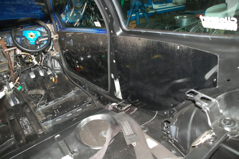

Has anyone got any pics of how/where their harnesses are mounted?
I mean close up pics, so i can see exactly how they are positioned.

Havnt got any pics mate, but used the normal place on both sides of the seats and used the same bolt that goes through the rear seat belts.
Normally best to go with the standard places as they are designed to with stand the impact etc.
i've drilled through the transmission tunnel bit, and put an eyelet there, for the right hand side, i used the metal bar that the original belt fastened to.

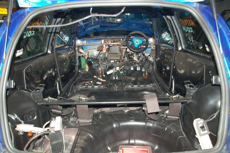

So should i Weld a Fat bar in between the rear suspension turrets and use that to mount them? would that be safer?
we weld in a bar between the rear shock turrets for the 2 should straps to attach to
for the lap belt we bolt it to where the oe lower belt bar (the bit the oe belt sides on at the bottom) once went, and with cobra seats they come with an eyelet (nearest the handbrake) for the other side of the belt to attach to

Do the rear turrets need any strengthening? And i've got a length of scaffold in my garage, can i use that?
NO!!!! get it done by a pro that can TIG weld and use a steel tube that is incredibly strong (we use a shape like this

to give you an idea
What if i use a solid rear strut brace and weld that in? My old OMP brace looked exatly the same as that!
