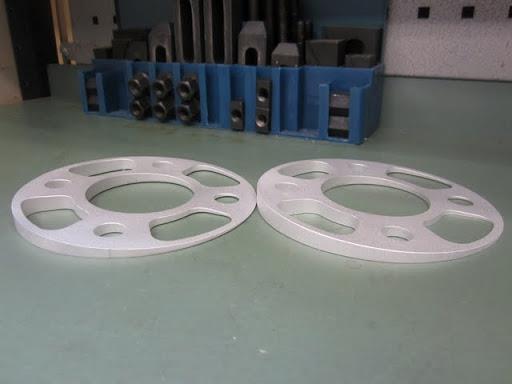

Fitting rear camber shims
Have you had the stub axles off before? If not the bolts will be old and ideally should replace them, pure do them as a pack, they're just high tensile countersunk though.
Take the dampers out for easier access as well. Unbolt the calipers so they can be prop'd up, as you might have to file down the surface between the shims.
Many thanks Zach, I got the shims and a set of new bolts from pure motorsport so should be all set.
Not taken the stub axles off before so will follow your advice and prepare for a good clean up

camber spacers are an easy fit.
just as well I decided to fit the shims, as in the process I found the offside wheel bearing is shot, and the thrust washer is missing, which is probably why the bearing is shot, and in fact is probably why the I went to fit the shims in the first place as the OSR camber read positive on the last alignment check, probably due to where the wobbly wheel settled on the rig, so probably don't need the shims anyway!

Thanks all, just got your PM Andy , I can get you sorted with the Renault rear discs and spacers washers, on the shelf so can have them Tuesday mate (y)

Just make sure you fit the spacers the right when round when fitting. There's a tapered side and a flat side. Tapered faces the stub axle and the bearing of the disc faces the flat
