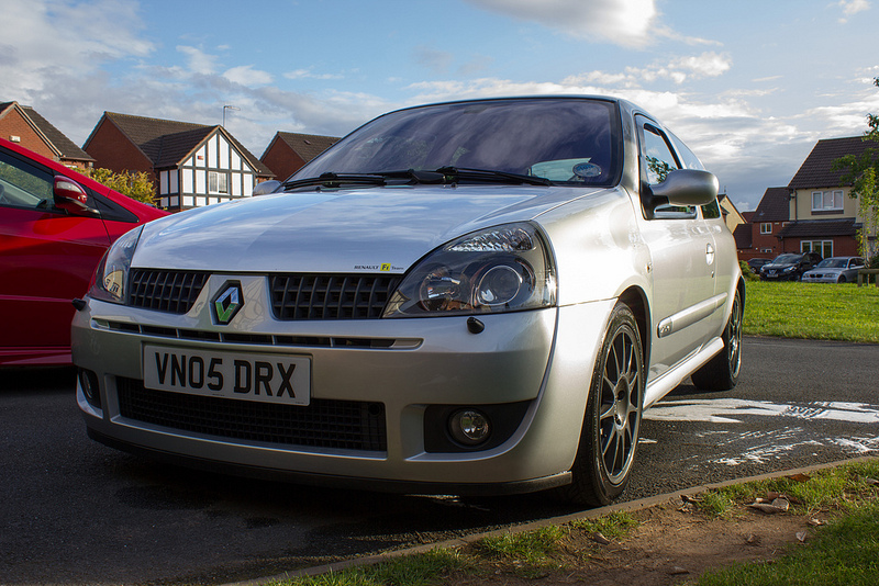

here's the pics: :)
finishes it off i think!
haha yea definitely cheap - i could never justify buying a renault or carbon fibre one just because that it looks like it's always been there!
also cleaned it today but didn't manage to get the EGP on (SRP done) as i thought it was going to rain! :(

Mate! The car looks quality! I def need one in my life! Was it a pig to fit? I've got that exact car but a year older! What colour is it? Solitude looks well good!

:) it's easy to fit to be honest, i didn't even have to raise the car up, take or bumper off or anything (as long as you have a smallish screwdriver!)
if anything it annoyed me how long it took to tap into the bumper, arm ache after 10 screws were in :p
now just to find a cheap cup spoiler and some anthracite alloys and ill be sorted :)
