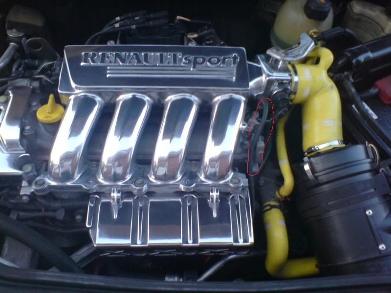

got a vacume gauge on order, just wondering if anyones fitted one. and where to connect the t peice. ive got a viper induction kit/samco fitted if that makes a difference.

is this wot i need to hook the vacume gauge upto?
Thats an early 172ph1 that has a vacuum feed running off the fuel rail, your ph2 wont have that pipe, i would have thought something like oil temp or oil pressure would be more useful....Im not sure what reading youd get...
If I'm thinking correctly, your vacumm gauge will work like a boost gauge on a turbo'd car. Apart from under any throttle pressure it will show 0, and off throttle it'll probably show a small amount of negative pressure. It will move directly from one to the other so you won't see much movement or improve your MPG.
You'd be better off with oil pressure/ temperature, voltage guage, or even a AFR if it's highly tuned. Something that will help you determine if your cars not running at it's best.
