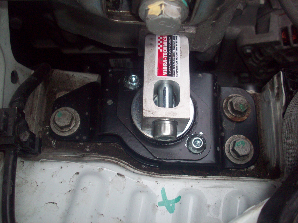

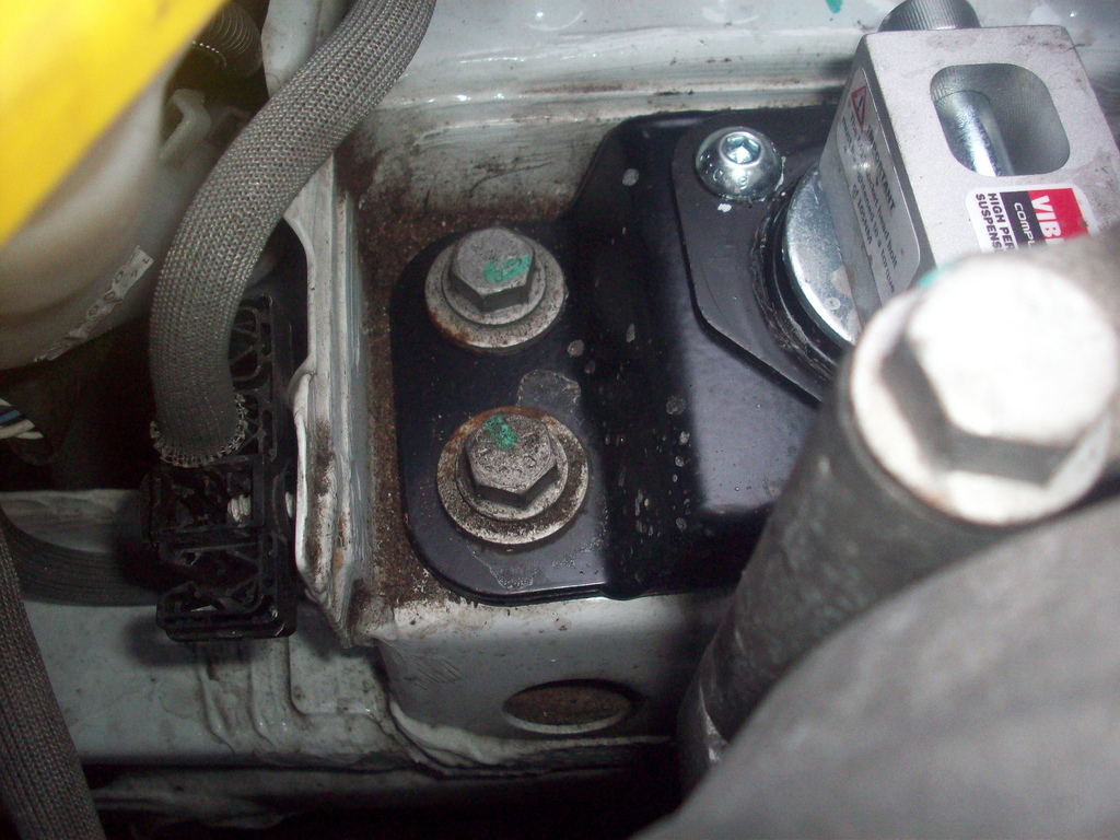

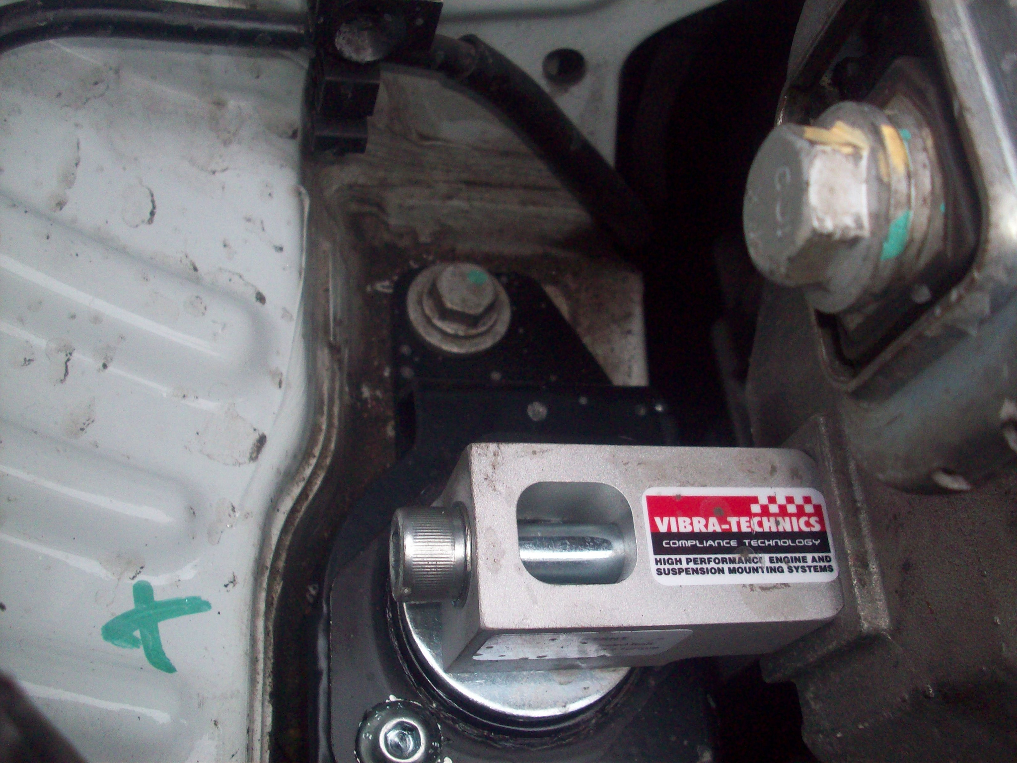

how much movement/alteration do you think there is with regards to the positioning of the engine?....i wouldn't have thought there would be that much as all the retaining bolts are a good fit in the holes in the mounts so not much adjustment to be had there,do you not just support the engine and centralise the mounts? the reason i ask is i had my vibra technics mounts fitted last week on my 197 and the exhaust tips stick ever so slightly further out of the diffuser now,theres no knocking though so hopefully all is well,interesting read though guys

Different subframe on the 197 so there is more room but still has the same type of top engine mount iirc ( drivers side) there is a good 10-15mm of movement when you slacken the four bolts that secure it to the inner wing and some slight movement on the gearbox mount on the 1*2's but I'm unsure on 197/200.

ah right cheers swede,took a couple of pics of my top engine mount this afternoon,thought it might help if they are similar
Vibra Technics Engine Mount by scott1532, on Flickr
