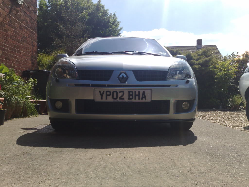

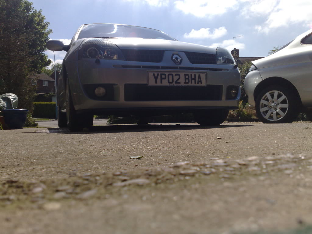

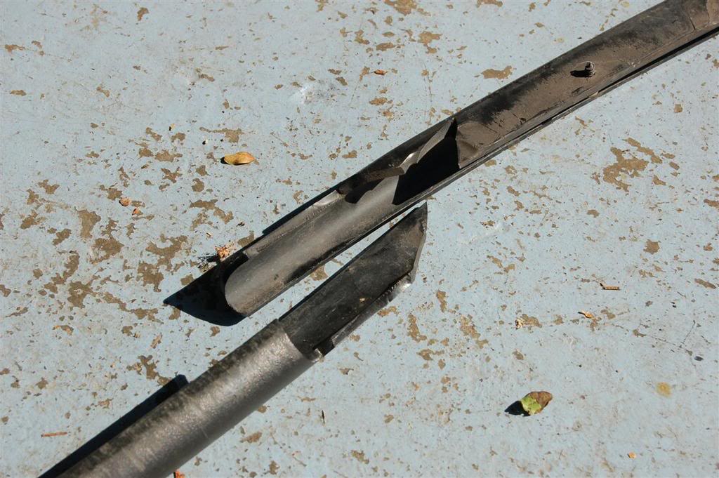

i bought the 2 piece splitter off D4ve and have a go at fixing it together today.
from this
to this

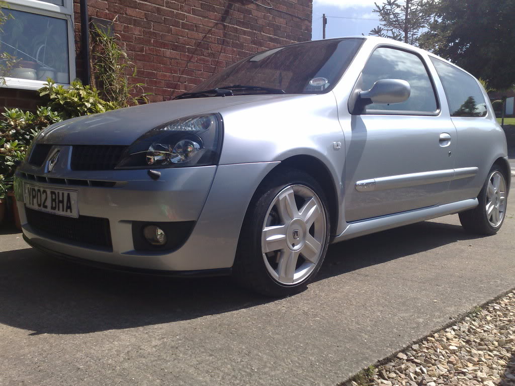

To finally this.
hope you like

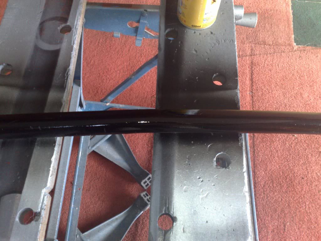

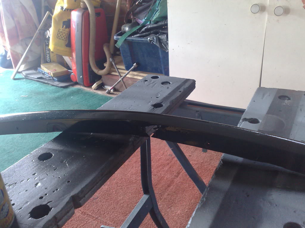

How did you put it back together ten?
Super glue to hold it in place while i headed up a screw driver and melted the plastic back to gether then i packed it full off filler to hold it. sanded it down and thats the result
Looks spot on dude.
I hope you have a heap of screws holding it on to keep it in place ?
How long did that take ya ?
Looks spot on dude.
yeah man there is 9 screws in it lol.
well i got it from the postoffice about 9:30 i had fixed the crack and filled it by half 10. washed it. 2 coats of paint. waited 2 hours for it to dry and fitted it. took about 10 min to fit. just used masking tape to hold it in place
